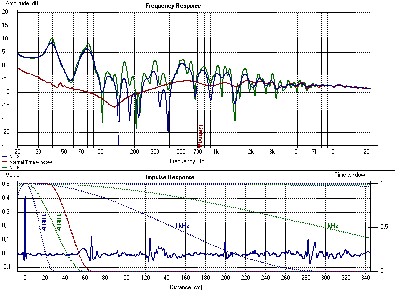

Well, FR-smoothing is IR-time windowing with a frequency dependent time-window. I have now implemented complex averaging, which is equivalent to FPPO (Fixed Point Per Octave) See the User Guide for the formulas I use.
The frequency dependent window is shown for each decade (10Hz, 100Hz, 1kHz, 10kHz)
I have attached an example.
This is only true in some situations, but not in general. If the system is minimum phase with no multi-path then what you say will work, but if these things are not true then the variable IR-window and the frequency domain smoothing will yield different answers.
And these kinds of situations are more the norm for loudspeakers than the exception. Diffraction, for example, is going to arrive later than the direct wave and so is a multi-path situation that is very much a part of the loudspeaker and its design. If you smooth with a variable IR window then you will be excluding this diffraction more and more at higher and higher frequencies, where, in fact, it is more and more audible. This is NOT an averaging technique that I would recommend and certainly not what I do.
Doing a complex average in FR is the exact same as applying a time-window in IR
Fourier-tranforms tell us that

Ask, could I request that you show that "mathematically" with a proof, so that I can see what you claim that you are doing. I'm not quite a novice at math and I don't see how you would prove your contention.
And what do you mean by a "complex average"? That could mean a lot of things and they would all be different.
Take for example an impulse followed by another impulse at a lower level some ms behind. At some point the window will exclude the second impulse, but a FR average, complex or not, would never exclude if it were within the original gating window that the FR is based on.

I do my "averaging" the old fashion way as a true spectral data average across a 1/6 octave bandwidth, using all of the data within the time window. My data always seems to look different than what other people get on the exact same products. Theirs usually looks better. But if we are using two different techniques and they don't give the same results then this explains a lot. Even now I do not use HolmImpulse for the averaging.
This is precisely why I do my own data analysis. I know that what I am doing is correct and I don't know what goes on behind the screen in other software.
