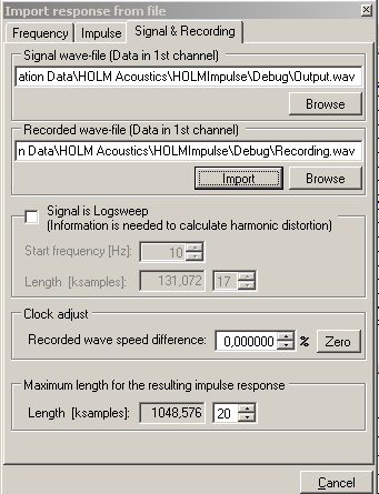

Attached picture shows the response of 30sec mp3 encoded music
I can't get this test to work. I can't find anything I am doing wrong. Does the length of the file have to be in between a minimum and maximum length to compare 2 files the way you did in this example?
I basically took one of my songs and truncated it to around 30 secs and then coverted it to mp3 and back to wav. I then tried to load the original and the decompressed wav like you have showing in the picture and hit "import". But then nothing happens - no measurment. What am I missing?
Thanks for any help

Just a user error sorry.
Figured out what I was doing wrong. Mismatched samplerates - duh. My master is at 192kHz 24-bit and I forgot that when you convert to mp3 it automatically resamples to 48kHz. So when I decoded the mp3 I ended up with 48kHz 24-bit instead of 192kHz. I redid it with an SRC on the decode and it worked fine.
Maybe if there was a way to add a "mismatched samplerate" and have that dialog pop up. Because when I did it incorrectly it looked more like a crash where the import window just disappeared without any popup.

Nice to hear!
I need to report an error if the samplerates don't match at import.
