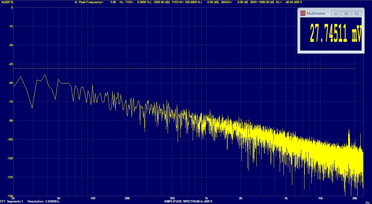

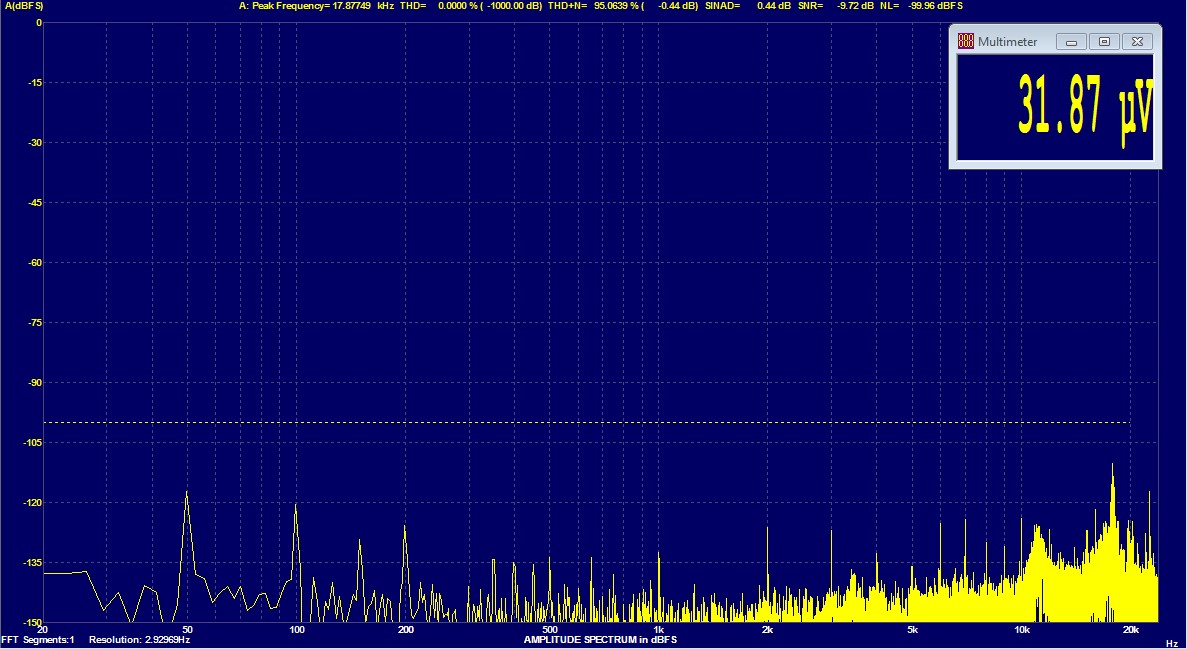

Hi all. I am having very little luck with the measurements of my implementation of this phono preamp. The measurements I have obtained are not even comparable to those obtained by Stuart, in fact mine are really bad. Could someone share their measurements on this forum?
There are no variations from the circuit designed by Stuart, except for adjusting some resistors to get the right values of voltage on the regulators and current on the CSS. A Partidge 977 step-up transformer (6:1) has also been used. Static measurements right channel (left is similar):
B+ = 249V, B++ = 155V, I (CSS1) = 20.60mA, I (CSS2) = 10.55mA, I (CSS3) = 10.72mA.
Va(D3a) = 114.5V, Vk(D3a) = 1.11V, Va1(ECC88) = 78.2V, Vk1(ECC88) = 1.79V, Vk2(ECC88) = 78.9V.
First of all, I would like to characterize my measurements as there is also the possibility that the methodology or procedure is incorrect, especially considering how difficult it is to measure this type of preamplifiers.
The equipment used was an external EMU-0404 soundcard (very low distortion and noise) and a Thinkpad T420 laptop (i5, 8GB RAM). Software: MI (sample at 48kHz, FFT: 16384, Wnd: rectangle, ~1kHz signal adjusted for no leakage)
The SW was calibrated, and for the THD measurement a 1mV, 1kHz tone, has been applied to the input (simulating the output of an EMT TSD-15 cartridge), as a result, 1.01V was obtained at the output. Next are the graphs:
- The first graph shows the output of the EMU-0404 with nothing connected to the input.

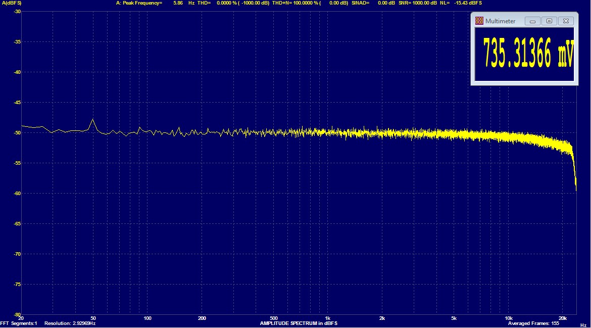

- The second graph shows the output of the step-up transformer (in the circuit) with input shorted.

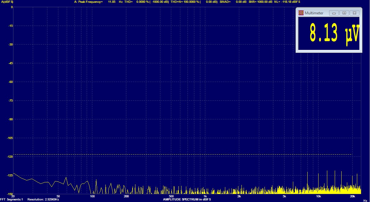

- The third graph shows the output at the anode of D3a with input shorted.

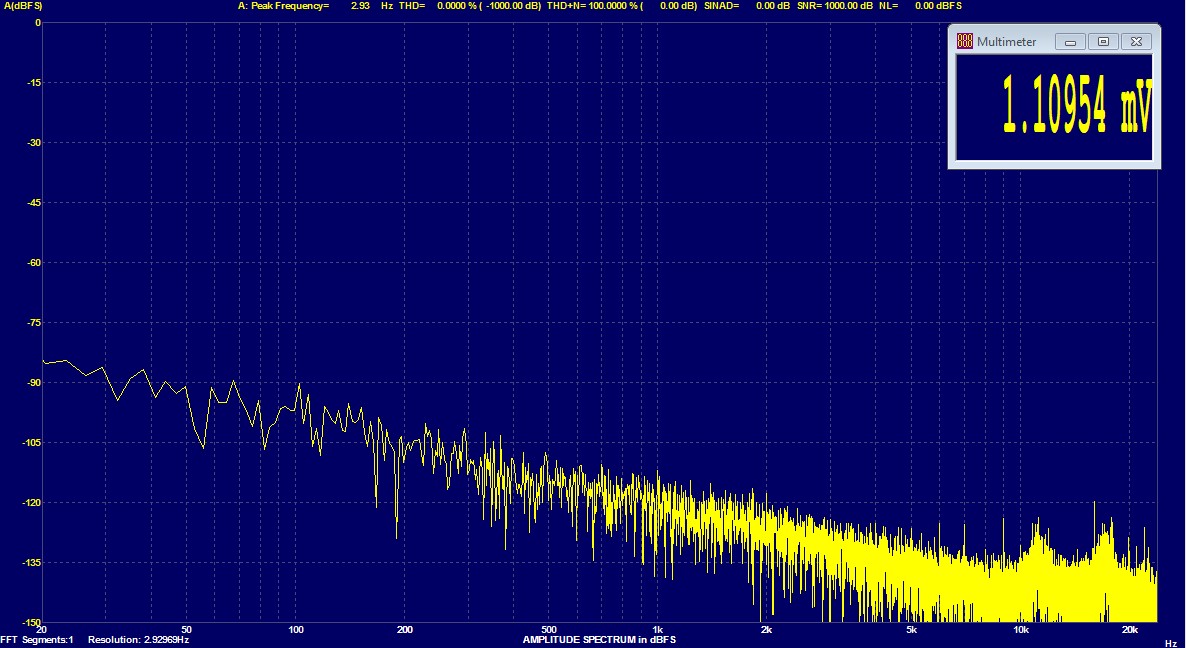

- The fourth graph shows the output of the phono with input shorted.

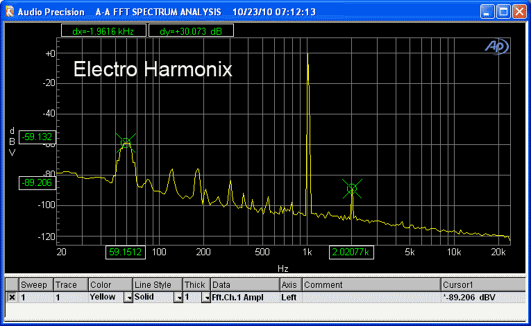

- The fifth graph shows the phono output with 1kHz signal at the input.

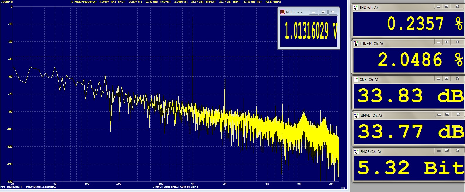

- The sixth and last graph shows the frequency response (white noise, averaged at the output) using passive iRIAA from Jim Hagerman.
Thanks!

With simulating the 1mv output, did you take a stronger signal then attenuate via resistors like stuarts setup? Im wondering how clean that 1khz test signal is.
You may also want look at the 1mV sqr signal on your fft directly and a scope. Does the signal look ok. Bear inthe mind the riaa will filter quite a bit of the squarness out. Dont worry, I dont think vinyl can really reproduce a proper square anyway, think about what the cutting head and stylus would have to do
I notice that you had the fft for no input connected and the output of the transformer. What about connecting your test leads to each other. Are they picking up noise?
If theres no hum on the output or dc. Have you tried hooking it up to your turntable? Does it sound ok or really bad. That might be a better test to ascertain whether its the phono stage or the test setup. Maybe theres noise from a smps creeping in.

The D3a is quieter when it is run cooler. TavishDad did a comprehensive survey of triode noise, and ranked D3a triode strapped at 7mA quietest of the lot. I think that somewhere in this long thread, SY may have concluded the same. You'll also find that maybe one in five D3a's may be noisy.
The HMN has tremendous overload margin so you can use a larger input signal than 1mV.
Best of all, HMN is a very, very nice sounding phono-pre.

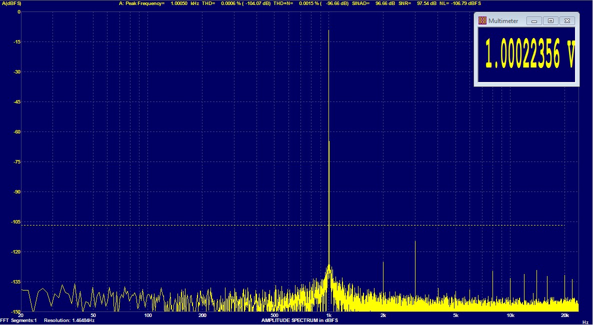

mrdave45, I think the 1kHz test signal is quite good (THD 0.006%). I attach a graph of it. This signal is passed through a reverse RIAA module (obviously this does not affect the sine 1kHz signal), which additionally has a voltage divider that provides an attenuation of 60dB, so the signal that was originally 1V goes to 1mV, from here it enters the HMV. This is similar to the method used by Stuart, except that my attenuator is not balanced and the impedance at the output of the attenuator is about 60 ohms (a bit high, Stuart's attenuator was 15 ohms).
One test I should do is to connect the input to the actual cartridge and see what happens. Maybe I can do it tomorrow. About testing the HMV in my system, I haven't really wanted to play music through it until the measurements I get are somewhat acceptable... perhaps tomorrow.
What I really don't understand (and don't like at all) is the noise pattern you see at the output of the phono preamp; it's a perfect ramp from -120dB at 20kHz to -50dB at 20Hz. Is that usual? What can it be due to?
jackinnj, I have several pairs of D3a and the result is similar in all of them, so I guess we can eliminate the valve from the equation. As for the input signal, I think it's a good idea. I will use a higher input voltage and maybe I can avoid the noise limitations of the test equipment.

Sometimes you will get fritzy stuff in the high freq end of an FFT from light fixtures, LF harmonics of SMPS power supplies. In fact Analog Devices has a white paper in which one of their engineers in France figured out that a fluorescent light fixture was modulating some "clear" diodes used as a clamp. Trivial, I can't hear any effect but have observed same.
