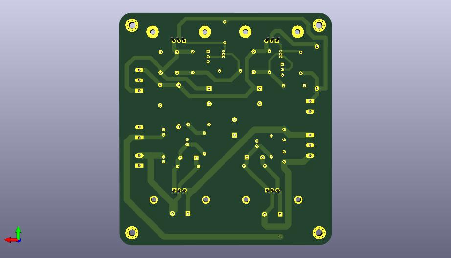

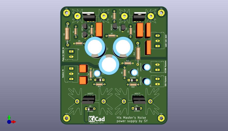

Power supply for one channel. KiCad and gerber files attached.
Enjoy !

Thank you for observations, Jackinnj !
Clearance between 260V and 160V is over 1mm, so this will be enough.
HV ground is completely isolated on pcb top and clearance at each hole is 1.5mm.
Heaters ground plane is lifted by resistor divider and between HV GND and Heaters GND is a large clearance of over 2.5mm.
All files have been already attached, anyone with little effort may change the design as he/she consider.
Tibi

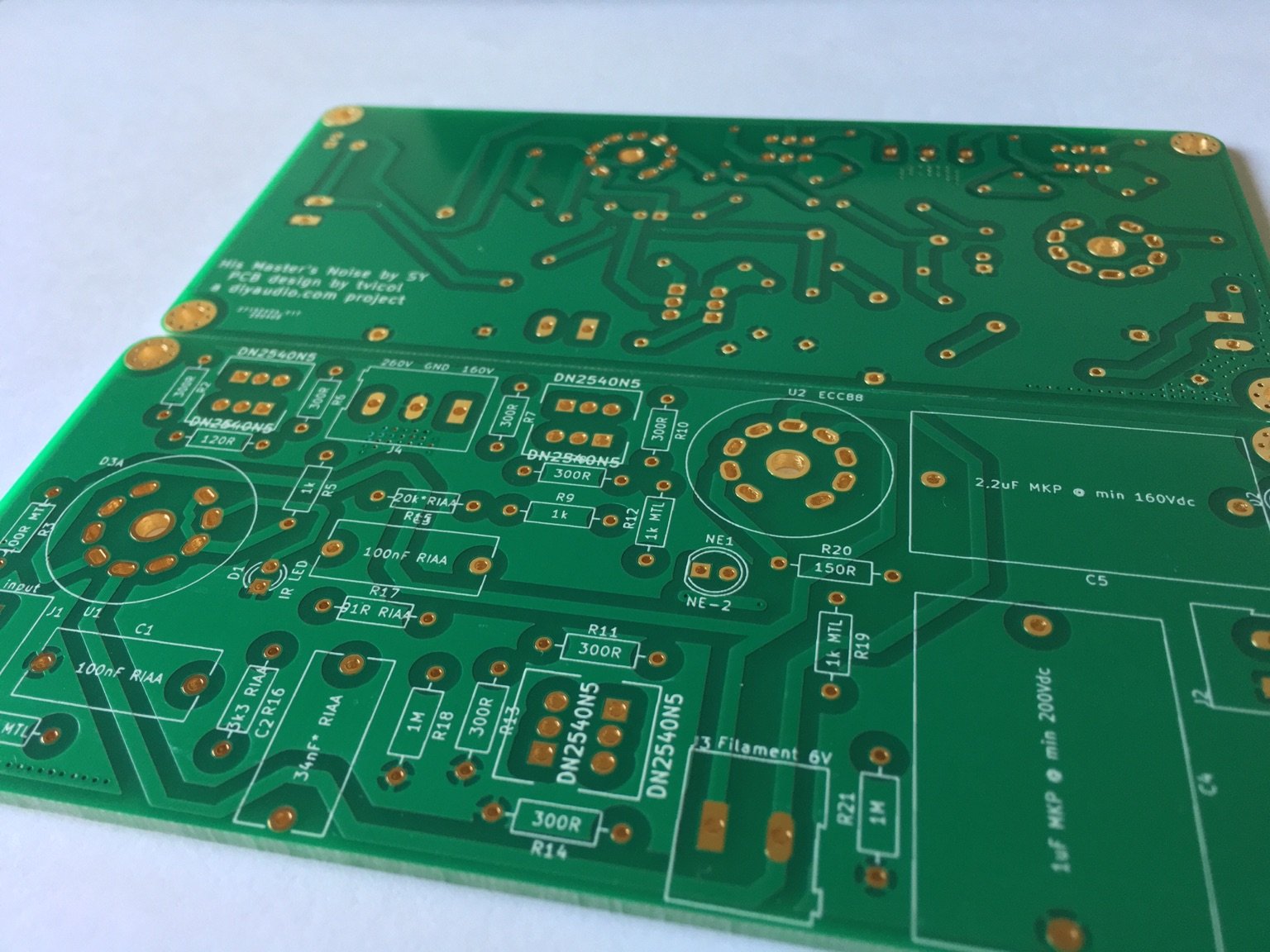

PS. I have ordered few boards and will post here pictures when finished. :)
PCB's

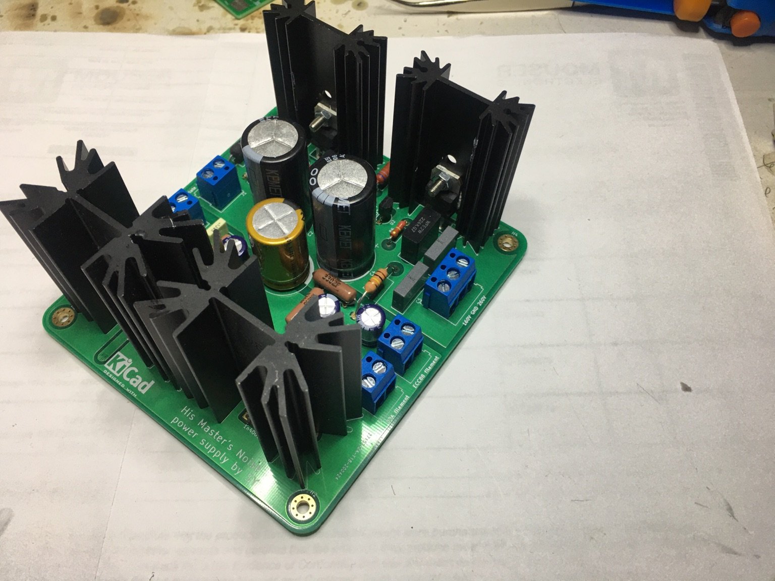

I am nearing the end of building HMNP. but i've got a real problem I can't figure out.
I've built each of the voltage regs more than once they check out at 258 & 159. And have set the ccs's at 20 ma and 10 ma per sys's design. when I bring up the voltage it seems ok but then slow the voltage at the output of one of the channels goes on run-away, after a few minutes at 2-3mv it starts to climb goes above 1 v and then really takes off to B+ 305v and that when i've shut it down. The first time i did the smoke test it blew up and i've had to rebuild the voltage regs. Whats the problem? is it a bad transformer bleeding into the ground line? I've checked and replaced all the caps. Each of the current sources tests OK at low voltage and the current is set pretty simply. It only happens in one channel?
Did you heat sink the pass transistors? They will burn quite a few watts if the raw B+ is much over +300VDC. If you're raw DC is high, consider using a power resistor to dissipate some of the excess energy.
R23 and R26 -- don't skimp here -- 1 Watt resistors please.

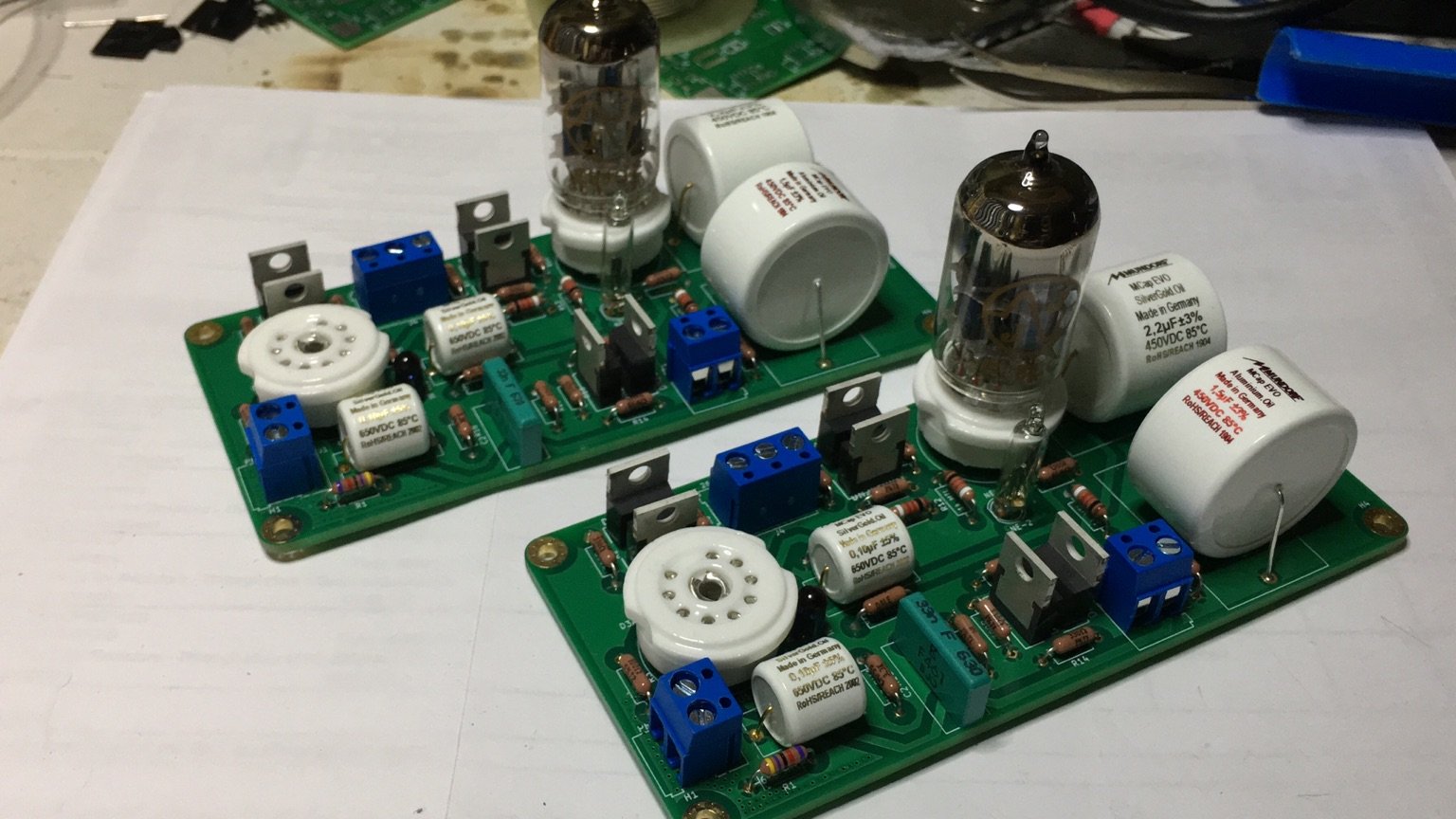

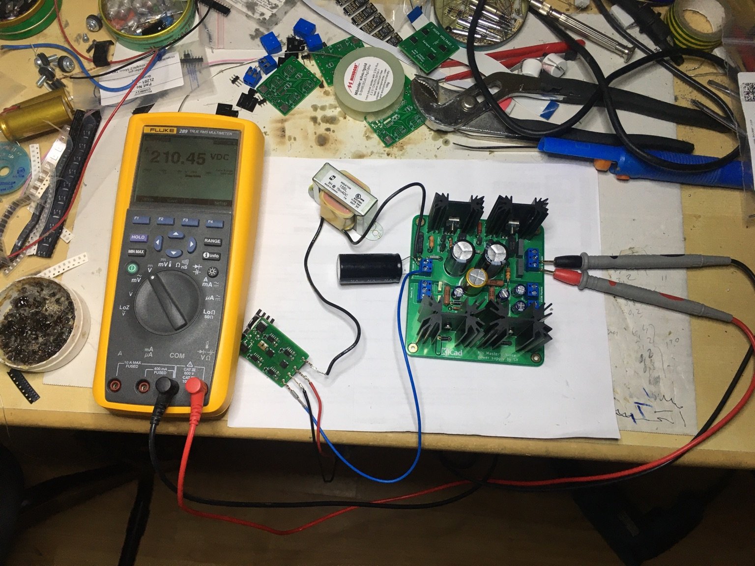

I have buildt the amplifier section with jackinnj’s boards, and the regulators with tibi’s boards.
The low high voltage is spot on but the 260v is locked at 212 V ...
So i need to change some resistor values to up it. I am not used to these sandy things, so
A few inputs about how the reg works and which values to change would be very nice
