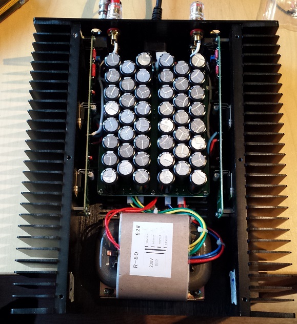

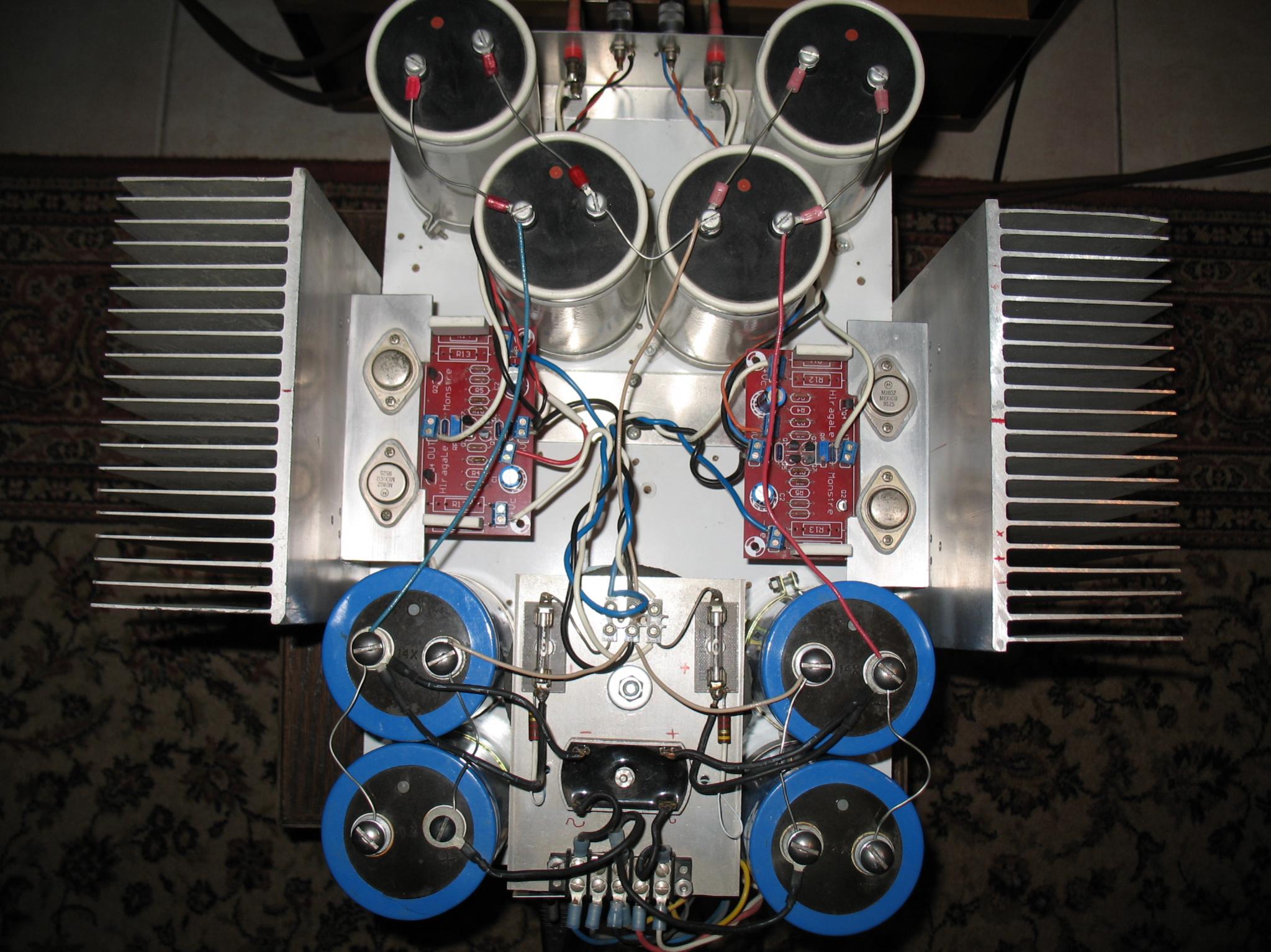

Hi all,
As promised I like to inform you with my project the improved Hiraga based on le monster
I am using MJ802/MJ4502 out put transistors
Idle current is 1.5 amp dc, Vdc 30 v each rail
After long run in idle mode and readjusting the Vout offset,
Connected to my system, Acoustat 3 spk and Odyssey solid state pre amp
YBA is my cd source
Well how it sounds like? Very well and a lot of details comparable to my pwr amp
It is built like a proto type with a huge pwr supply and big heat sinks
Now I have finished building the super Hiraga and working on increasing out put pwr
So wish me luck!
I attached some pics
Best regards
Williams

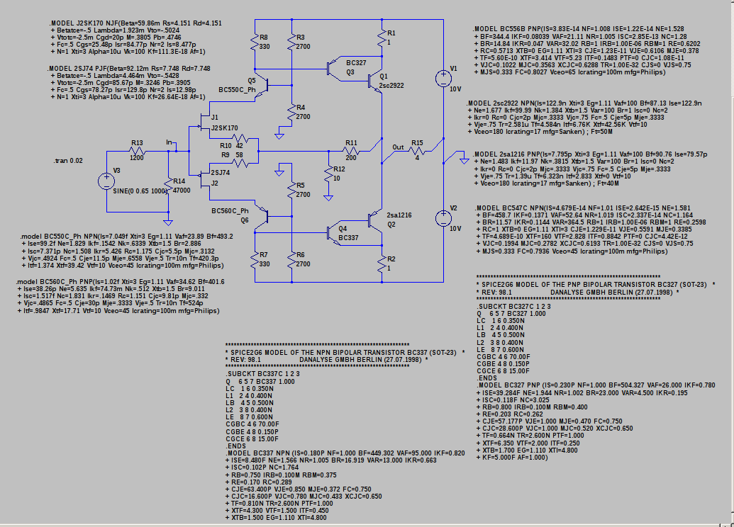

Here is mine !
2SK170/2SJ74 (8mA)
2SC2240/2SA970
2SC2705/2SA1145
NJW0281G /NJW0302G
And I changed the front end gain resistors to 510ohm for a bias of about 0.85A

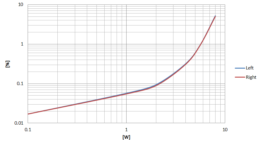

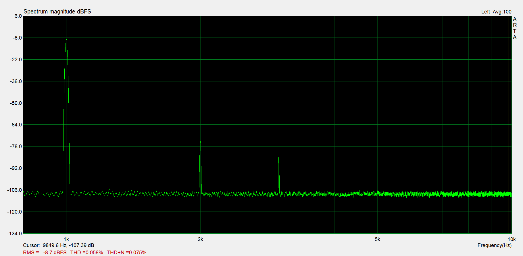

I also did a more "original" version with lowish (~3ma) IDSS 2SK170/J74 GR and original transistor for all stages except the outputs, that were modern onsemis. (NJW3281G / NJW1302G) It was biased at around 550mA.
Heres a THD vs power plot at 1kHz.

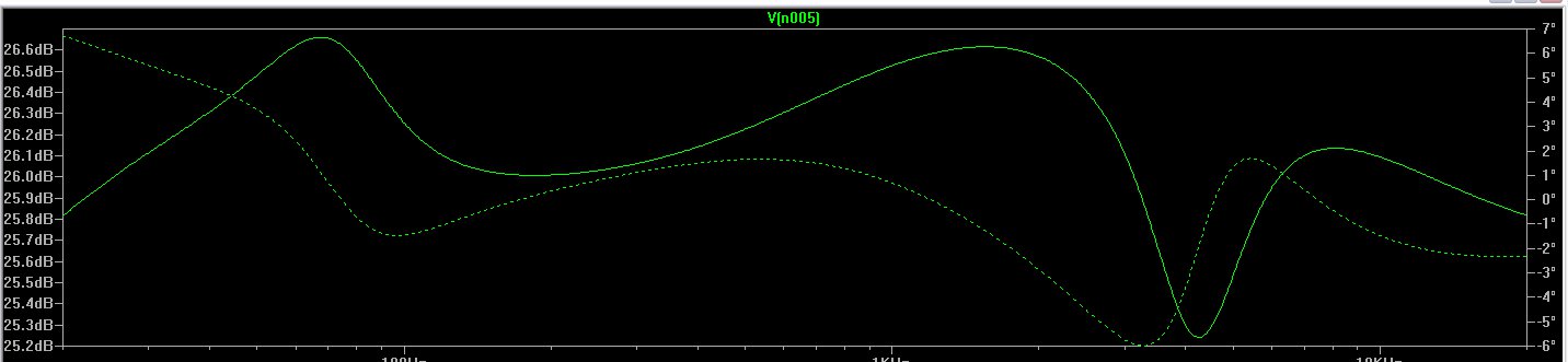

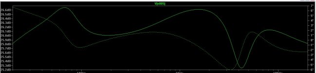

IMHO le monstre are more sensitive to the speaker type. Its measures well with Full range, but with 2way speakers you have dips and peaks in response (attached LT sims, but in real life its almost the same - i measured once with sound card on real speakers). You can bypass source resistors with caps -
See attached pictures. 1st - no caps, 2nd - with 100uf bypass
Of course it is sensitive, because it has a high output impedance. Every crossover will show up in the chart.
What can be done is have balancing filter sections to smooth the impedance.
All this is the same for tube amplifiers.
However some find that with high sensitive speakers the extra sections also 'suck' some livelihood.
  • But I like your idea !

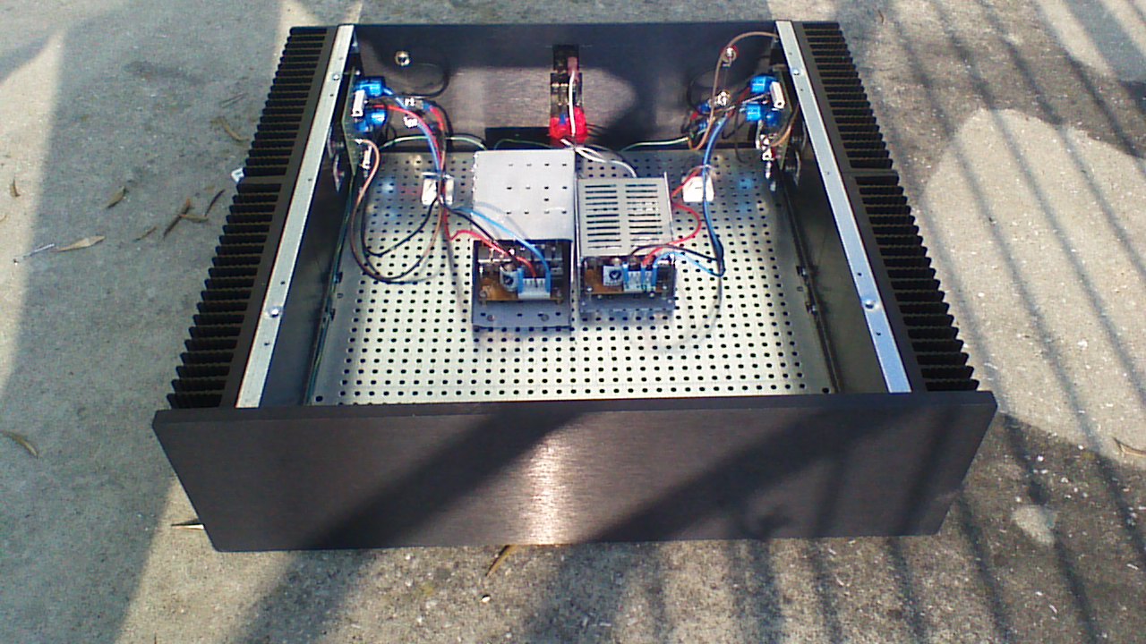

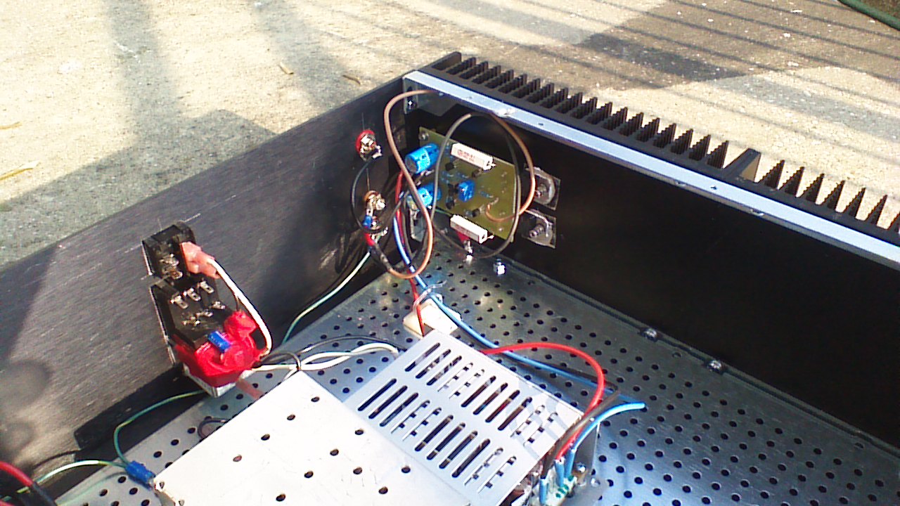

Here is a first amplifier build of my le monster on the cheap (I am a beginner in building amps so don't be too hard on me):
I had two RS switch mode power supplies (+/-12V, 1.8A) lying around and had found not too expensive preassembled old version boards from diy-audio-world on eBay. The boards use some changed components (power resistors e.g. would be better if non-inductive) and use K246_GR2k / L4f transistors and tip3055 / tip2955 output transistors. The case from modushop was expensive but is nice and has room for a second channel if I add a tweeter to my frugal horn speaker, or decide to upgrade to amore powerful pass f5 build.
The sound of the smps le monster is pretty good, comparing it to a miniwatt 2.5Watt single ended tube amp, I am happy, my le monster might have slightly more attack in the highs. There is slight hum in the high sensitivity foster drivers, but not too bad, and I think I can improve shielding from the sips (funny thing is that hum is reduced when touching the shield of cinch input). However I have slight problems adjusting the dc offset for one channel, as it fluctuates and is super sensitive on the potentiometer setting. This channel also is slightly louder. Both power supplies deliver stable +/-12.2V and the bias current is a perfectly stable 0.6A for each transistor.
Does anyone have tips how to reduce the amplification of the louder channel and why the balancing in this channel might be trickier?
