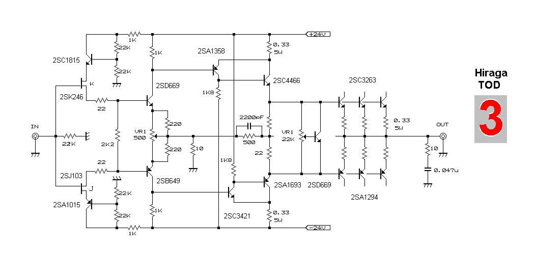

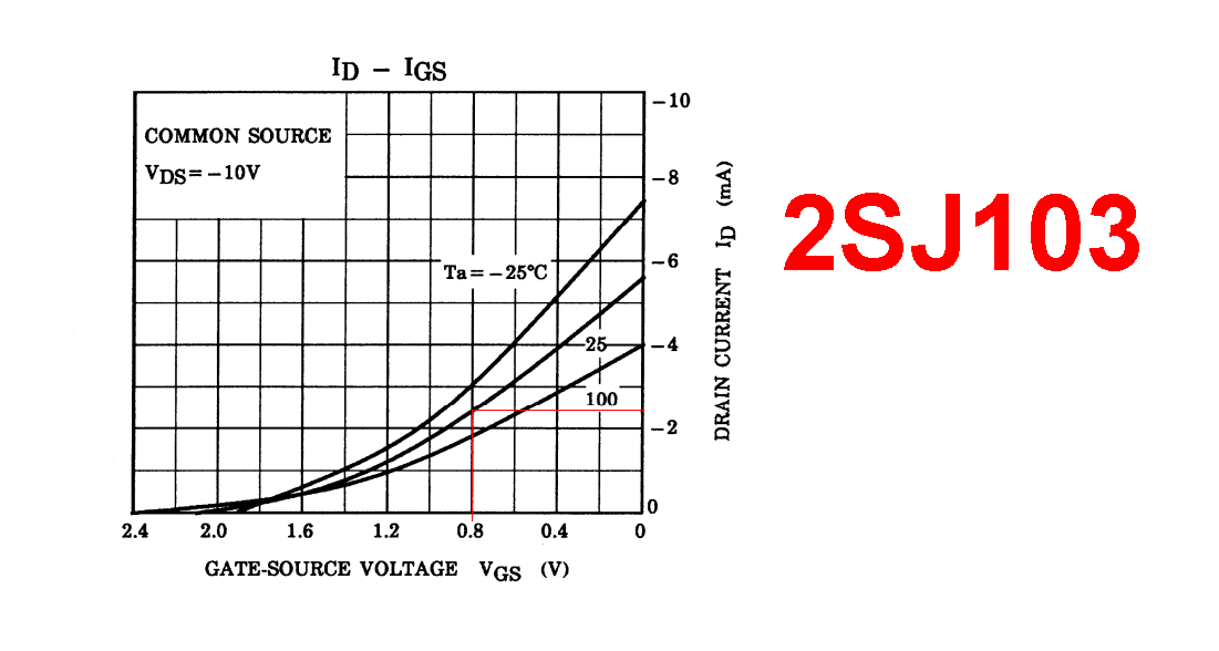

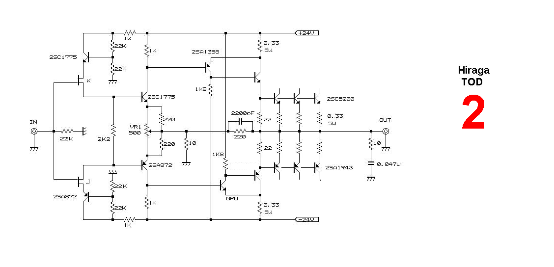

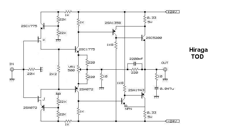

Hiraga TOD
My idea is using Jfet bootstrapped
as Diamond input buffer:)
like first design

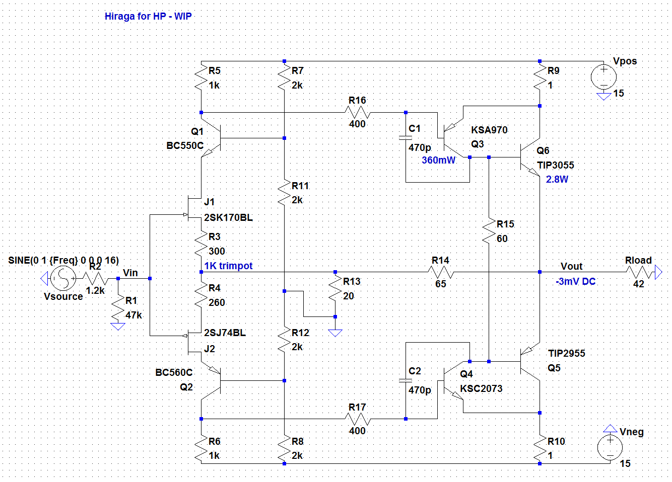

I decided to build an headphone amp based on the Monstre circuit.
My starting point was the one published by kk-pcb.
Since I wanted much less gain (and lower distortion) I had to touch the feedback resistors. Therefore I chose slow and low-gain driver transistors (the fairchild pair with only 4Mhz Ft) and also added a little compensation on them. I hope this wont make the amp oscillate.
The input jfets are not matched which I have in my scrap bin, likewise for the BC. One heatsink per channel will be used, good up to about 10W.
The two resistors R14 and R15 are just to reduce the power dissipation of the output transistors within the dissipation alu available.
My goal was to keep a nice harmonic spectrum (mostly 2nd and third) and plenty of power/current to drive eventually even orthos, and without using exotic transistors.
I wont start building it before a couple of months, since I have other stuff on schedule, but the simulation looks promising.
PSU will be the regulated sigma22 which I use on most of my headphone amps, with 80-120VA transformer.

Which way you want to set the quiescent current?
What do you mean by "which way"? If you mean how much, it's about 200mA per output transistor.
Didn't you read some articles about this circuit?
Yes, I read the original articles online and all this thread. I cannot use 12x gain to drive phones, therefore I had to do what I did.
If you think there are some mistakes in the schematic, please correct me :)
"Yes, I read the original articles online and all this thread. I cannot use 12x gain to drive phones, therefore I had to do what I did."
Why you have to use these large, slow output transistors? You only have to drive phones?
My opinion is, there are better solutions for a headphone amp in the DIY.

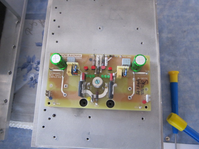

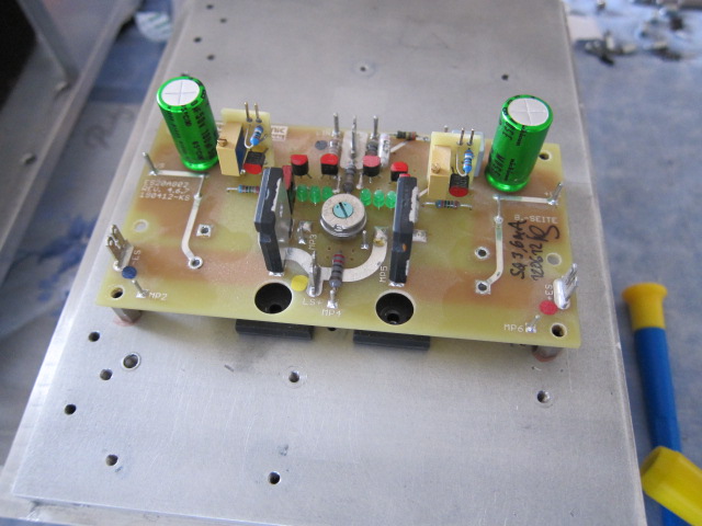

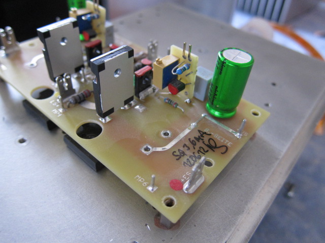

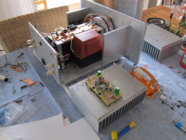

There is a pix of the last generation "Hiraga 8 Watt" from Klaus Scherm, Germany.
He changed drivers and output trans, and made a tricky setup with current sources for the input Jfets.
sounds great, and was successful at the poweramp shootout at the german "Frickelfest"
Endspiel/es02
Frickelfest 2012/hb/ff12_079
Frickelfest 2012/wl/1 (20 von 60)
Regards
Sam
