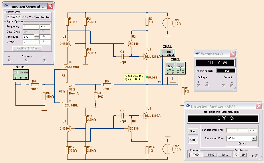

Hiraga "Le Monstre"
It is fully possible to increase to +16/-16 supply.
This almost doubles the power output.
Bias should be increased to 1.0 Ampere
Like here. See image.
THD 0.200% 10.75 Watt +16/-16 Volt supply
compared to 5.87 Watt with +12/-12 supply

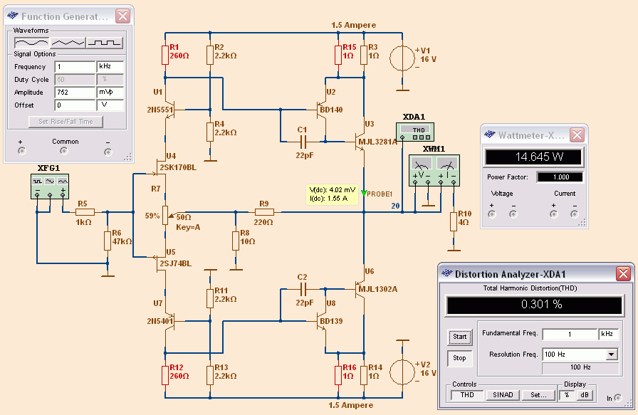

I made a 16 Volt 4 Ohm version.
See diagram.
The components in red are which adjusted.
- Added two extra 1 Ohm resistors
- Adjusted R1 and R12 for 1.5 Ampere bias.
4 Ohm speakers need more current than 8 Ohm
The output result is 14.64 Watt into 4 Ohm
at THD 0.300%

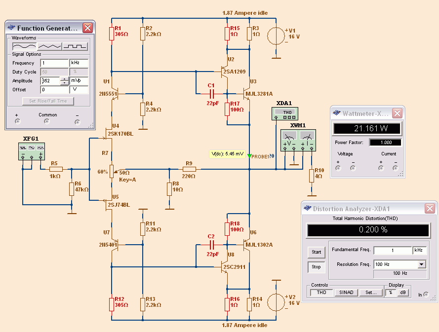

I have tweaked the 16 Volt supply foor 4 Ohm further..
Here is my final try.
Changes from original Hiraga is in red.
- 2SC2911/2SA1209 are most suitable.
- Also added two 100 Ohm resistors for lower distortion.
- Along with those extra 1 Ohm resistors in output.
- Two 22p caps can be added for compensation.
- Bias is 1.87A. This means large heatsink
As can be seen we can get something like 21 Watt into 4 Ohm
This is not bad compared to original 5-6 Watt into 8 Ohm.

Hi, lineup,
May I suggest a larger transformer, as 12 V will get 15,7 no current (16,9-0,6-0,6) but any load will drop that significantly; with CRC filtering I suggest at least 2x16 volt (measured across a 5 ohm load). That's how I do it.
I like your developments of the original schema very much. The new drivers have a very very low Cob. The 'old' output pairs are a bit weak. Would be interested as to hear the effect on the sound stage.
albert

I've been working with this schematic for the last few weeks and I intend to build a monster for driving 8 ohm loads in the next few weeks (transistors are arriving soon). Can you tell me why you decreased the emitter resistors in the output stage to 0.5 ohm when using 16V rails? I like the idea of getting (a little) more power out of the amp, but I don't want to run a bias of nearly 2 amps.
Others -
I bought some of the parts (output transistors, mostly) from MCM Electronics. It sounds like these certainly aren't the originals -- does anyone have experience with them working well anyway? I bought the JFET's and the cascode BJT's on Ebay.
(I don't see an option to edit my post..)
Update:
I now see that the 0.5 ohm resistance increases the bias current in the output stage which is needed when driving a 4 ohm load to keep the amp in class A. So if I am to build this amp with 16v rails I should be able to still use 1 ohm emitter resistors with a bias of 800ma - 1000ma. Do people usually use pots for R1,R12 so that the bias is adjustable?

This is for 2x16 Volt operation.
For 4 Ohm I recommend 0.5 Ohm and 1.5 Ampere.
For 8 Ohm operation you need not the extra 1 Ohm resistors.
And you set bias to like 1.0-1.1 Ampere.
These figures is for pressing the amplifier max possible output.
Of course you can chose to run smooth on less current.
