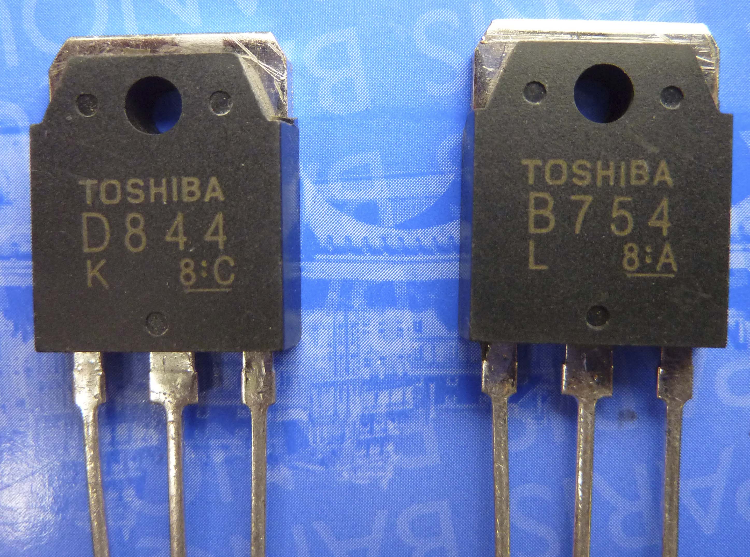

These are fakes thereby worthless.You'll find below a picture of these original transSD844K-SB754L.jpg, but i'm afraid you won't find them in real life... Nowadays, Toshiba has changed for the black and green series, only "O" and "Y" grades. "Y" is out of range, but with "O" you may get closer to the original Hfe. On the kit, it's "O" grade...

On my side, i am not penetrating enough to detect fakes just looking at a picture.
I usually use a curve tracer.
Rgds
PY
Thank for your quick help.
Rgds
PY
I do not want to protect MCM electronics.
Do you think a big company like that sell fake transistors, all do what we see on the picture I'm not sure is from MCM electronics.
Cant be fake!

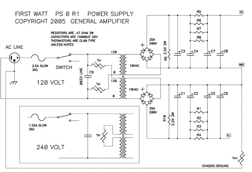

- Oscar, can you be so kind to give me your PSU schematics? It must be perfect for newbie cause easy
- Is any DC speaker protection needed (no cap on output) or it will affect sound badly ?
- Will this work with 50kohm ALPS directly from CD or pramp needed ?
I see this the schema with 2N3055/MJ2955 power output transistors - not MOSFET.Gabor, I`ve seen Monster kit specially for you – mosfet version

Possible, presumably by some Taiwanese company.I think those transistors (Toshiba) specially made to MCM electronics.
Highly unlikely (out of question).The store order them from Toshiba.
I purchased hundreds of kits from MCM electronics , I sold them on Ebay not one complain.
When MCM run out from Toshiba they ordered min 1000pair or 10 000pair from Toshiba.
I have no interest to protect MCM!
I got all positive feedback on the kit I sold.???
Toshiba has plant in other countries not just Japan!

It will be easy to tell if the transistors are genuine or suitable.
