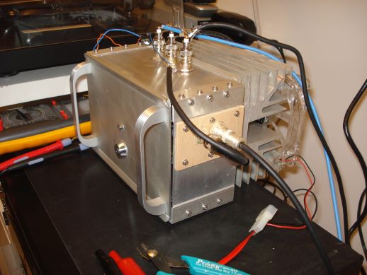

Some suggest setting the bias between 0.5 and 0.6A. I guess this is what needed for class-A operation? The original hiraga sets the bias to a much higher level. With 1K resistors it sets to about >2A for my amplifier. I believe this is too much and the 1Ohm resistors get VERY hot. So why setting the bias as so high levels when you can achieve class-A operation at a much lower bias?
Anyway I have just set the bias on my le monstre at 0.55A so here are my first impressions from the amplifier.
My system:
le monstre amplifier
Preamplifier none
Source mini disc deck and output taken directly from the analog out. I use the digital attenuator of the mini disc.
power supply two 80AH deep cycle batteries. No PSU.
url of the construction Le monstre (please ignore the I/O connectors part as I have to review this)
Speaker cones audio nirvana super 8 full range
The amplifier impressions and technical observations:
I run the amplifier on a huge heatsink. It takes about 1hour to get half the heat and about 2hours to get at a quite high temperature.
At the beginning I had not used a fan for it and just waited for the amplifier to warm up after 2h in order to set the bias and the balance. The bias changes much when the amplifier is heated, about 100mV and maybe more.
I found it no practical to have to wait for 2h in order the bias to be automatically set to the correct value, so I thought to keep the temperature low at all times. So I added a big diameter 12V fan out of a computer heatsink and run the fan only on 5V. This eliminates any audible noise from the fan. After all just a low air flow is needed to keep the amplifier cool with so big heatsink.
*** I have a question here, is it ok to keep the amplifier cool at all times (thermal equilibrium issues between final transistors?)
Continuing my revision, by adding the fan in this slow-mode I found the heatsink temperature variations very small, near room temperature.After a long hour the bias remained quite constant and did not need to be reset. Also the parts inside the box (that touches the heatsink) remained cool now. If it is ok to run the amplifier cool, I think the problem of big bias change due to temperature variation has been solved... After all I found that the bias remains quite stable at voltage variations 13v-12v as the battery discharges. It seems to me bias is truly affected only by variations in temperature.
It has been 5 hours now of continuous operation of the amplifier with the 80AH batteries only, and they have been discharged from 13.5v to 12.4v after 5 hours. The manufacturer suggests not to discharge them below 12v for life extendability, so I guess with two 80AH batteries one can get at least 6 hours of continuous operation, which is not bad at all to my taste...
The sound:
The highs, Killing! Bright and distinct. I can listen up to 16KHz and that is my ear listening limit as far as I have noticed :)
The mids, bright and clear. female voices are separated well and distinct within the song.
The low end, a bit shy to my taste, but very controlled. The low frequency response is just too low for my ears to hear, I can see the speaker cone moving too much on 20Hz but I cannot hear the sound (maybe I have not golden ears :p ). A note here, my cabinets are very small and you cannot expect so full bass from a fullrange cone. Nevertheless I will have a more clean review about bass when I construct my BIB cabinets at a future time :)
And here is the photo of the amplifier in test mode operation :)

Hi neazoi,
Congratulations on the amp - looks good! The heatsink looks huge - I'm surprised you need the fans with such a big heatsink.
Actually, the original Hiraga article about the Le Monstre recommends a bias around 0.5A to 0.6A. (Although of course there is no law that you can't change it...) You can find the whole text at
The Class-A Amplifier Site - Jean Hiraga Index
although not all is translated into English.
Cheers, and congrats.
Nigel

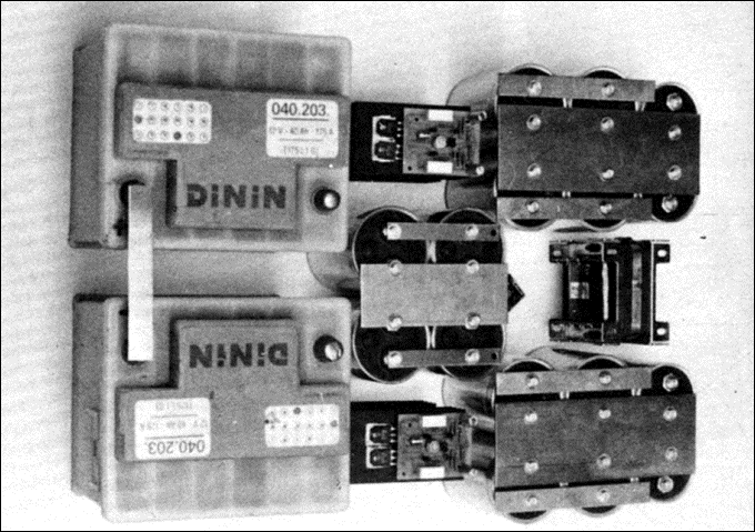

Do you use any PS capacitors??
Than can influence the bass of the amp!
If you look the orig Le Monstre it use capacitors not just battery. Also you have to use the 2 piece 47uF capacitors on the PC board.
If you can get some Elna Silmic that has good bass..
Also make sure the wires from the battery to the amp to be thick enough..
How N Pass advised as short as possible and as thick as possible.
If your wire to thin your amp will suffer..
I sold over 100 set Le Monstre transistors, nobody wrote me back the amp has shy bass.
Also I built one with Capacitance Multiplier PS. The amp sounded well balanced..
Now I want to try the mosfet verison..
Greetings

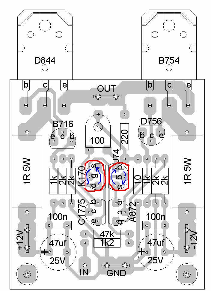

Hello
I think you PS wire to thin! Usually the battery far from the amp bcoz they heavy etc , please if you have thicker wire try to hook up with that.
These not because those wires can't deliver 1A. Here you have to think about the to get the best sound, the best solution..
Different when you hook up a light bulb etc.
Usually the components can deliver better sound in a elevated temperature.
I do not want to argue on these .
Even factory made Class A/B amp sound better after warm up.
Right now I listen a Nackamichi , I know what I'm talking.
About these ask people like Mr N Pass who built Class A amps all his life..
I just have only 20 years experience..
On the forum someone started a post to build the best Aleph amp as possible.
Please look up that..
I do not write you run the amp 60C degree, no reason for that.Your speakers really small to get the correct evaluation..
All I can say the Le Monste has more than enough bass with the right speakers , speaker cable , music source etc.
Also next to the battery Hiraga use a lot of capacitor, I think that not in vain.
On the PC board do you use any electrolytic??
That is very important to. 47uF..
I post some picture so you can think about.
Greetings

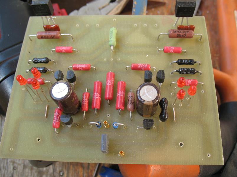

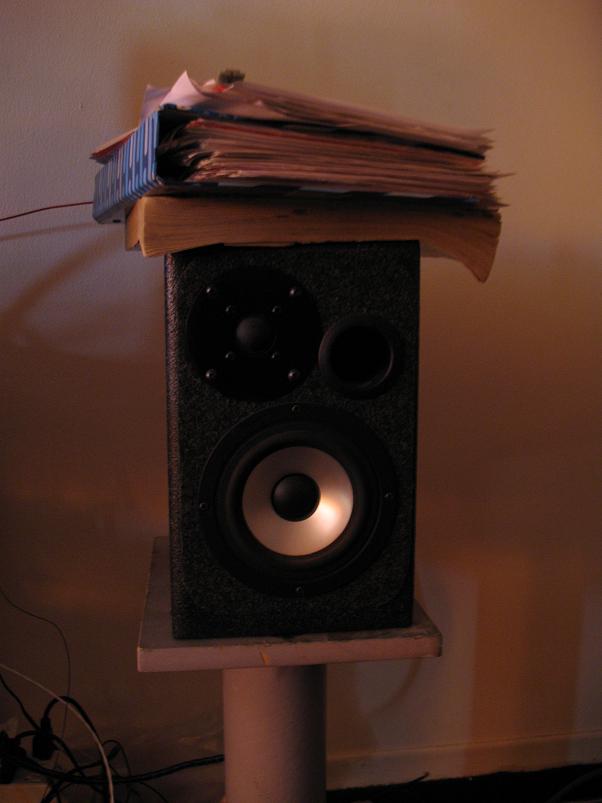

Hello
These speakers I used with the Le Mosntre . The enclosure about 12L BR..
I use Visaton AL130 and Audax tweeters .
I was satisfied with the Le Monstre , and my speaker only 87db.
I had more than enough bass , with the P Daniel Gain clone the bass was a bit shy.
Right now mostly I build my amp using power mosfets..
But also I want to give a try the Hiraga Class A one more time , to me that has more balanced sound.
Has more tube like sound..
These is a new type of PC board , not finished yet. Power transistors etc need to be mounted.
Greetings

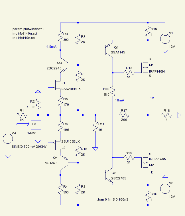

Hi, I have started the construction of the Le monstre amp with new parts.
I tested this amplifier in Spice. I think that the THD is too high - 0.5% @ 1V input , 1Khz and output about 6.5 volts. With BC 550/560 as drivers - even worse.
Bias 0.6 A gains 16.6db.
I saw better results in your sims. Its maybe transistor model problems or just fine for Le monstre ? (just want to know before I started to solder ;) )
regards,
Oskars
Hello Osscar
Can you do a favour to me, please.;)
I want to build the mosfet version of the Hiraga le Monsstre.
Can you run a sim. on these schematic.
With only one change I'll use Toshiba power mosfet.
2SK1529 & 2SJ200 or I have the bigger brother 2SK1530 & 2SJ201.
I'm planing to increase the PS to 17VDC.
Of course with max 1A total bias. I'll take care of that!
I just ordered the resistors for these amp. Only I have to get some driver..
I would not use the BD drivers! Take a look the modified version at Kristijan website! I'll look up for you that schematic, and I'll post it.:)
Thank you very much
Greetings
gabor
