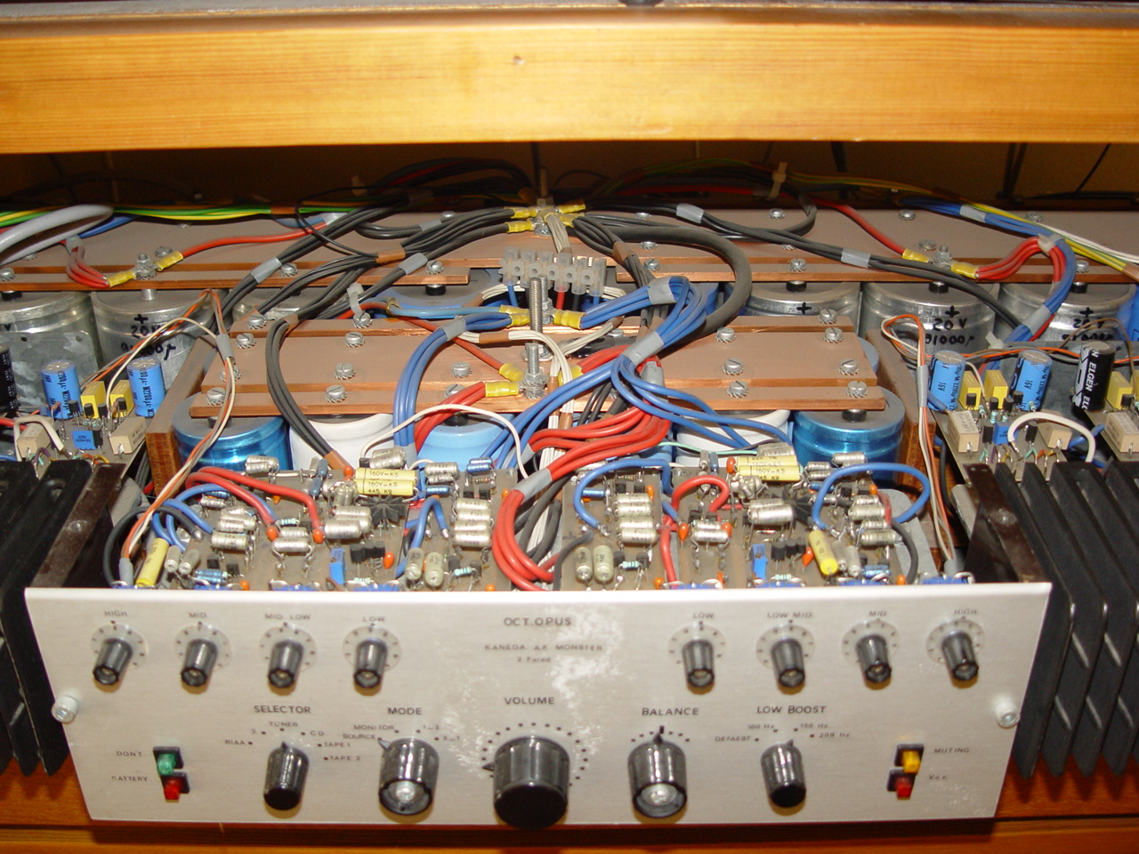

hi "monster lovers",
I show my home made monster "octopus" (built in '89 base on AF Nr27/29/31),
Total: 8 (=4x2) monster units, (with pré-amp en actif filter kaneda),
Tr, 2SC1775/2SC74/2SK170/2SA872/2SB716/2SD756=2SD844=2SD718/2SB754,
Stable operation (DC-output),
Total capa appr 1 F ( with power of 45" music),
Power supply:
First: with (big) batteries (floating psu with LM338 with correct ventilation), annual electricity cost "exorbitant" (problems with WAF),
Second: with transfo 500VA (no regulation and a pleasant WAF),

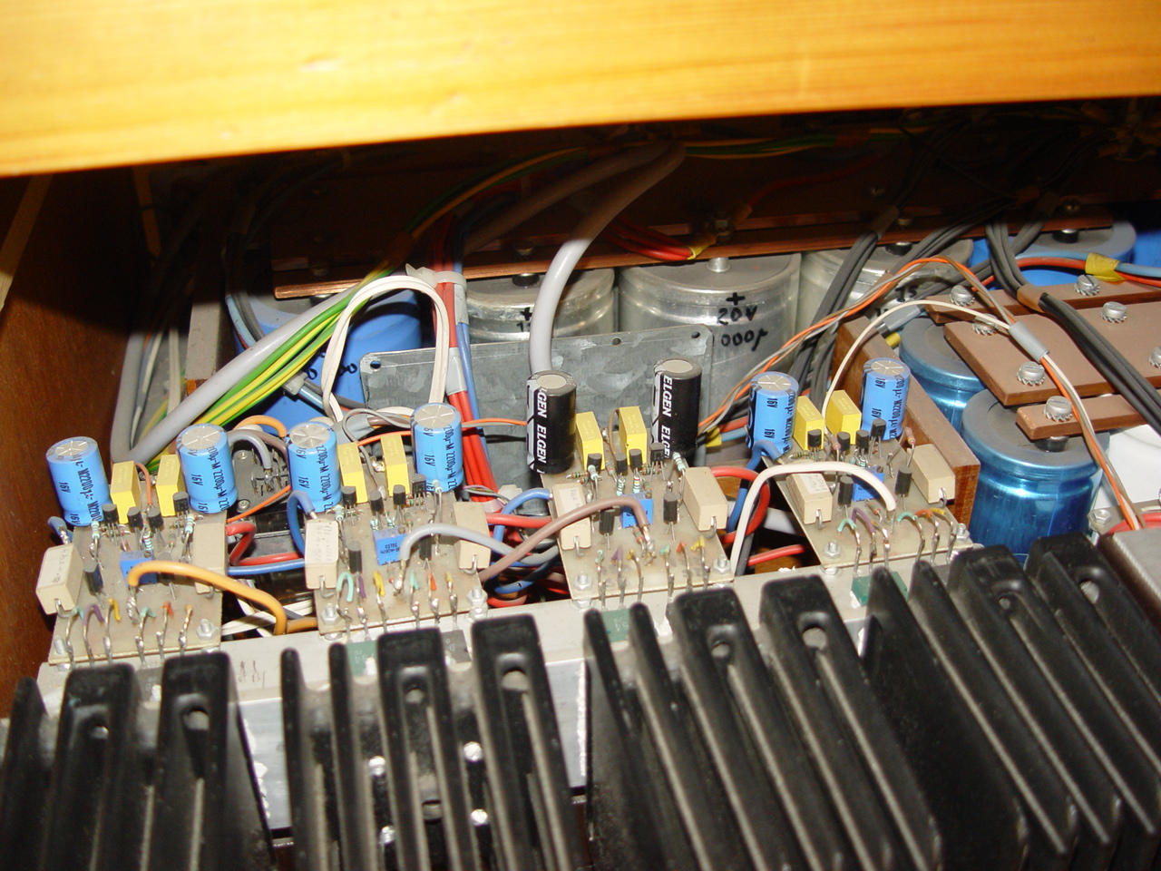

I enjoy seeing these pictures of yours, nice work.
But I can see some bad quality components on the amplifier, which is maybe the reason for some of your problems?
The most important thing for this degration I think is that you used the amplifier with the octopus preamplifier. I have no idea about this circuit but I can see plenty of low quality caps on it which may not be good.
There is no need to degrade the direct coupled topology of the le monstre by using a full-of-caps preamplifier. Have you ever tried it directly from the CD, without using a preamplifier?
The only thing I am worying about the le monstre is that it is a push pull circuit, so cross distortion may occur. Does anyone have some comments on this???
Hi costas,
I appreciate:
yours "eagle eyes"
and also your very large (practical) info on your site (even "the" monster),
but, note that I have "no problems" (technical and of course "musical") with my 4-way-home-made-monster and the components,
fyi:
I built it in ...'84 (cfr AF27 a-o), i time with no internet and a nice DIY forum,
my scoop was to built a 4-way-actif-amp,
I choose for Kaneda (pre-amp and filter) and akiba (cfr hiraga) or 8-monsters (simply),
I used only "on the shelf" components,
and of course, with a actif (kaneda) filter ... you have some "caps" in the signal circuit ....
are those components "bad" ! I don't think so (in a 4-way-actif-system),
even, with an other same (friend of mine) 4-way monster and with other more "high-end" components (more Euros or Bf) there wasn't a significant musical result in vivo,
of course, you have a point (and i know it very well): "avoid caps in the signal way", but it's not easy and irrealist to have "none",
in fine:
about (monster) pp-concept I have n.c.,
every electronic system has is own (electronic/musical) deformation,
my experience: built and tune it in a correct way, and with other (SE) concept compare it in vivo (and blind) in the listening-audio-room (same audio conditions),

fyi:
(one good musical note: in your site the "art-order-contact" is not actif)

any how here is my latest progress pics....
-Dan
