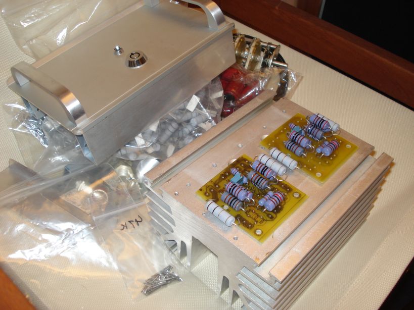

At last,
I found the time to begin the assembly of the amplifier..
This is how it can be squized if you use higher wattage resistors
(only the shincohs have been soldered)
Hi Neazoi !!!!
WHoa they are soem serious resistors ! what wattage shinkohs are they
lol i think they are a bit extreme for the currents involved - but you will have good thermal stability

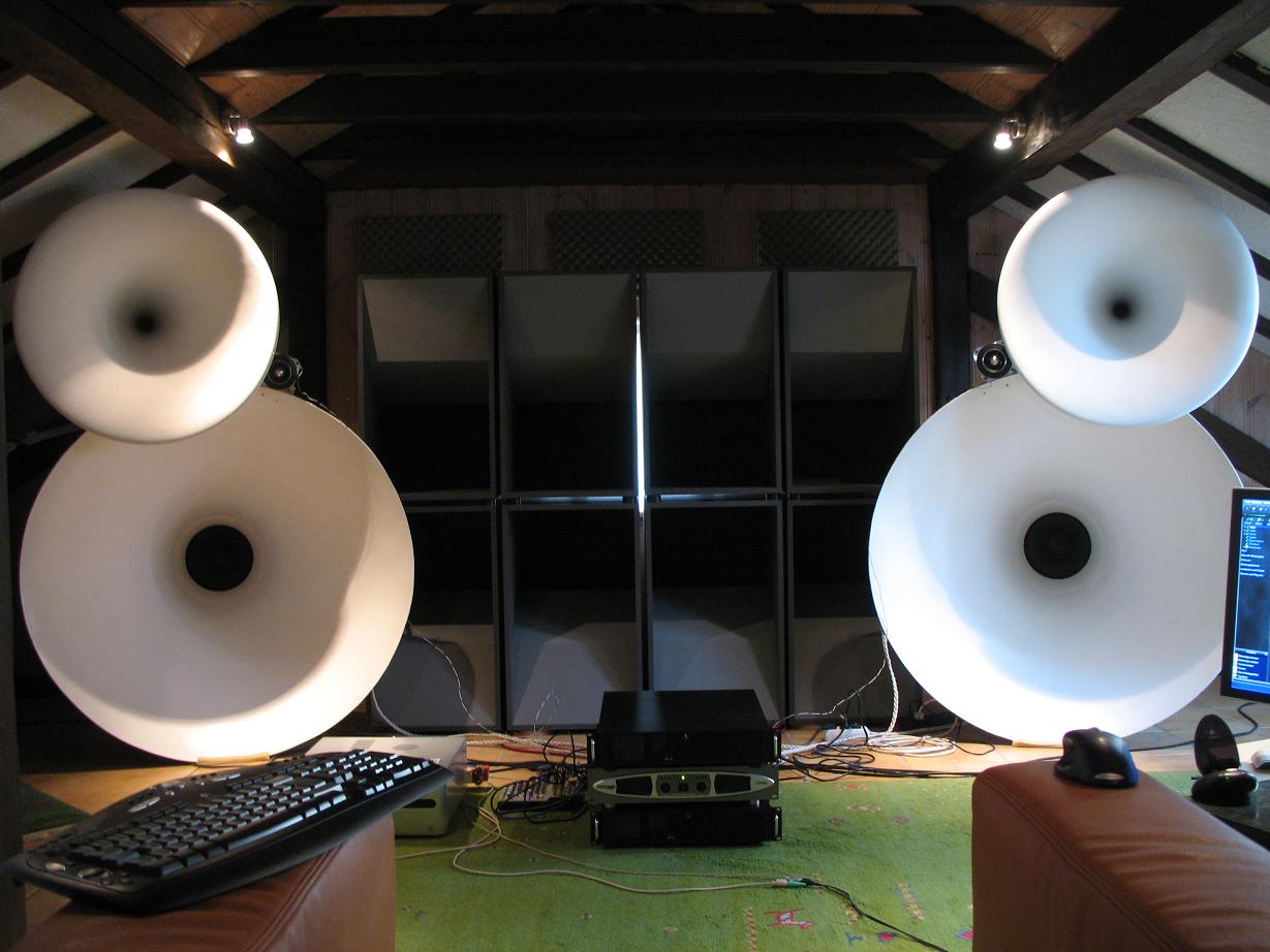

If i found a amp, which is definately better (im my chain and personal taste) i would change to class a or whatever.
but at the moment my modified Tripath based amps 2021b, 2024 (Glimmer, Wima FKP1, Elna Cerafine) and with the buffered batteries , it`s an unbeatable chain for very less money!
High sensible speakers are a must - with 85db speakers my T-Amps have not enough power for driving them to real high volumes.
Here are my speakers:
the big Tapped Horns can not be seen here
best,
Ralf
Hi Neazoi !!!!
-Dan
Yes they are much more wattage than they needed.
Unfortunatelly this wattage is the only one I could found in the values needed (shinkohs are very rare as you know). But it does not harm and may be even greated (thermal stability) like you said.
I tried to keep the leads as short as possible (0.5cm more has not inductive effect in sound frequencies)
The big ones are 2watt. They are bigger in size than the standard 2watt carbon ones.
They are very expensive, much more than caddocks
For this amplifier I will use non-standard ideas. I design my whole audio system from scratch with a different philosophy. I will give some hints and comments are welcome.
For example, to minimize the capacitance of the input cables I will not use coaxials. I will use separate plain silver wire for each +/- (which is much lower cost than silver coaxial) and some audio note non magnetic speaker posts and bananas for the outputs as well for the inputs! For the output cables also I will use the same idea but using thicker silver wires. These silver wires are sold much much more cheaply on ebay and they are 99% or more plain silver. No shunt capacitance that way (minimized), perfect characteristics.
The drawbacks
You have to make all your sources compatible to this non-RCA plugs
No shielding. But the room is far from electromagnetic sources and it is at underground level
(the earth around the room is the best shielding. proof that my mobile phone is dead when inside the room)
For the preamplifier I will use a passive one (of course) but using new ideas too. My CD and MD have internal attenuators, there is no need for an additional (noisy) volume control. For the Phono section I am thinking of using a kind of lightspeed attenuator (this idea is brilliand but I do not know about the sonic properties of the photo resistors)
I will definitely want to make an autobias circuit for the monstre too. I will work on it...
And of course no crossovers on speaker cones (I use a pair of nirvana super8)
Sorry if I am a bit out of topic, but starting from this nice direct coupled cuttie it is worth starting to think of cable or components issues. After all you have to know how what I/O connectors you are going to use when builting it.
Any comments are welcome

Ralf, Put simply I am jealous of your speakers and i have elsinores...
Neazoi, I like your ideas with the cable capacitance/inductance reduction, wheni was testing recently i was using a MSO capable of very high sample rates and over 1GHz. the three minor problems i encountered were
1, Inductive load resistor >6uH
2, cable impedance on the input and its reactive properties
3, the signal generator / signal input cable i was using seemed to limit the amplifiers freq response.
also - my personal opinion is you will not need to adjust the bias point once you have it at the right value this is a very stable amplifier, i think modifying the bias circuit is probably unnecessary - but let us know if you do try it out.
-Dan
