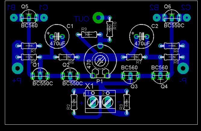

Hi Upupa,
Here is my new layout arrangement. all outputs had been pushed up and input down. VDD and VEE have less spreading but need a jumper to connect the feedback resistor ground and input ground cos' can't find a way to make a short path between them What do you think of this new layout? Will it still hum?
What do you think if I fill all unrouted area with copper and connect it to PSU ground?

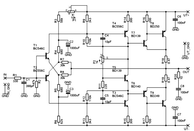

Here is the schematic of the BJT input version.
Due to the smaller output impedance (1.3Ohm) of this version, the bass is less with my speakers, that is the main reason I preferred the FET version. I have to admit that I did not make extensive listening tests to compare the FET and BJT input version, so there can be more difference in sound.

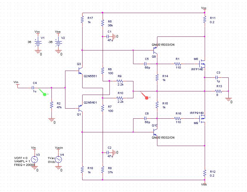

here is my implementation of the BJT version, with MOSFET at the output.
What I found is that you can bias this thing into class B. However cross over distortion starts to creep up when bias goes below 350ma (you can go lower with a bjt at the output).
I would say 750ma and up is better.
R5/R8 are trimmers for biasing and output DC adjustment. R10/R7 and R9/R6 for gain, R14/15 can be omitted or dialed up to 10k if you use BJTs at output.

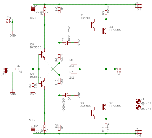

Hi rmqvs,
The schematic can be found here. http://web.vip.hr/pcb-design.vip/hiraga.html Scroll down to look for the new transistor version.
I substitute TIP3055/2955 with MJ4302/3281. Also swap 170/109 with 246/103 with no difference detected. Any comment? I can send you PCB drawing if you need one. This is my first PCB drawing, which Upupa have been kind enough to guide me through.

I use 550C/560C, better hfe but could do with any 550/560. MJ3281/4302 are from Onsemi. All resistors are metal film. Just build it and play around with the components. Maybe I got a bad ears that I can't hear much difference between different components. BTW, I prefer to build chipamp than class A amp. Just can't manage to get those bulky heatsink. Good luck!

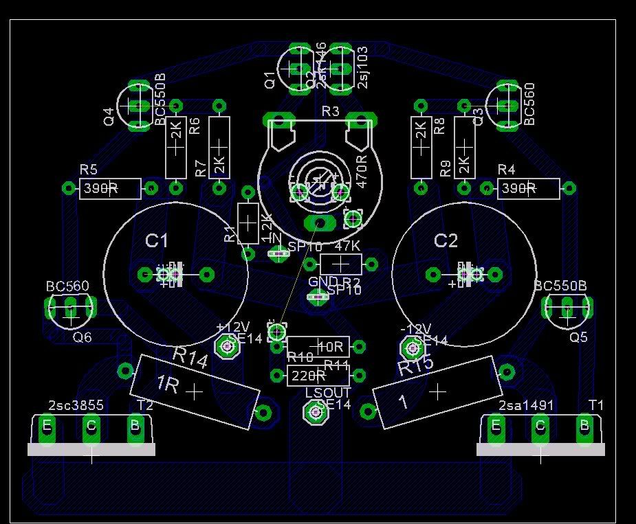

I've used Sanken 2sc3855/2sa1491 at outputs. Sounded better to my ears than tip2955/tip3055
This is with 2sk146/2sj103/bc550/bc560
my new pcb (not tested yet)
http://i29.photobucket.com/albums/c272/aqvrs1853/lemonstretransparent.jpg
http://i29.photobucket.com/albums/c272/aqvrs1853/lemonstrepcb.jpg
PCB needs one wire from 10ohms/220 ohms resistors to 470 ohms pot.
pls comment
