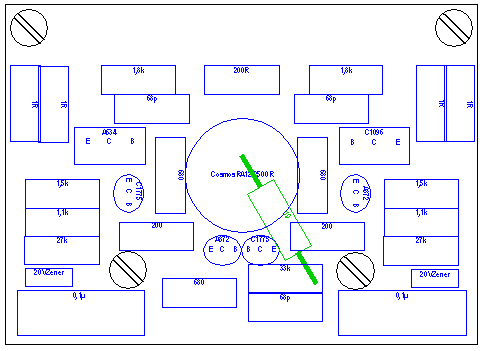

Use the modern PC layout , if I find them I will post it for you .
Regards

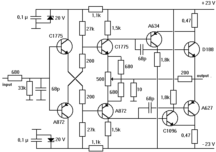

Here is the scematic and layout I use .
Please fix the layout in the paint program a bit .
Regards
