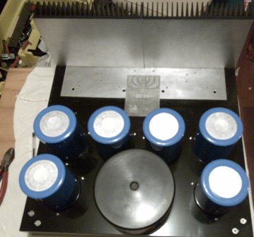

Hi all,
Finally some more work on the Hiraga amp......
After using and listening to it...
I have to admit wavebourn is right about the heatsinks/ orientation i was using, they are now going to be upright and larger.
The speaker protector i was using does not support large enough cable so i have a newer one with muting etc..
the PCBs and speaker protector will be mounted on top of the chassis per the original style which is easier to adjust when running.
Bias is too low at 0.7-0.8A i plan to increase to 2 amps or greater.
-Dan
pic of the different layout with spkr protection pcb laying in the centre.

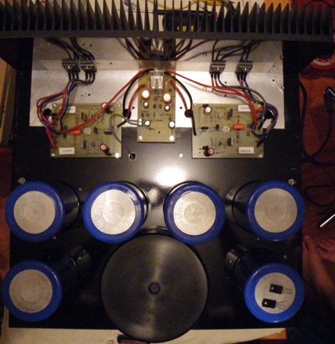

Hiraga Le Class A the journey continues....
In the holiday break, I did some work on the Hiraga Le class A amp...
I was trying to get it finished to take to my friends house in melbourne.
Spent from 7am until about 3pm on 26-12-08 working on the Hiraga amp..... (yes 8 hours straight...)

the saga continues.
See the pics attached :)
-Dan
I forgot to mention there is a lid for the pcbs etc which are on the top like the original version now. still tidying up the wiring a little and the heatsinks are mounted in similar orientation to the original too.

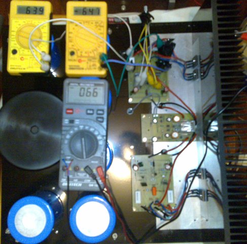

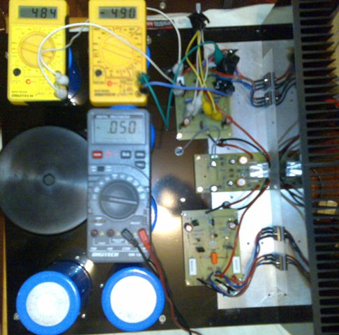

Did some more work on the amp today....
replacing all the transistors in the sick channel.
worked in the bias to see what level i can run
1.5A gave me about 50 degrees C (absolute)
1.75A gave me about 59 degrees C (absolute)
2A gave me about 62 degrees C (absolute)
All at an ambient temp of 31 degrees C...
See attached pic of horrible biasing setup(s) !
(mV/0.33 Ohm on the yellow meters, temp on the grey meter.)
-Dan

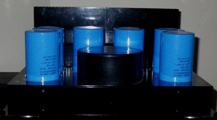

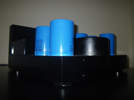

FINALLY WORKING!!!!!!!!
Hi all,
Replaced the popped transistors in the Le class A tonight and tidied up some wiring...
re- biased the amp and it is running....
i am running 1.5-1.6A bias and it runs at about 60 deg C once it is stable...........
IMO the sound is very good.
a few more pics attached.

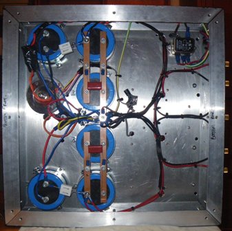

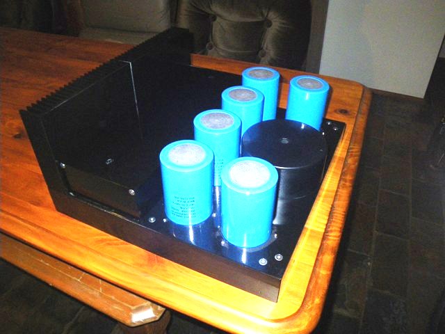

Hiraga 20 Watt class A
Nice thread gentlemen!
Just hauled an amp down from the attic last night that a friend of mine gave me - it sounded "ok" he said - but the reason I got it was to use the 8 fine Rifa 47000uF Electrolyts for other DIY projects. Then, while is was up on the attic, I took a look at it, and realised from the circuit layout that it looked like the Hiraga 20 Watt Class A amp. So down in the living room with it, dusted it off - plugged it in the mains and monitored dc offsett for about half an hour - then plugged in the speakers - result: nice smoth, airy soung - bass is there, but not very firm. Very good at resolution in the sense that it is easy to hear low level sounds between more powerfull sounds - i.e. other "background" instruments in an orchestra that easy gets "smeared". However, perspective seems limited compared the to 3886 chipamp I normally use.
Compaired with the pictures of circuits in this thread - it indeed IS the Hiraga Class A.
Trannie is crap (small, humming), heatsinks are small (uses a noisy fan) and there is an ugly protection circuit placed between output devices and speaker terminals. But the worst thing is looks like the constructor has compensated for the smallish heatsinks by running it at 0,5 A bias (0,22volt over 0.44R resistors) - and this is using +/- 28 volt of DC supply!
Actually I like the sound so muct that this amp should get a proper chassis (build on a wooden plate right now) and some proper heatsinks - that together with a larger Trannie should allow for some appropriate BIAS - hope that this will help on the soundstage issue...
