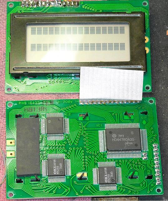

Here is all I get.
I don't think the display is the problem.
It should be compatible even though it is a few years old.
The Sony remote works.
The IR detector works.
There is no activity between the Arduino and the WM8741 board.
The LED on the Arduino blinks twice following reset.
I guess I have to find where the LED is blinked, and start blinking the led at various points in the code to see where it is going.

What happens if I pull the plug to the DAC? What indication should I get?
