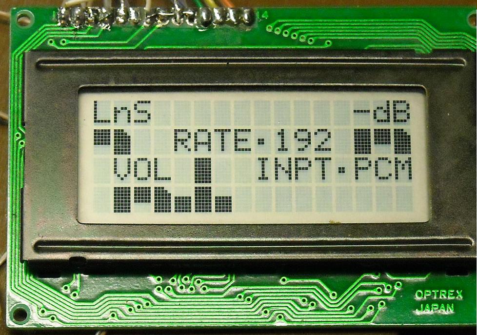

Both connectors on the Levelshifter were backwards. It wasn't just that the boards were upside down, the silkscreens were wrong.
Button on the rotary encoder works, but the encoder is erratic.
The display shows some weird block characters that change if I rotate the encoder, but do not follow a pattern.
USB data works, but S/PDIF does not.
Here is the display:
I tried a second display and got the same results, so I don't think it is the display.

Since you are getting stuff on the display that you would expect, I think the display and the display IF must be fine. If there was a problem there, you would get garbage.
There is code to support "large characters". I think it uses a lookup table that is supposed to be included. Maybe the large character code is causing those funny charaters?
You could try to comment it out, and see what happens.

Good Idea, although I was thinking they were possibly bar code information for the volume.
Hopefully I can comment out the large character calls.
It is definitely the large character codes. I can see which ones are which and they all map to the set.
I guess the issue is that I really don't know what should be on the display.

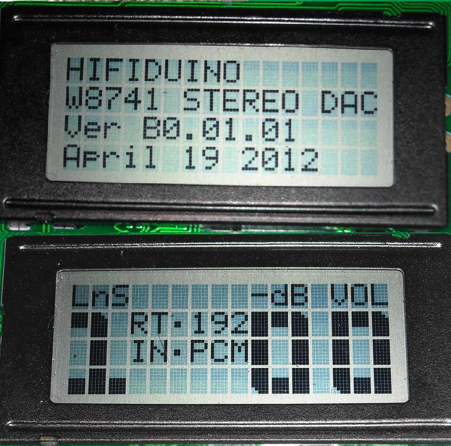

Have a look on my latest image I uploaded a page or two back - theres what you should expect on the LCD. As I see it you got everything but in the wrong places.
Have a look at these and experiment:
lcd.setCursor(col,row);
The code original code made me totally confused as parts seemed to be lcd.setCursor(row,col); which didn't fit my LCD.

There appear to be some changes between the HD44780A00 and the HD44780U versions.
I had to index at 0,0 and 1,0 for rows 1 and 2, and index at -4,2 and -4,3 for rows 3 and 4 to get the display to align.
Then I had to add -4 and -8 off sets to the two row indices.
Looks like it will run with the 16X4 display although it is a bit tight.
All this will be tossed when a proper 20X4 display arrives, but I can play with it now and I'm learning the code so all is not in vain.
