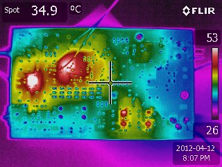

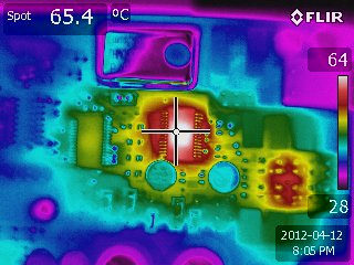

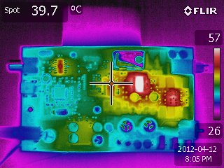

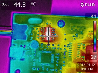

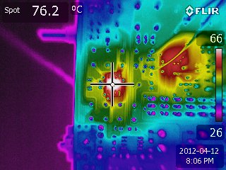

Thermal Map of DAC Board
Hopefully the images are self explanatory.
Input voltage to the board is 6.050V at 222mA.
I was surprised at the hex inverter.

But you should really check out why your OPA2365 is so freaking hot!
