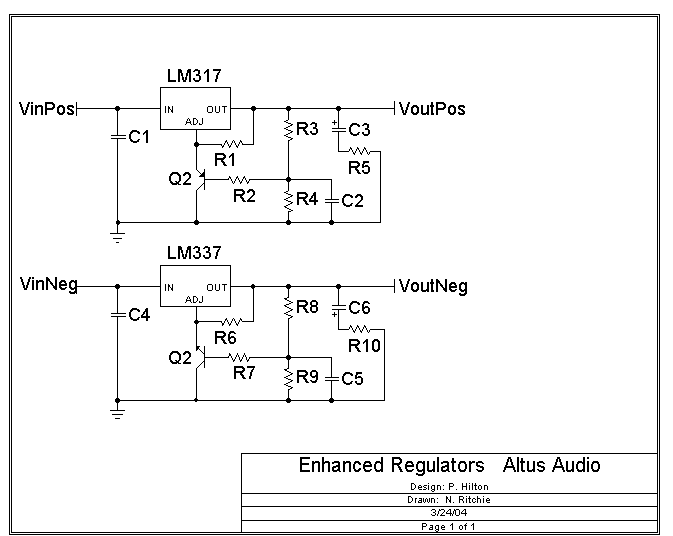

I would definitely favor regulated/capmulti power for this device regardless of whatever advertisements there may be as to power rejection figures of op-amps, because the truth is that, where there is gain, you've either got capmulti or noise. Well, I think it important for a hi-fi tone amp to have the cleanest power and ground imaginable--these references are of equal importance to the audio circuit. In regards to the power circuit, we could end up with a very beautiful tone amp, or something else.

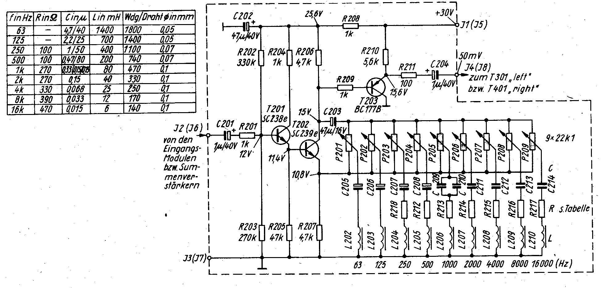

The frequencies of the original palette and the range of boost/cut are well chosen. They come close to the ones you list as well. It is worth looking closely.
It is bad. Very bad, actually. The distortion from LDR's makes anything else look harmless. This can be offset using complex bridge arrangements, but complexity is drastic.
Gain before the tone control presents an overload margin issue. Even if we do not expect sources to be higher than 4V RMS (many pro-ones are higher) usual rail voltages severely limit the gain we can place here.
Also, the whole point of this thread is to precisely avoid the effects of common tone controls, while retaining their functions.

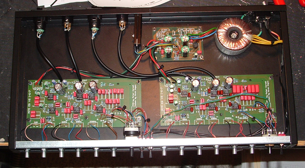

Details of a DIY NitePro clone are here:
Nite - EQ3D
However, your suggestions in my view entirely miss the point of the discussion here and to take much of them on board would meant to accept significantly lower available fidelity for the result than desired. In fact much of what you suggest would have been unacceptable in the 80's when I designed studio electronics for the east german state radio/TV.
And the designs we used and created (they fell under the RFZ banner but where mostly created by small companies) have as I have noticed recently acquired cult following among recordists. it seems someone lucked into a fairly large pile of the stuff. Seem I was wrong when I thought the gear that was ripped out of the studio very early on in the german re-unification was scrapped and dropped into landfills, seems someone rescued it and stored it...
I would suggest to re-read the whole thread and possibly also the originating one about the "Blowtorch" preamplifier by John Curl, Bob Crump and Carl Thompson and about the original Cello Palette as part of the Audio Suite, to get a feel where this is aimed.
The original palette for example used 61-Position rotary switches with individual resistors for each control (including EQ) and fully discrete, largely J-Fet based Transconductance Operational Amplifiers.
A picture of the insides of the original is here:
The aim to keep as much of the aspirations of high quality of these types of products, but to provide a way to actually make these "DIY productable" and more accessible, as true clones are not doable.

Okay, I think we should consider this boiled down.
1) Everyone wants different active electronics and I doubt we can ever get agreement. This suggests a purely passive circuit.
2) I am sure if we can conjure up something, however I am not 100% sure that we can rely on using potentiometers.
I am sure we can implement the needed filters with T-Circuits, Cinema/Langevin style, but something a bit less complex without needing inductors and ton's of decks would be better.
If we stick to parallel passive James/Baxandall Filters then we can retain the option for 10K log (type B not type A) potentiometers.
For some estimates, this would produce around 1.5K input impedance at mid/high frequencies, controls flat with some variation when controls are adjusted. We could include an optional buffer (op-amp or other) for the very low LF bands where most of the impedance drop happens. Output impedance would be even lower, < 1K.
So the circuits self-noise would probably be around -125dBV (unweighted) with an insertion loss of around 24dB, so noise cannot be better -101dBV if the "re-gain" Amp is noiseless. This is not great for SNR, however in the other thread I argued that "extreme" SNR figures have little real-world benefit, so it is probably okay.

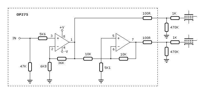

Given the impedances and levels etc. the input needs buffering capable of driving a few 100 ohm with little concern of very low noise low noise.
The output needs a suitable low noise Amp with a gain of around 24dB and less than 4nV|/Hz or -125dBV Ein noise and greater than or equal to 10K input impedance and output drive capabilities as needed for the application. This will be a touch difficult to do with tubes, no problems is using hybrid or solid state.
So we may still want to retain a few Op-Amp Footprints for DIP and SMD (use optional) on the PCB and a few buffer components (use optional) anyway, plus perhaps the "Paris Hilton/Nicole Richie enhanced 3-Pin Regulator" for powersupply, CRC filtering before the regs and discrete diodes..
So a PCB can be used with these positions filled and a choice of fidelity levels by actually selecting Regulator IC's, Rectifier diodes, Capacitors and Op-Amp's (plus buffer/no buffer) will be up to the builder, with a wide range of options.
We could even include options for a level (Volume) control around the output Op-Amp (see my post in the other thread) and optional gain and even attenuation for the input section.
Then the whole PCB could be bolted into a case to produce something akin to the Palette Preamp, single-ended in, single-ended out and with similar noise levels to Douglas Self's latest contraptions at similar gain levels (e.g. theoretically -118dBV output noise for -20dB gain) and have line input and output transformers added for balanced/pro options.
Using the right quality of components should give excellent fidelity for most uses, as only two stages are needed, one at notional unity and one to offer gain up to 40dB (if +16dB maximum gain are desired). Using an OPA827 0.001% THD20 for 3V into 600 Ohm can be attained.
Special requirements could be met using off-board electronics (Tubes etc.).

It is Thorsten's project, but I'd probably want to build one. I'm hoping for low loss even if that means a few more op-amps to solder. He and I agreed on most of the critical aspects, and for that I'm grateful.
P.S. If you favor balanced, here's a good sounding little thing with a fet input:

What is a "Paris Hilton/Nicole Richie enhanced 3-Pin Regulator" for powersupply"?? That's Interesting! Cct, please?

Back in East Germany one of the products we had was a graphic 10-Band Equaliser, fully discrete and with only 3 Transistors per channel. This EQ is still justly famous and more than 20 Years after it ceased production is greatly sought after.
So everything should be as simple as possible but no simpler.
Ciao T
PS, attached is the 9-band version of the east german EQ I referenced above... It should be noted also that this EQ is "zero feedback as well, not just minimal and LC based...
The inductors for the lower bands may be replaced by Gyrators (the HF ones are available) and of course the old Bipolar transistors (read BC for SC) can be in part at least replaced by J-Fets.
This could be called "ZenEQ" aka ZEQ and should sit well with the crowd over at the Pass section.
It should be equally clear that the circuit may be directly translated to zero feedback tube circuitry, however it is imperative that it be designed as either Tube or Solid state (or Hybrid) circuit ground-up, so it means choices for circutry must be made or the project must be forked into a Tube and a Solid State Fork.

However, I think the NitePro EQ3D clone that I have linked to previously would probably suit your requirements quite well and let you indulge in op-amp rolling and tweaking. It includes PCB design for mono channels and all other needed details, the OpAmp's are indeed used in parallel, a reasonable amount of effort has been applied to the power-supply, so if you simply adjust the circuit to match the frequencies you want you can just build it, use whatever op-amp you like and be done.
Here an actual, build-up example:
click for more
I personally would not consider this approach however, or if at all then only as the absolute last resort. Chances are I'd rather put up with Waves REQ6 loaded onto my PC...
