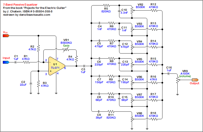

You could post a direct link to your circuit.
http://ianamillar.com/blog/wp-content/uploads/Loudness-Circuit.gif
http://ianamillar.com/blog/wp-content/uploads/LoudnessEstimates.jpg
It is very similar to the one found in McIntosh gear. It works quite okay, but it has a major drawback. There is no direct link to SPL, so you need to set this control by guesswork.
I would propose that it is preferable to integrate the physiolgical correction and volume control into one circuit and to add a separate gain control that allows the system gain.
My homegrown 1980's control centre had input gain controls (and a set of VU Meters to set them right - VU Meters read average loudness) and several selectable outputs with output gain controls to drive different Amplifier/Speaker systems.
The Volume control was based on the original circuit of the physiologically equalised Eckmiller fader, but implemented with a 40 Position rotary switch...
Output gain was set with the volume control at "0dB" (it went to +14dB IIRC) and an SPL of 85dB with pink noise. Input gain controls where set for peaks to 0dB VU with music program and needed adjustment for example between different Radio Stations.
An example of a studio level control with physiological equalisation can be seen in the Neumann W482ST which can be found here:
Vintage german modules (Neumann, Siemens, TAB, IRT, Lawo, ANT, Eckmiller, Adis, Monitora and Telefunken modules and Braunbuch scans)
The levels and EQ as set on the W482ST are shown here:
The Neumann W482ST was still produced in the mid 90's and used by the publicly funded Radio & TV in Germany...
Ciao T
You can look at the F-M or R-D equal loudness profiles and provide a simple analogue passive loudness compensation network around a standard (non center-tapped) pot in each channel to do something "close enough". With a little (actually big) help from a scientist on another forum, I did it. It is absolutely fantastic and doesn't even need a switch.

It would not be an exact clone. The original Palette uses paralleled active filters with discrete Opa's (if I am right they look a little like the JC-2 linestage), a very large number of them.
The original palette also uses these gorgeous 60 or so position switches for the Controls, these are next to impossible to replace.
The "lower range" Palette Preamp used normal pots and chip Op-Amp's, tons of them. Detailed schematics are not available in public domain.
So direct clones are not on.
What can be done are functional clones, that is an EQ with six rotary controls that has similar slopes and boost/cut ranges, with or without included preamp options.
For this we need to decide if we want a "High End" version (rotary switches, discrete circuitry, maybe valves) or a "Budget" version (pots and IC Op-Amp), or something that is not so much a concrete project but more just principle designs.
The cost of six Elma or similar switches is not small, but reasonable. Using these we get 11 cut and 11 boost positions.
We could use 2dB steps for Lowest and Highest Frequencies, 1dB for the intermediate bands and 0.5dB for the midrange bands. These kind of steps do make sense, together with the frequencies.
The cost of six high grade stereo potentiometers is not small either, but we get continuously adjustable adjustment.
Just for reasons of extremism, we could even make the whole network wholly passive, around 24dB attenuation, "massive-passive" style and leave the selection of the output Amp that will produce 24dB of low noise gain to the user, to taste. Could be a NE5532, discrete, even tubes.
I can help a little with a single such project, but I'm a bit short of time, so others would have to chip in on the electronic design legwork.
Ciao T

My personal take would a passive James/Baxandall control using 10K Log Pots (easy to get) with resistors on switches optional. It will need a input buffer that can drive reasonably low impedances, however this can use any number of circuits that people like, no limits on technology.
We could include footprints for Op-Amp with BJT/Fet Buffer for the input and re-gain Amp on board and have optional "unbuffered" in's and outs for use with external circuits.
The issue is that the passive tonestack plus low noise "re-gain" amplifier limits our output noise to around -100dBU (unweighted) if I calculate right, we would need to run this through Tina or another sim to be sure. If we place the Volume Control after the EQ section the noise should be less of an issue, but that can get us into trouble with overload margins on the input.
If we go for an active EQ we can lower noise a bit more, if we go to 1K pots, like D. Self in his article we could get similar noise levels (-113dBU) as he has. The problem is that active circuitry limits our degrees of design freedom as we now need to design the Op-Amp's into the circuit, tubes are pretty much out.

My main concern with this style is that we must daisychain six Op-Amp's to get six bands.
One could of ource run the bands in parallel, even on one Op-Amp, if we make sure to buffer some of the bands. Or we could go straight to the LCR based Baxandall style like the Urei 437 EQ:
http://www.waltzingbear.com/Schematics/Urei/537.JPG
On the other hand there are other types of parallel EQ's like those used in the discontinued NTI Nightpro EQ3D, schematics for which can be found in the public domain. Here a review by Sound on Sound:
NTI Nightpro EQ3D
If we look again at the daisychained Baxandall, there is no reason why we cannot connect all bands in parallel. If we do so, we can only transform them to the passive versions.
Finally, we may use an extreme "passive" style like shown in the attached guitar EQ...
Ciao T
NTI Nightpro EQ3D
Ciao T
