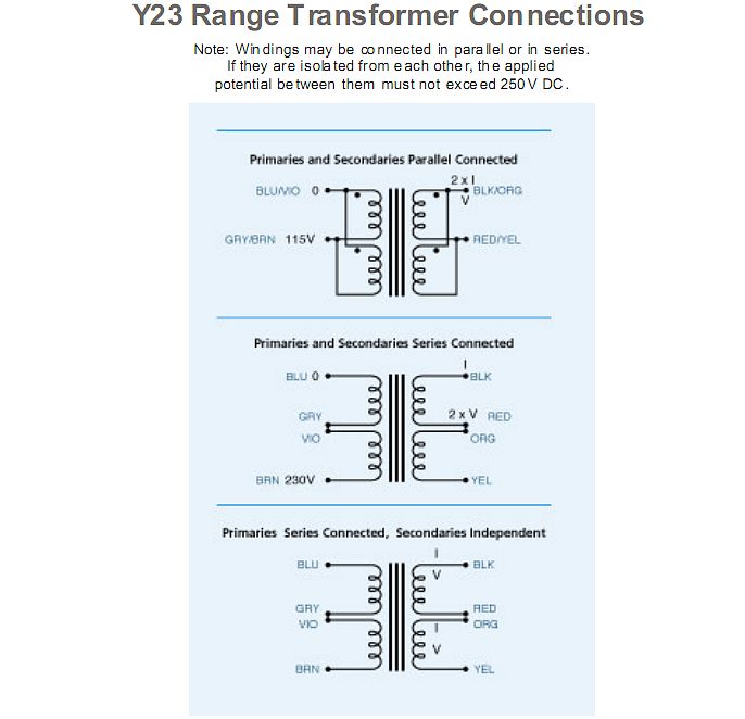

Okay forgive me for being a noob, but I've got a question. While I'm waiting for my replacement T4 I thought to construct a simple rectifier so I could connect to DC instead of AC. This by using a 25A 50V rectifier and a couple of 22000uF 100V Philips caps I have. So I connected my 33V downsized toroid to the rectifier and attached three of the caps to the poles of the rectifier. Then I measured the voltage being 90V !!! Unloaded. Is this correct or am I forgetting something? Yes yes I'm a beginner with small steps in the wonderful world of DIY amps...

Make sure you are measuring AC with AC Volts setting and DC with DC volts setting on the voltimeter and at the right place on the rectifier, AC where you see ~ and DC for + -

Also, 33 v AC * 1.414 = 46.662 VDC, add maybe 1 volt for the caps if necessary, you should be about 47-48 volts rectified DC.
Yes I do but after the caps it gets this high! Are the caps building up the voltage near their max voltage capacity?

Well I was about to take the picture but I measured on a couple of places and am confused now.
34VAC > ~ input rectifier side > + rectifier pole > + pole capacitors
0VAC(not used)
34VAC > ~ input rectifier side > - rectifier pole > - pole capacitors
So at the rectifier poles I measure 54 volts and at the last capacitor pole I measure about 90 volts.

I think you have the secondary (output wires) wires of the transformer hooked up wrong.
If you have dual secondaries (four wires), then the "0" wires should be on one ~ pole and the "34" on the other ~.
If you have one secondary (three wires) winding with a center tap "0", then this center tap must be on one ~ pole and the other 2 wires on the other ~ pole.
If NOT, then when you measure you would be capturing the additive voltage 34 + 0 + 34 = 68 VAC * 1.414 (rectification) = 96 + VDC.

I have five wires. 2 times 34 VAC, 2 times 18 VAC and one 0 VAC.
So I have to wire the two 34 VAC together on one ~ pole and the 0 VAC to the other one?

This may help, I use the Avel transformers and connect the secondaries together. Look at the top config in this photo, it may make it clear. It would help if you know the wiring configuration of your transformer.
Anyhow, don't hook up anything but the rectifier to it and get the correct voltage. This way you will not blow anything up.
