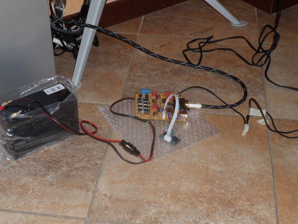

Hi after numerous tests I/you/they have reached the following configurazione:Exit directed without condesatori but two resistances by 1khom no upsampling plays more disposition, battery feeding 12 v 9 amperes entry coax in how much optic it doesn't accept 24bit 192khz (file HD TRACS Flac),Panoramica my impianto:rising mediacenter no compromises (30 kgs) Card audio asus d2x in coax DAC as above, gone out in a form type LAMPIZZATOR (made nel1997) with 2 6c4 as tubi.Poi in pre computer Yamaha (everything modified in more points) cossover electronic 3 streets BEHRINGER (Deeply modified Aliment,condens,filtraggio,ecc..) 3 amplifiers to vavole of my realization No Compromises Low Push pull el 84 2 looms 25KG,Medi Single ended "2a3+6135 20kg exceptional would like us varied pages for descriverlo,ALTI Single ended El84 Á triodo+6c4 12kg Boxes also them from me you realize 110 liters pneumatic suspension wf Cleveland 30 French cm(Copias ALTEC 414W) middle FAITAL HF 140(ITALIANO!) loaded to trumpet TRACTIX Always Faital, Tall Beyma CP 25 to trumpet a lot of thick musicale,usato for the tall part KLIPSH Her SCALA,Quindi while you srcivo I am listening to the DAC and my impressions a lot of sono:sound "vinyl" Range middle uproarious tall sweets no hard, detteglio and resolution a lot of elevata,Bassi good articulated but Not PROFONDISSIMI,iBURR BROWN type 1796 (ASUS D2X opa lm4562lm) more presents play and mighty as soon as I am able I put the photos hi

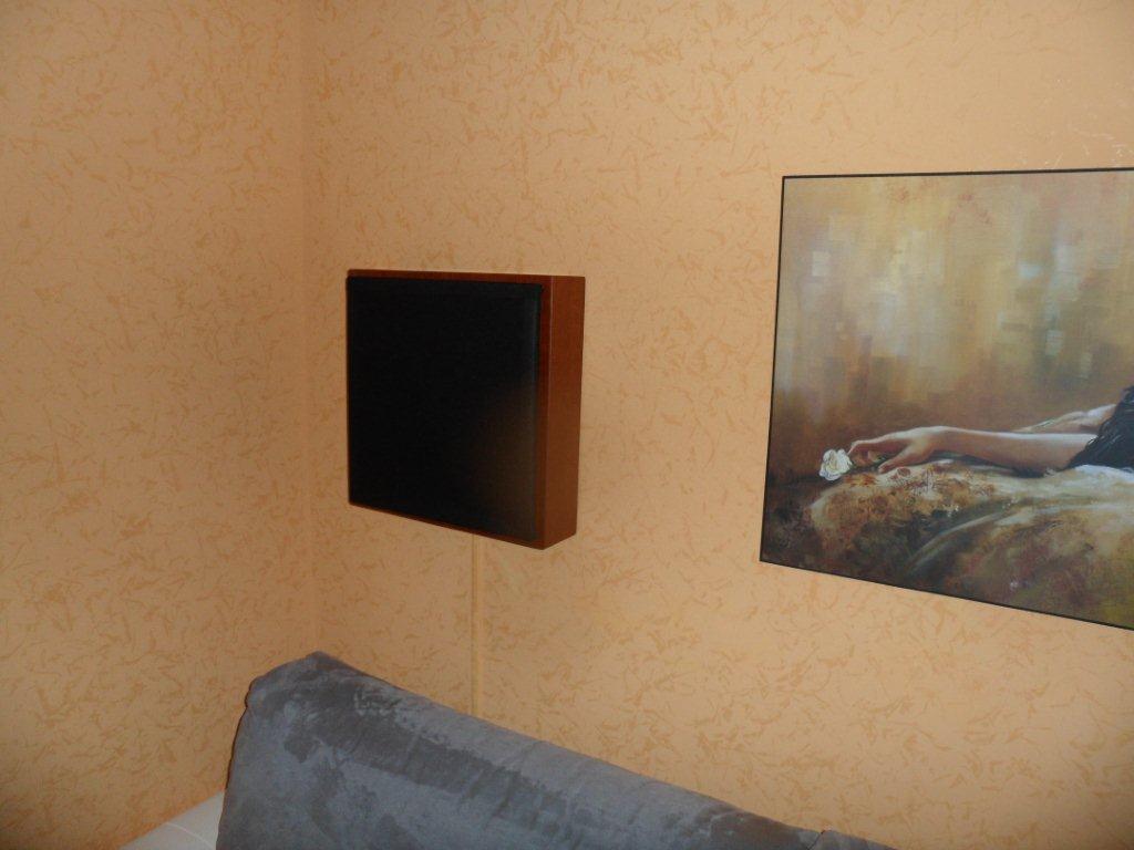

Thanks so much for the suggestions of load photo MOOLY!Nons are very practical of BLOG MI I excuse for my English but me I don't know The English use a translation program I hope realizes me comunque.LA photo of the boxes and without the Drive of the Middle ones because they are in change Imagine supports them to you with the trumpets on the boxes Hi
