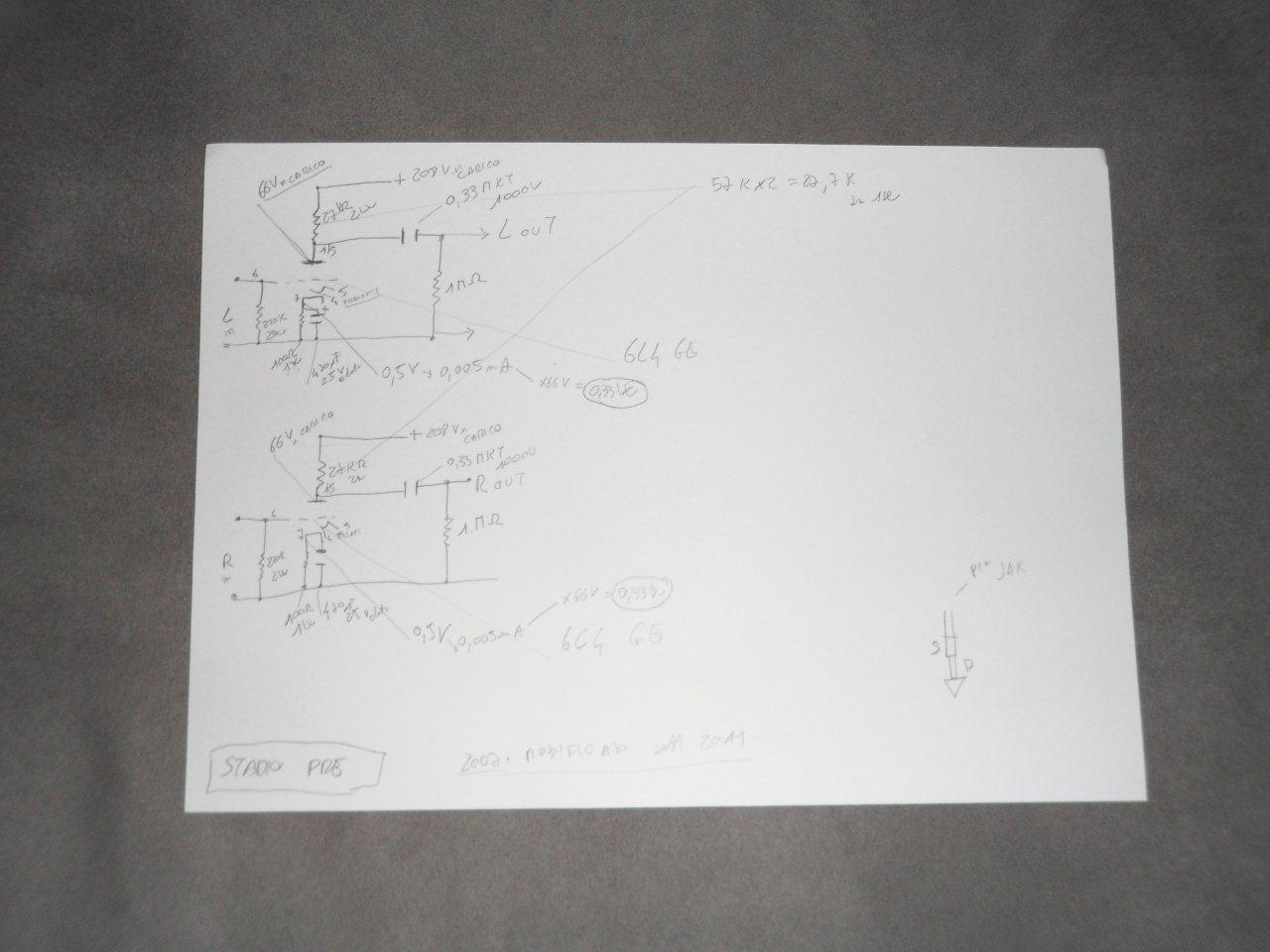

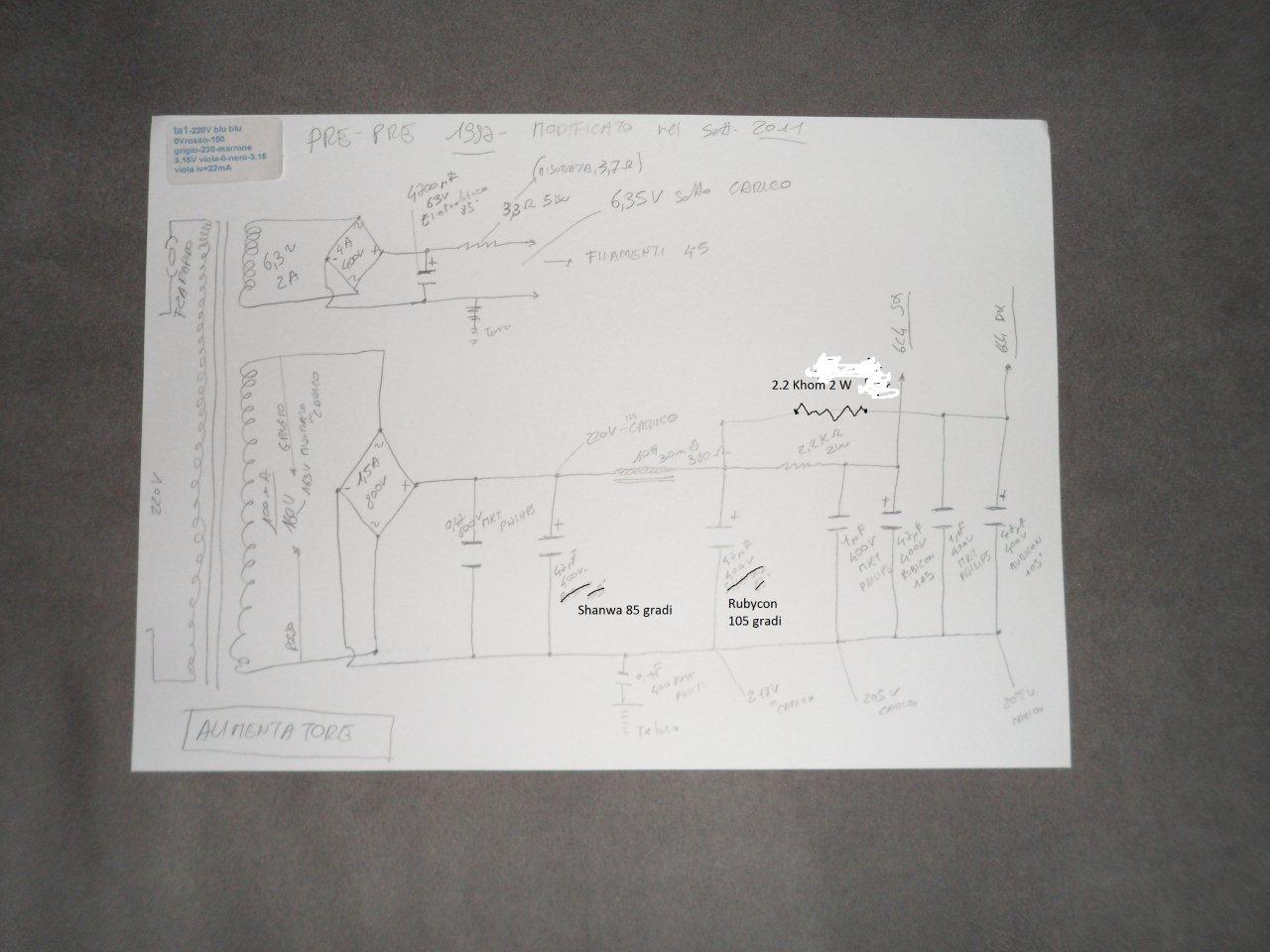

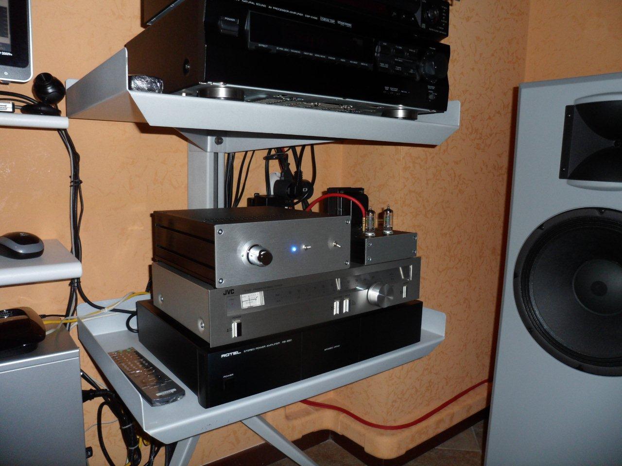

IMAGE LAMPIZZATOR BY NYKY

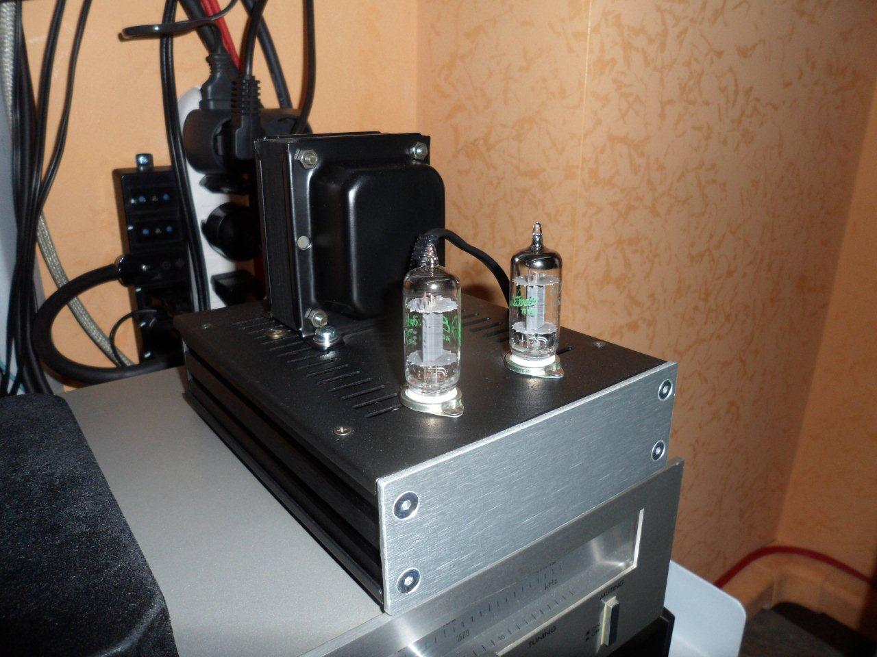

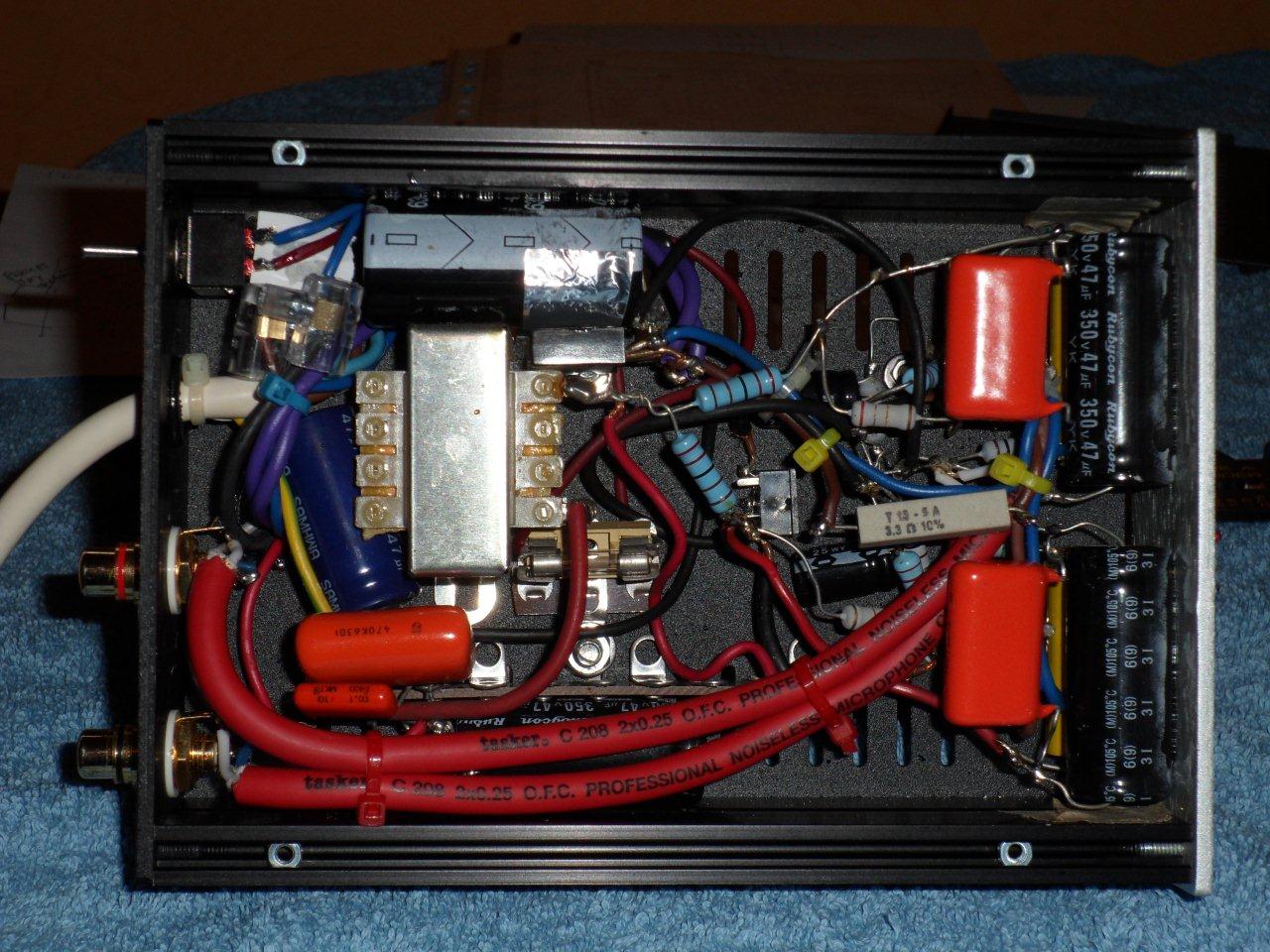

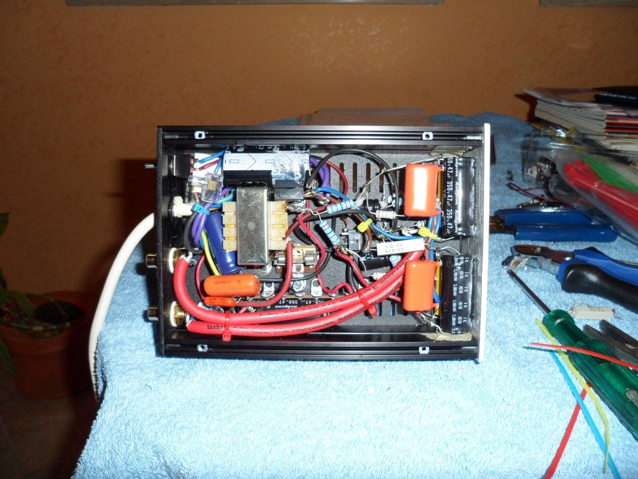

I attach photo of My LAMPIZZATOR used for the DAC, they are also there the schemi,guadagnos(GAIN) very low 1:1 even if he/she forces to hold the volume to -8db in entry (Foobar) otherwise Saturated entry, Sound ECCEZZIONALE,TRASPARENTE, from FARE,valvole to be used 6135 GE 5 stars (BEST),o 6c4 GE, for information make to know me hi

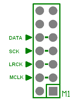

I working on a project which include this Direct Out DAC (can't wait to buy it !) And I would like to know if we can directly connect an I2S input ? It seems that the question has been already asked, but I haven't find any clear answer in this thread. And Google won't help me on this task :)
In my case it would be to connect a Raspberry Pi (I2S output via GPIO pins and some hardware). So, is it possible ?

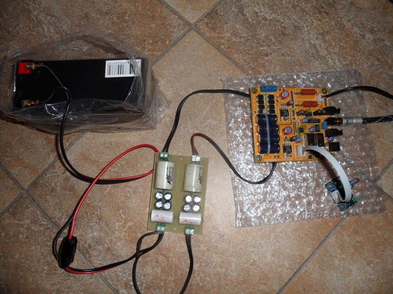

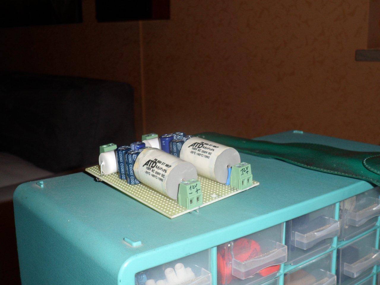

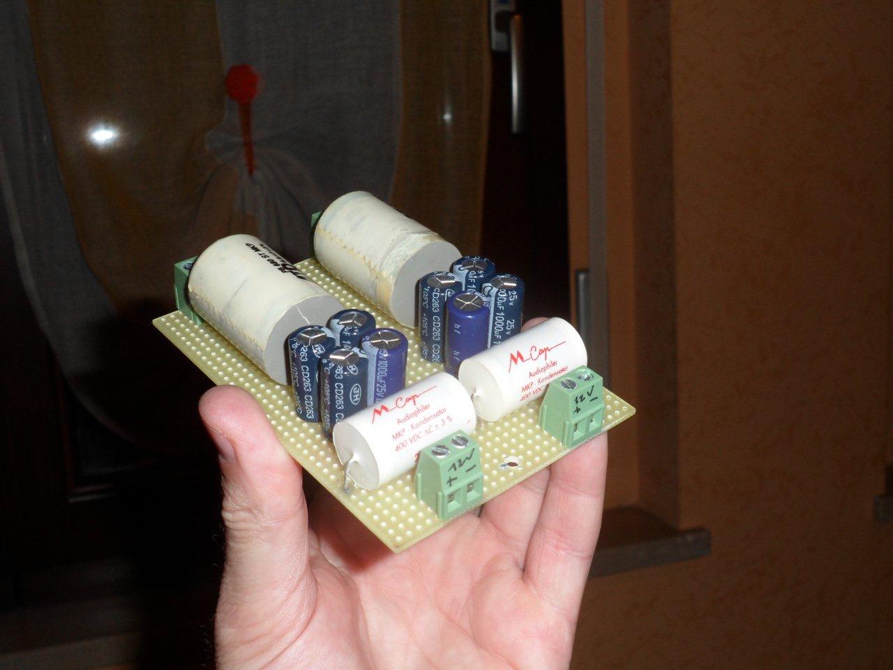

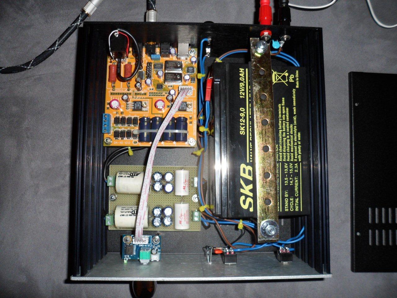

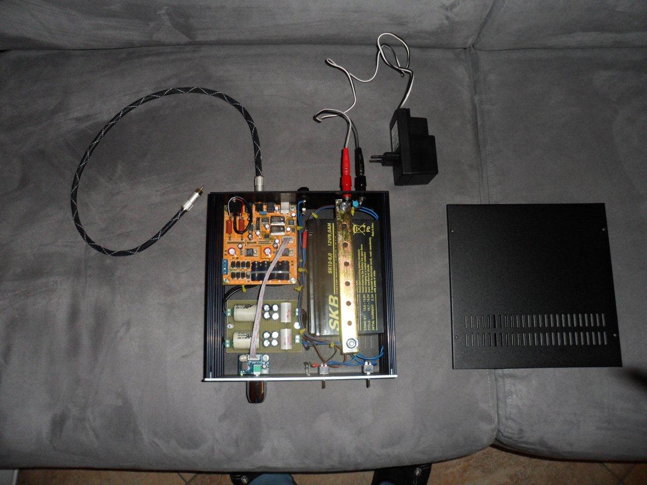

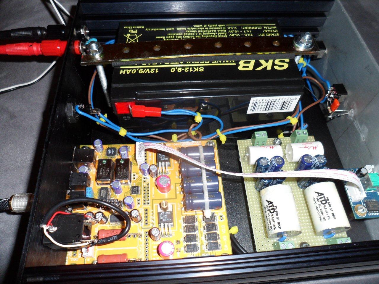

Ciao,il my DAC strongly evolves him with a form of condesatori MKP+ Elettrlitici for disaccoppiare the Analogical Digital part and to lower the impedance of the battery, the sound times is very More transparent low very articulated bello,Si can also use with transformer feeding. For your curiosity the Battery after 12H Plays anchors!!! V5 OK,V3,3 OK
Hi, yes you can try the I2S to M1 connector. And signals show below. Remenber to remove the upsampling module or jumpers on M1, and keep I2S cable as short as you can. And do not plug it when poweron. The I2S signal will directly go to CS4398.
BTW, keep JP2 open to select PCM mode.

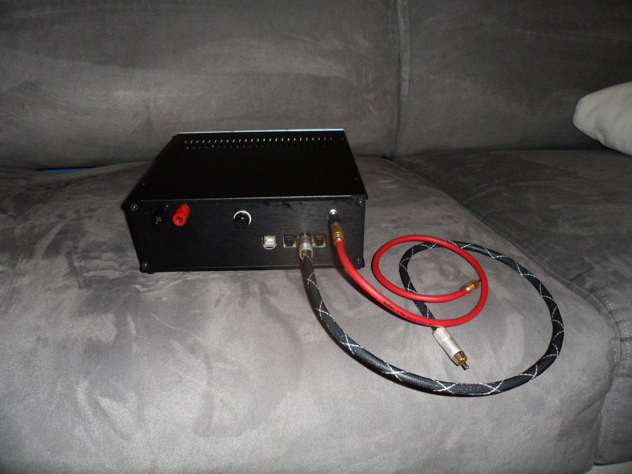

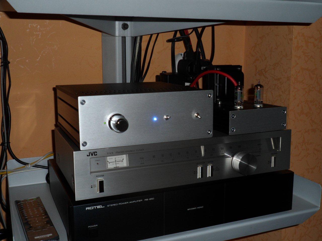

Hi, verdict: AsusD2x (digital coax) + Dac to battery +6135 (6C4) sound, exceptionally middle vinyl! Amazing range, voices very real natural, low laodness no!:)

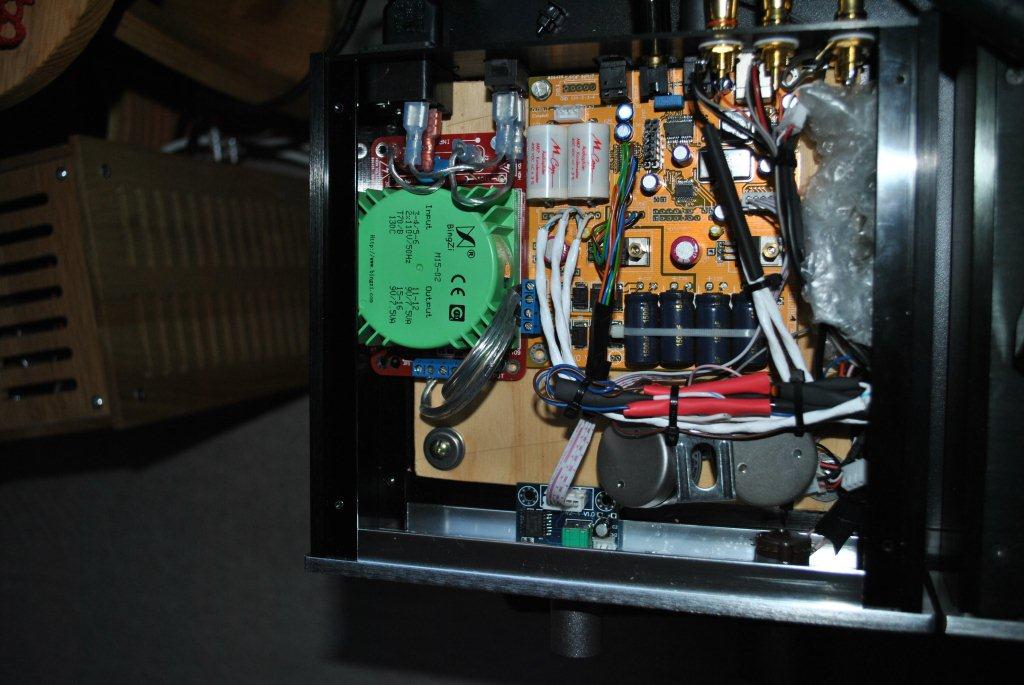

Hi to all...

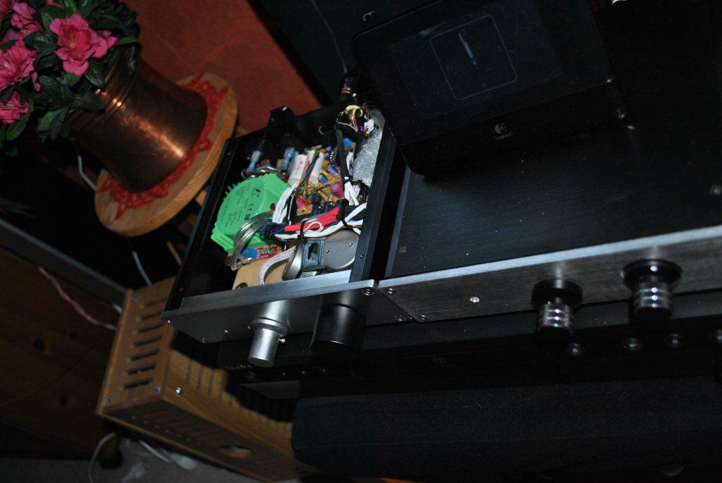

Got my VERY good sounding dac up and running again --- had some serious silly difficulties with it in the pre-christmas time --- but with very good help from hifimediy-staff(Steinar etc) it is now really exploring my music again! And I got some Sowther-trafos to have some more gain from the balanced output. And if possibly - it is even more dynamic and revealing! My B1 need some gain to drive my home-made SIT(about 8watt) - to full-scale on the Alpair12P!
But again - grateful for help to resolve my difficulties!!
Some pics from my Direct-Dac and my Christmas-SetUp(move to a more permanent place soon)!
Best to all!
Happy New Year
Olav
