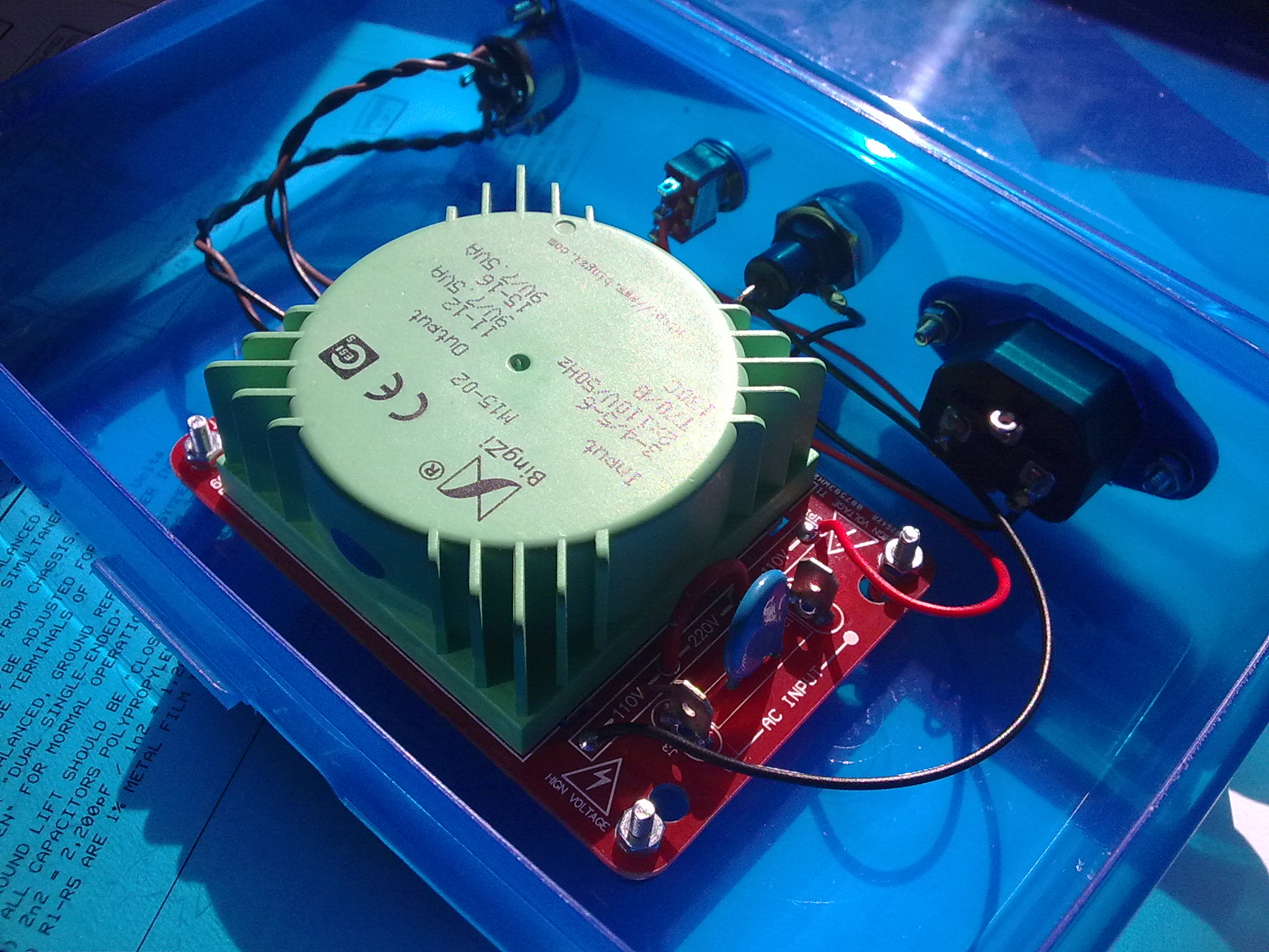

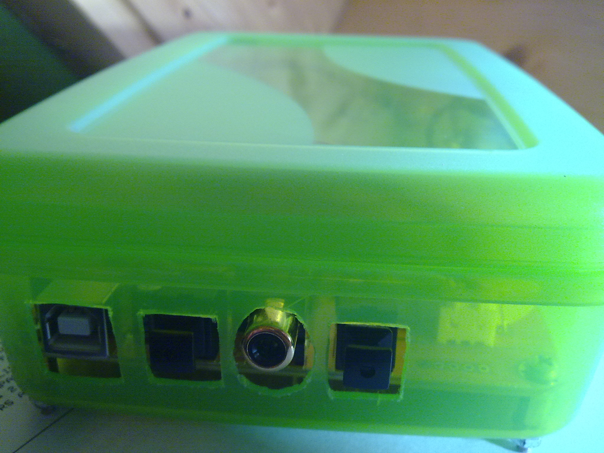

As I plan my enclosure, I intend to mount 4 RCA's on the back, 2 for "coupled" and 2 for "direct out".. That way I can easily choose, depending on which pre/power amp I want to use :)
Is it ok to leave Zero volts (GND) floating?? Or must it be tied to Chasis-Earth??
CM
The GND of RCA is better to be floating to chassis-earth but connected to GND on board, and choose a ground point on board connect directly to chassis.

What about those on here I have seen using plastic cases?? What do they do??
Ta
CM
