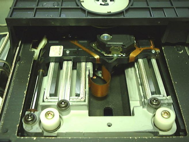

I do really like the KSS-270A in the CDP-X55ES as it's been the best performer I've had with amazing tracking ability.
I don't think I've ever seen one. Is that the one in the high end Sony ES with the die cast transport and the feed motor that fails (or gears)? The one I'm thinking of is a DVD / CD unit.
-Chris
It's an older ES CD player from around 1991. No gears etc as it's linear motor tracking. A thing of beauty to watch in action.... so smooth, so quick.
Searched for over 10 years to find a good CDP-X55ES.
The pic is in a different model but basically the same.

Hi rabbitz,
That is one of the better mechanisms for sure! It's a newer head than I was familiar with, but the same concept. Very fast and silent. I wouldn't mind rebuilding one of those for experimenting and another for the bedroom.
-Chris

anatech said:
Hi rabbitz,
-Chris
It's a shame I can't find any spare lasers. The laser had been changed just prior to my purchase of the player so should last a long time.
Most of my players are KSS-240A based so no sourcing problems. My original CDP-990 from 1991 still has the original laser and still going strong after continual use in that period. I think that was a golden era for CD players before the bean counters stepped in. All my more recent players either didn't last long or of poor build quality.

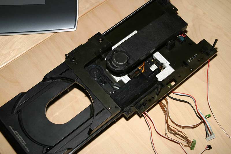

Do you guys think all these Philips CD transports are bad even the recent models like this one from: http://www.diy-high-end.com ?
I was about to start thinking about building myself a transport with this gear but you put me on hold a bit. I could use some balanced advise on the later models (CDpro2 and LF etc). Positive experience is just as welcome by the way. I really like to have an objective view in the end. (if that's possibe...)

Hi Malcolm,
That looks like it has the upgraded magnetic clamp! Yes, use it!
