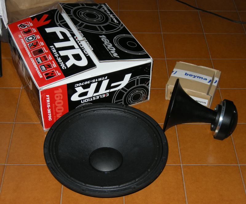

As first test I will try to use the Celestion FTR15-3070C that is a glass fibre impregnated cones and these should be on the way.
I see you love paper cone but what you think about fiber glass and kevlar and carbon.
In some case this is true, many people love the first version of Proac louspeakers because this use normal Scan Speak paper cone and not new cones with kevlar, PP or cabon.
I have considered in the simulation for the Celestion woofer the Mmd and not the Mmt, this is an error
I need to recalculate the volume and box design.

You should use Mmt which is Mmd + Mair.
Regards
The Doc

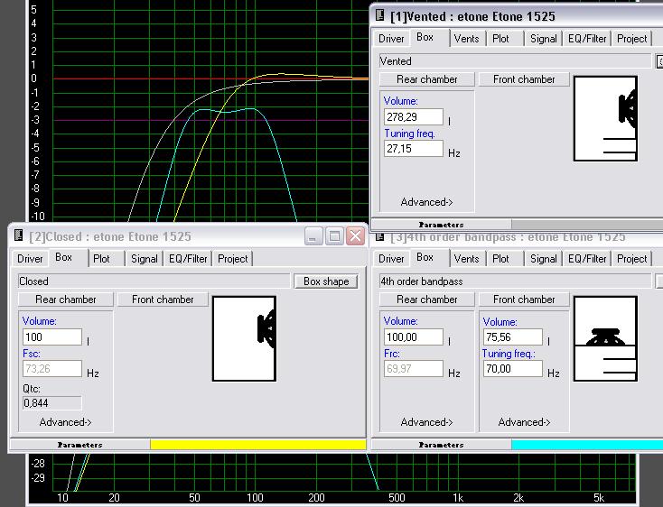

I find this driver interesting: Etone 1525. It's made in Australia and sold for AUD109. I've got two of them currently under testing and evaluation. On software simulation I compared it with many drivers and I have to say it's not bad and hard to find a better one in the LF for the buck.
Here the parameters:
FS=27.155 (28.2 measured myself out of the box)
Sd=855
Voice Coil diam=63mm
Re=6.1R
Qms=14.039
Qes=0.329
Qts=0.322
BL=14.1 T.M.
Vas=564.099l
SPL=97.2dB
Mms=63.259g
Md=95g
Le=??????? waiting from the manufacturer so I don't know about the top end yet
Please give me your opinion on simulation.
Alfonso

The manufacturer is very friendly and he is able to build a custom one starting from 1525 base. One thing I find in common with all 15" I tried: there are chaotic waves in the high part of the frequency spectrum coming out of the centre coil under the dust cap. I will try to design a phase plug for this driver and the manufacturer will prepare a new one without the dust cap.
Nice speaker and price.
Only BR 280liter 40Hz 97dB very big
Best option closed. 100liter 63Hz 97dB Q=0,8 reasonable size.
Or 4th order bandpass 175liter 40-126hz 95dB Q=0,8. Nice low and good XO point.
High QMS sound better was a topic lately then this driver sounds superb. QMS=14
Regards Helmuth
