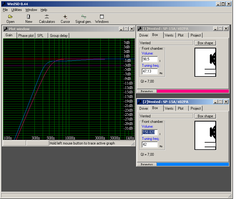

I have this exceel file on the net where I have loaded the Monacor parameters but if I set the same configuration on WinISD I get a strange result and a little bit different from a normal bass-reflex
http://www.audiodesignguide.com/HiEff/ONKEN_SP-15A-402PA.xls
Is this right ?
What I have using Onken box ? more bass ?
Is this right ?
A simulation is a indication and is as good as the model used. And the parameters added.
With win isd you can choose also _3dB extended bass shelf response. This means a other Vb and port frequency. To get extended bass response with 3 dB loss of efficiency.
With winisd you can play with Volume of the box and frequency of the pipe and see what that means for the response.

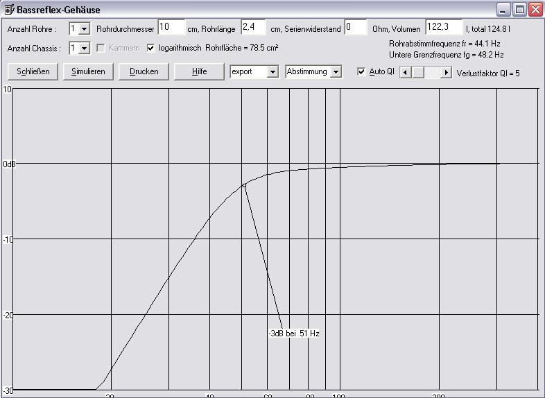

audiodesign said:Helmuth,
is this for a normal bass-reflex (max flat) or an Onken ?
The program choosed the best result it self.
With max flat it came on with. 91liter and -3dB at 56Hz.

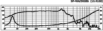

Man, take a look at this 18" SP-46/500BS
http://www.monacor.dk/produkter/hoejttalerenheder-pa15-18/vnr/104100/
its smooth as a whistle to just above 1khz
Theres just a tiny little whiggle above that, looks like nothing
Well,, it could easily have been cut, and its peak may actually go 10db further up
I dont expect anyone would believe any of this
But close to 373EUR is way too much
No matter what the "BS" stands fore, it could actually be a fine woofer...but I dont trust them, so I dont buy it
You can judge a bit by specs, but in the end you need personal real time experience with a driver to make any real valid judgement
Its first AFTER its mounted in the box and with proper xo, tweeter and all, that its possible say anything fore real

You can't believe it but did you ever try a monacor and measure it, to check the results.
It is the question if the response is made smooth by measuring software or the writing speed of a plotter (if they still exist).
Monacor seems to be quite sloppy with their measuring data it is hard to tell what the graphic is really worth.

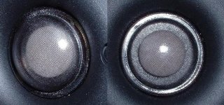

Maybe a idea for this project audiodesign.
A DT-300 with wave guide WG-300.
distortion.
