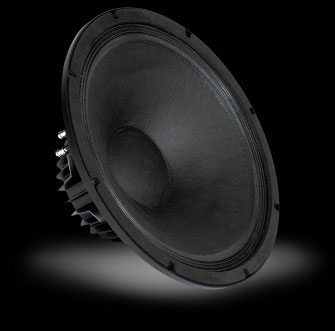

I am searching fo this project a a 15" with
- a linear frequency band until 3-4KHz to prevent problem after the crossover frequency
- a moving mass no more than 90 gr
- a sensitivity near to 100dB
- a low resonant Frequency to have a good bass frequency band
I have found only the drivers analized in the webpage.
If there is a peak in the frequency response it is possible to esclude this only with 18dB or 24dB order filter because with a common 12dB this will keep in voice band.

All those things together? And perhaps also into a " cheap" woofer ?
Anyway, becoming serious, if you have a 100 dB- 15" with 90 gr or less Mms and with low Fs, automatically Qts will be low . Thus no (extreme) bass.
If there is a peak in the frequency response it is possible to esclude this only with 18dB or 24dB order filter because with a common 12dB this will keep in voice band. [/B]

Strange to seee those Monacors to be rated as linear...take a closer look, its obvious they are far from
This one is very interesting with lowish 32hz Fs, 85gr mms, medio 0,3 Qts, and very high 99db SP, but only avarage Xmax...very pretty driver
http://www.faitalpro.com/products/schede/ps.php?id=101060100

Audiodesign your requests about the 15" woofer are simply impossible to satisfy. It is just about the laws of physics!
You are basically making a quite big mistake judging the linearity and quality of the speaker only by the on-axis frequency response.
You should look a least at the 30-45 degree off-axis response and the waterfall (CSD) and would see that none of those woofers is suitable for 3-4 KHz crossover.
Also you can see all those small peaks and dips along the impedance curve from 500Hz and above: each peak is a clear sign of break-up.
You really need to go for a 3-way speaker if you want an extended frequency range and real hifi reproduction.
The B&C 6MD38-8 is one of the few high efficiency midranges (96dB) with clean waterfall (very rare in high efficiency speakers) and flat frequency response up to the its first serious break-up at 5KHz. This speaker could work very well between 500Hz and 3KHz (using a series LC notch filter in parallel to the speaker and tuned at 5KHz in order to remove that resonance and make the cross-overing effective).
