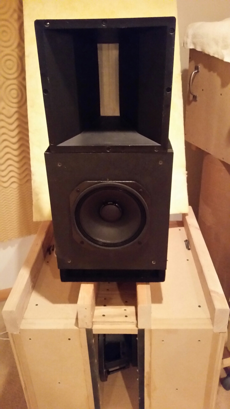

Hi Fred,
I have REALLY been enjoying these. And yes, I did promise measurements, so I did them today. Measured near field, as used with active crossover in place.
Pretty much ruler flat, with the exception of the range around 500-630 Hz
where they are up 2,or 3 db. Then plus or minus 1 db all the way up to 2.0K, and then a slight droop at 2.5 K, which is very close to the mfr's curve. These are the only 8 inch paper cone I have ever heard that do NOT have that nasty "cone cry". Additionally, they are very dynamic and can handle powerful transients with ease. Perhaps not the last word in resolution near the very upper part of the mid range, which is exactly why I am pairing them up with an HDA cone driver in my next prototype. At this point in time, I am not using any horns. This project for me, is to design/develop an all out assault on what is possible with all professional direct radiators. My push-pull slot load mid bass is used below @ 250hz and down to 60Hz, and above sit my Stage Accompany SA8535.

beautiful ribbon Scott L. - what is your cabinet's exact internal volume and duct ? - Delta Pro8a's q is low so in hornresp and direct radiator, some series resistance or high output Z low feedback amp is needed to avoid a midbass dip. What kind of amp do you use? I might try a 6x6 inch Dayton oval waveguide.
Joined 2008
Fred,
It's not visible in the picture, but the duct is stuffed for this application.
The remaining volume is one cubic foot. These enclosures were just plain handy/laying around, so I used them to try these drivers out. Upon first trial I had used a tubed amp, but my tired ole trusty/dusty Citation 12 (heavily modded) out performed the tube amp by a long shot. A pretty darned good driver for some versatile applications.
I'm not using them anywhere near as low as their Fs. With a nice low Q and a 14 BL product gripping hold of a 19 gram mass; I can see where JLH found them useful in a horn, up maybe even past their mass rolloff to meet with a smaller format compression driver/horn combo. A superb cone mid range driving a large mid bass horn might be an ideal marriage. They also found a dandy engagement in my on going trial of a full scale/full tilt direct radiator system for my medium sized room, which really is not big enough for an all horn system.
