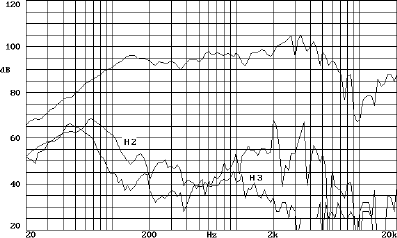

Talking about 8" Beyma with high efficiency, how about 8MI100? It looks a pretty driver, but I've never seen any comments on it.
Very irregular freq response and breakup at 2 and 3,5 khz :( I wish Beyma could publish their graphs with 5db steps like B&C instead of 20db... But creds for showing distiortion graphs tho.
Its been mentioned before, tho it looks very much like 5db graph steps to me
And B&C graphs to me really looks like something they have made by hand with a pencil
Is there a clear difference in how they measure, nearfield vs farfield
Hard to believe the B&C is that smooth in nearfield
And maybe the Beyma isnt that rough in farfield
But admitted, small drivers doesnt seem like a Beyma strength
