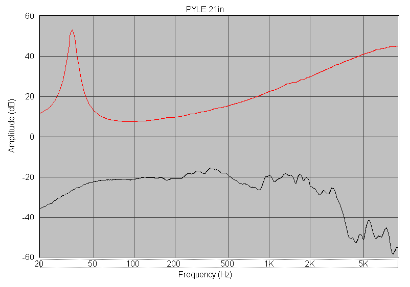

For large woofers under 500 Hz, to hell with all the expensive stuff, IMO. Well, that is, if you're on a tight budget, and want the most for your money, like me..
http://www.pyleaudio.com/itemdetail...Audio&cat2=Replacement Woofers&model=PDW21250
Can be had for $150ish each if you look around.
Parts Express has them for $200..
http://www.parts-express.com/pe/showdetl.cfm?Partnumber=292-2526
Magnetar (banned) and a few others have used them.
I have some T/S parameters that Magnetar provided in a thread that was moved to Texas, if anyone wants them.
I'd be really interested in seeing some response measurements though.

MisterTwister said:measured on 2ftx2ft baffle sitting on the floor, non gated, on axis. I don't remember mic distance.
Thank you!

hndaaudio said:I am interested in the T/S parameters for the 21 Pyle.
Here's what I entered in WinISD from Magnetar's findings. I could be wrong, but I'm thinking the Bl was entered too high on what GM posted (39 Tm vs my 32.88 Tm), so some other parameters are different on that one as well, like Sd.. his 1992.7 cm^2 vs my 1680 cm^2. IIRC, Magnetar didn't mention Mms, so I filled in Sd first by looking at other 21" woofers. So, that's why mine is different. Of course, neither of them are 100% correct, and as previously mentioned by someone else, there's very low consistency between drivers anyway. However, I'd say this represents a good idea of what to expect. Likely a very stiff suspension, and a high Bl (350 oz magnet, supposedly). I just wish I had a reliable Xmax figure, though..

Also, even if xmax was only 4 mm, two of these woofers per side in IB would get you around 110 dB anechoic at 30 Hz, with an overall output of around 112.5 dB anechoic, if EQ'd to an f3 of 27 Hz with .58 Qtc. If they can play clean enough pushed to 5 mm, that'd be 114.4 dB anechoic with 112 dB at 30 Hz under the same conditions. I've seen these things selling online as low as the $130-$140 range (shipping not included). So, no matter what, it's most likely still a pretty good deal.. unless Xmax really is just insanely low or something.
No, you're right enough, it took me awhile to unravel the 'comedy of errors' that occurred when I mis-typed a value awhile back when I posted the specs on another thread. I'd actually reverse engineered Sd, BL in Hornresp, winding up with 1686.87 cm^2, 33.1 N/A, but inputted the bad info in WinISD and it calculated an even higher Sd. Factor in that I'm still a 'newbie' WRT its calculating quirks and was in a hurry, so didn't check it as carefully as I should have..........
Anyway, thanks for pointing it out, I've corrected/reloaded the 'wdr' with specs I believe we can both agree on for now.
GM
edit: just tried both sets of specs in HR and the sims are a perfect overlay except for a minor difference in the acoustic efficiency of the larger Sd, so for all the 'wrong', it was 'right' enough.
