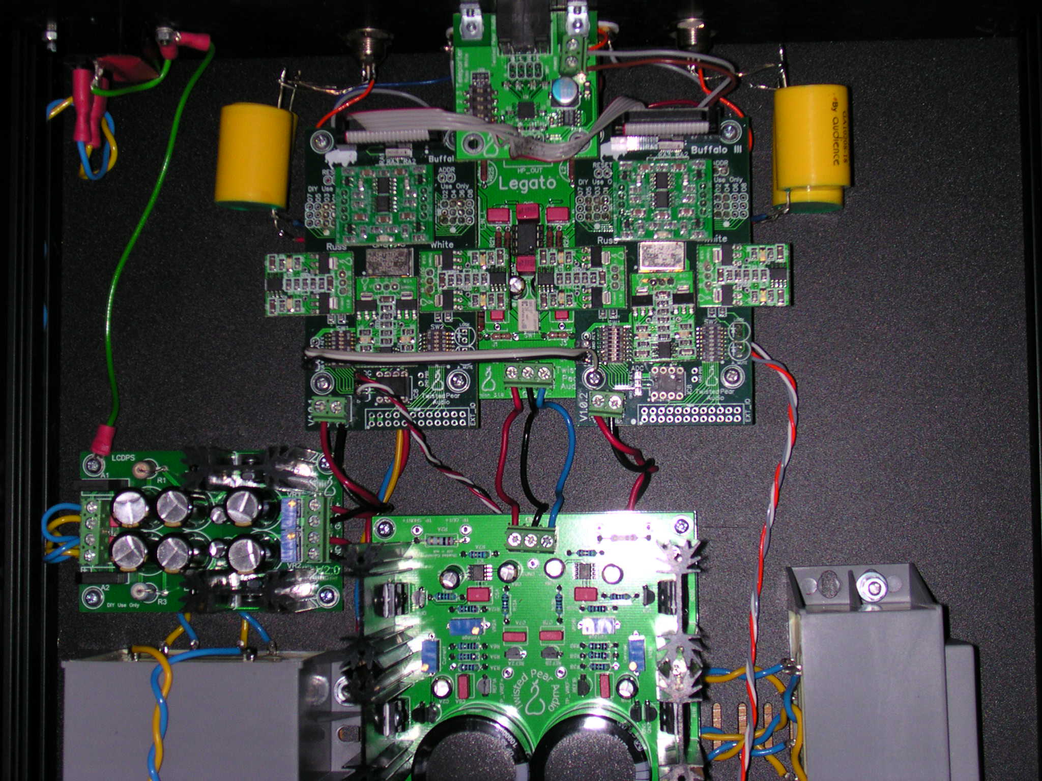

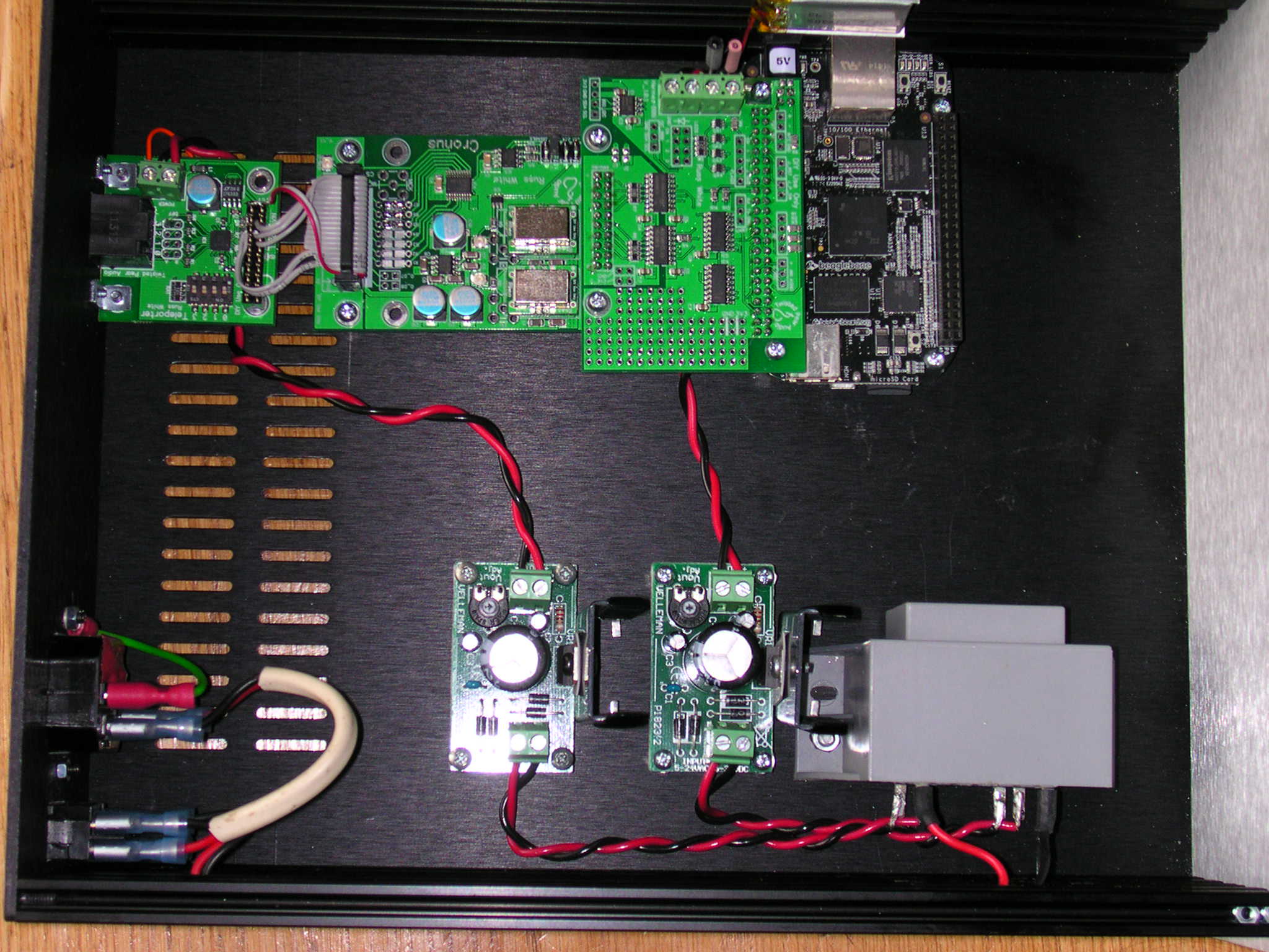

Only two small problems in the build, the back-up battery leads are very
thin so I had to resort to extending them with thicker wire to clamp them properly in the terminal block & I got the divider selector in the wrong position resulting in 'chipmunk' sounding music.
Synology NAS,ethernet,BBB,Hermes,Cronus,Teleporter,
Teleporter,Dual B-iii,Legato,Mono N-Core 400s,Shahinian Obelisks.
Well done, Russ, Brian & Miero.

Excellent build! That is a great way to use the Cronus/Teleporter.
Thanks for the kind words.
Cheers!
Russ
One building note - on the battery - I prefer to mount it with hook and loop directly under the hermes - then I just directly solder the battery leads to the terminal block pads. This keeps the battery tucked away and in a spot where it is not likely to get banged around or damaged.
Looks excellent!

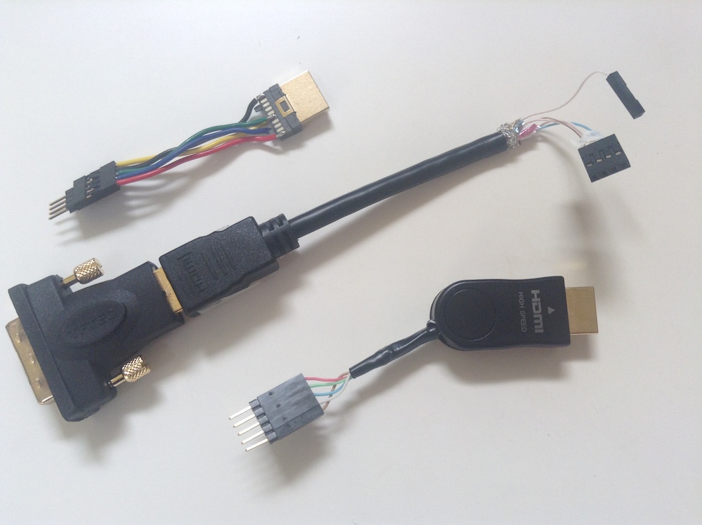

The PS Audio I2S-over-LVDS method is discussed on the forum here -In my case I have to find the easiest way to send LVDS to W4S HDMI I2S input, similar I think to PS Audio set-up?
http://www.diyaudio.com/forums/digital-source/237690-ps-audio-i2s-interface.html#post3645239
If PS Audio's use of LVDS is equivalent to the TPA Teleporter (it would certainly be worth checking)
then your Cronus-to-HDMI connections should be -
MCK to pin 10 (TMDS Clock+)
GND to pin 12 (TMDS Clock-)
BCK to pin 4 (TMDS Data1+)
GND to pin 6 (TMDS Data1-)
D1 to pin 9 (TMDS Data0-)
GND to pin 7 (TMDS Data0+)
D2 to pin 3 (TMDS Data2-)
GND to pin 1 (TMDS Data 2+)
You can very easily wire a teleporter for HDMI - but it has no HDMI connector on the PCB.
Here are a few examples of my previous solution. A DVI-HDMI adapter can provide easier access to check electric validity of prepared cables by tester.

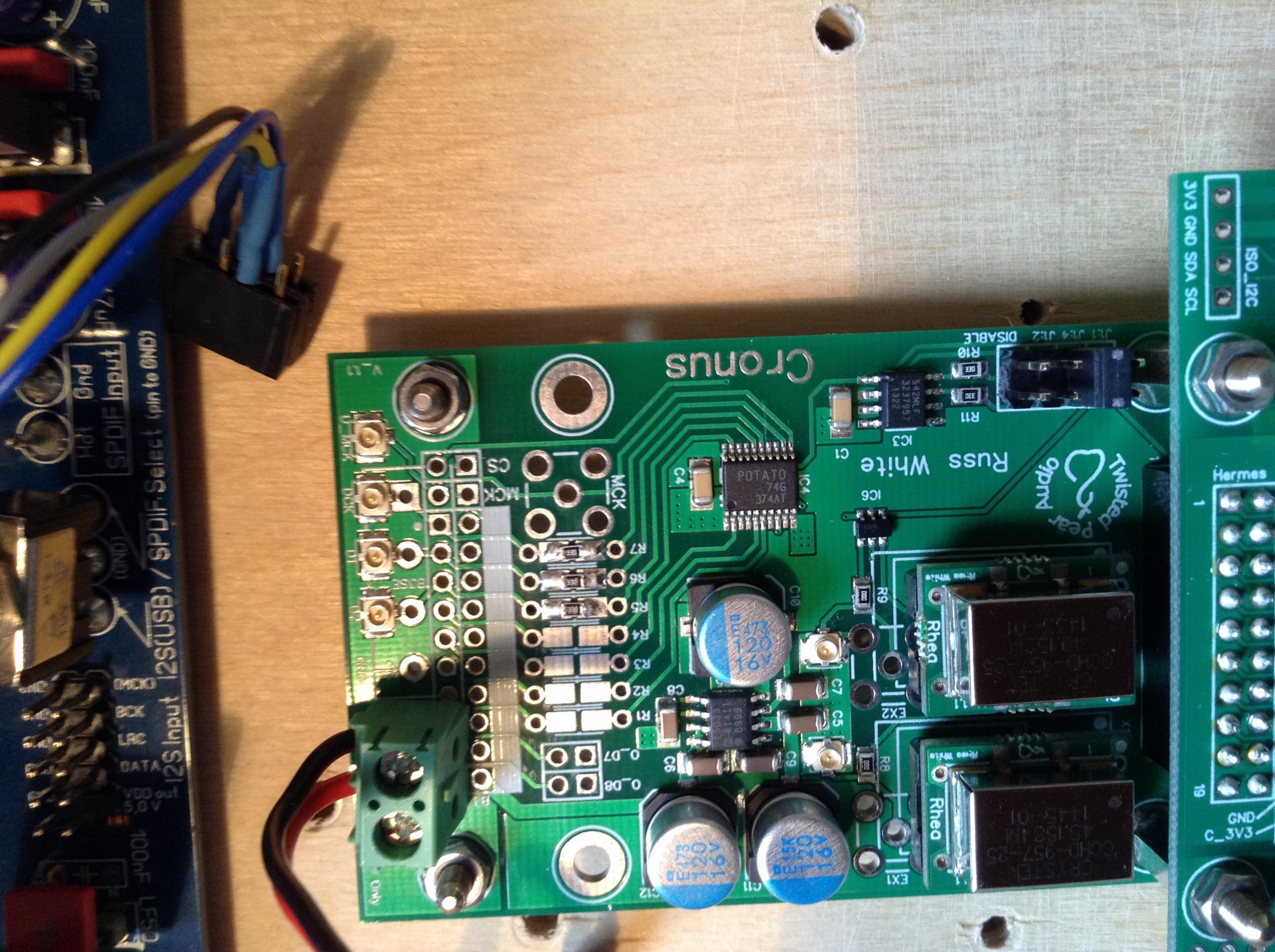

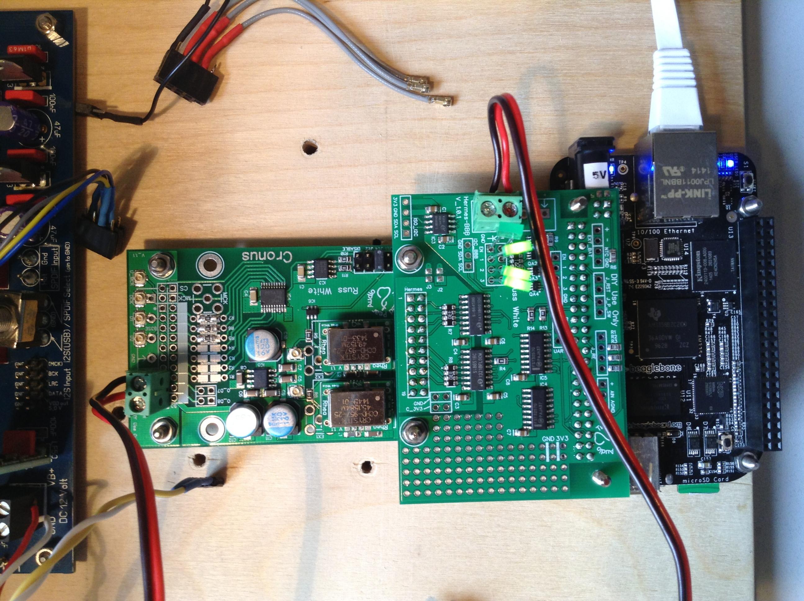

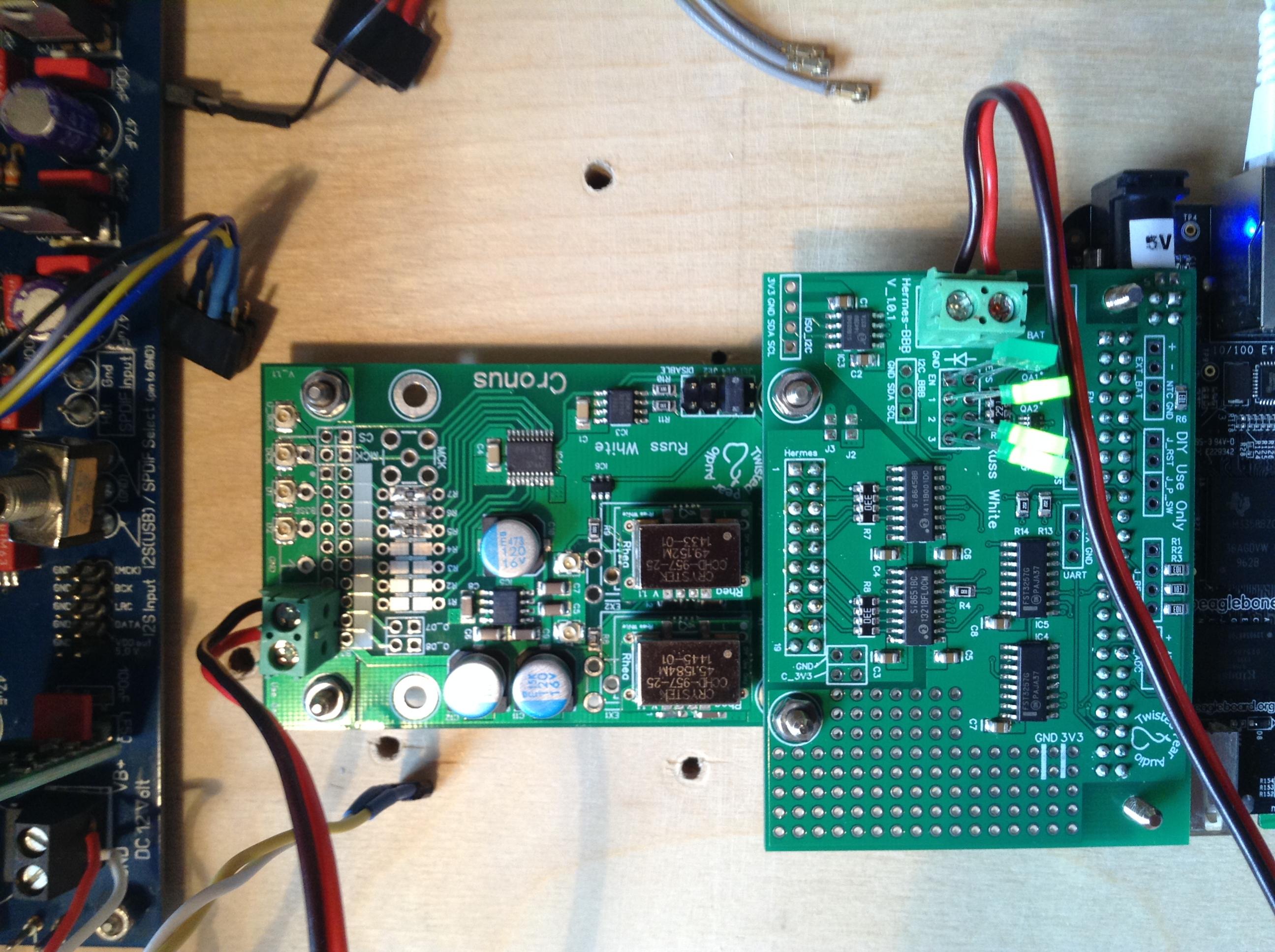

I have the boards soldered and connected to the BBB. Botic is running dut I did no configurations yet.
How do I connect Cronus to my dac?
Cronus outputs: U_MCK, DCK, D1, D2
Dac inputs: BCK, LRC, Data, (MCK)
I have tried different configurations but only static noise is generated.

I have swiched to 1:2 (my bad) and soldered the leds to the board to see if there is a connection faillure with enable led. After soldering still led is still not on.
Thanks for your fast reply! Will try your advice right away!
The dac is DDDAC; a NOS dac design with PCM1794.
You sure you have the firmware on the BBB working correctly? Make sure you follow Miero's instructions. Also make sure you set the clock mode to 3.
See here:
http://www.diyaudio.com/forums/twisted-pear/258254-support-botic-linux-driver.html
and some more specific help here:
http://www.diyaudio.com/forums/twisted-pear/258254-support-botic-linux-driver-69.html#post4305174
