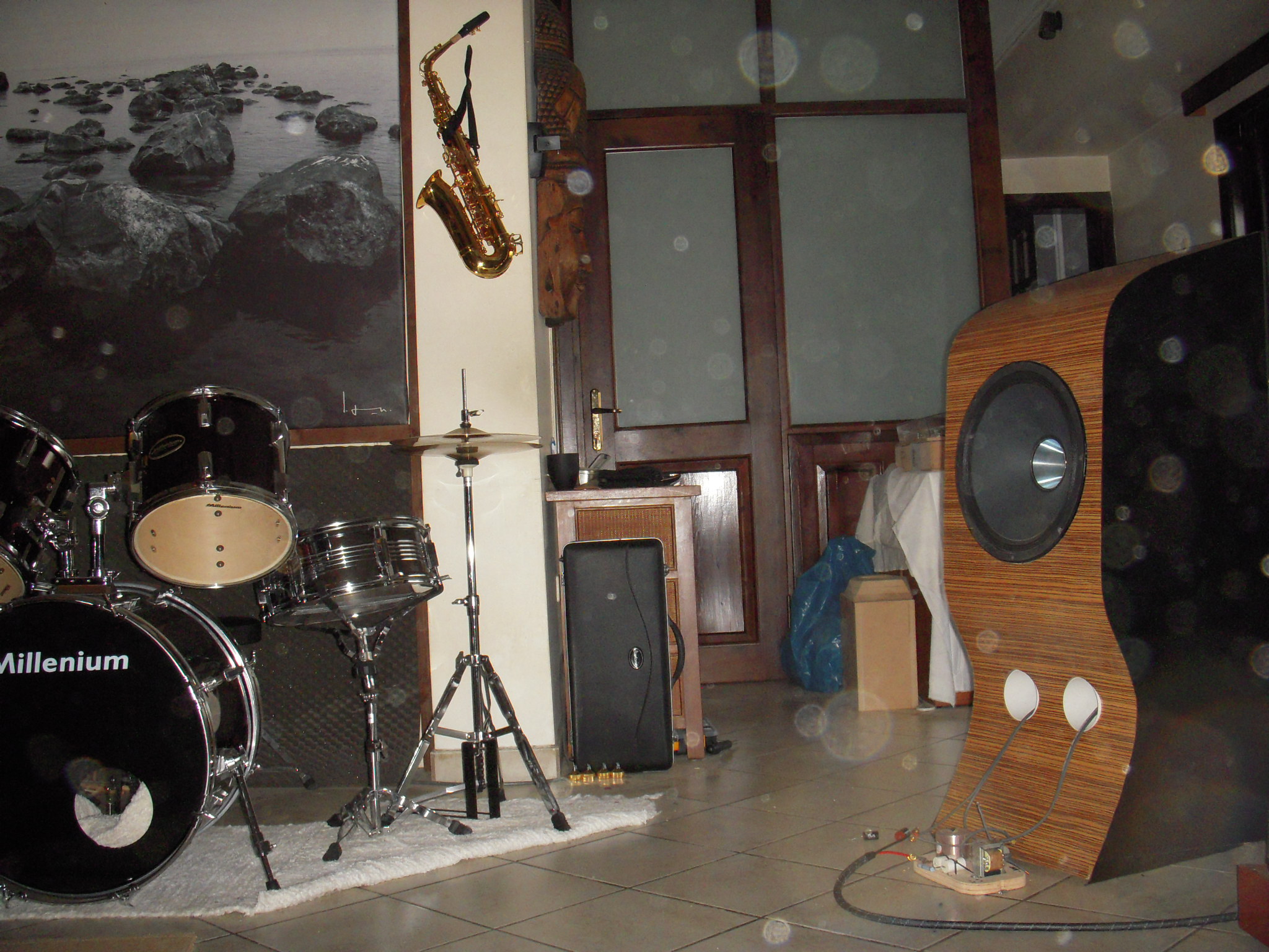

I have two years now 3 X CO15V in my system
One is the center of my cinema
SR hemp FR8C, SRB hemp FR4.5 and an eminece lab12 SW with hypex
Stereo system has its own amplifiers and sources.
CO15V plays in 130lt BR box as a 3 way with a Fostex A90
At the beginning i was playing with SET and triodes
but when i managed to make 2'' play with more than 200W (tubes or transistor) it is GOOD!!!
2order cross at ~1k and ~10k
autotransformer B&K3636 for the 2'' driver
