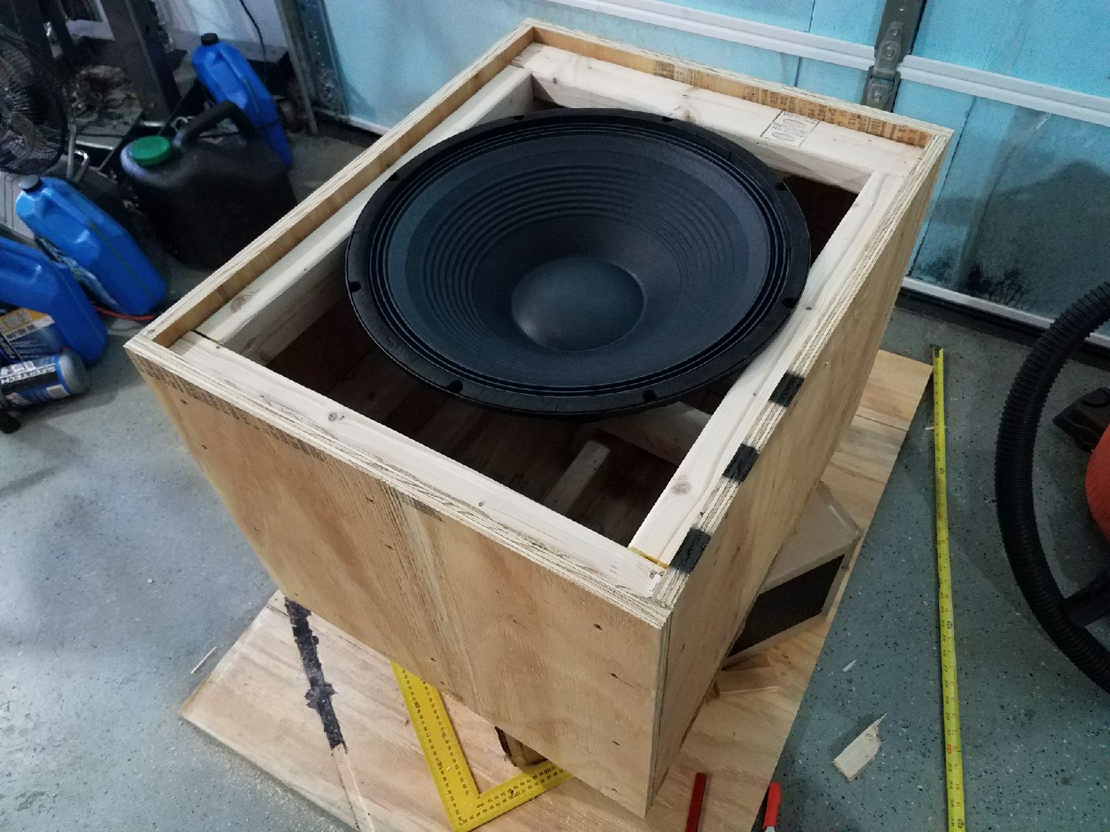

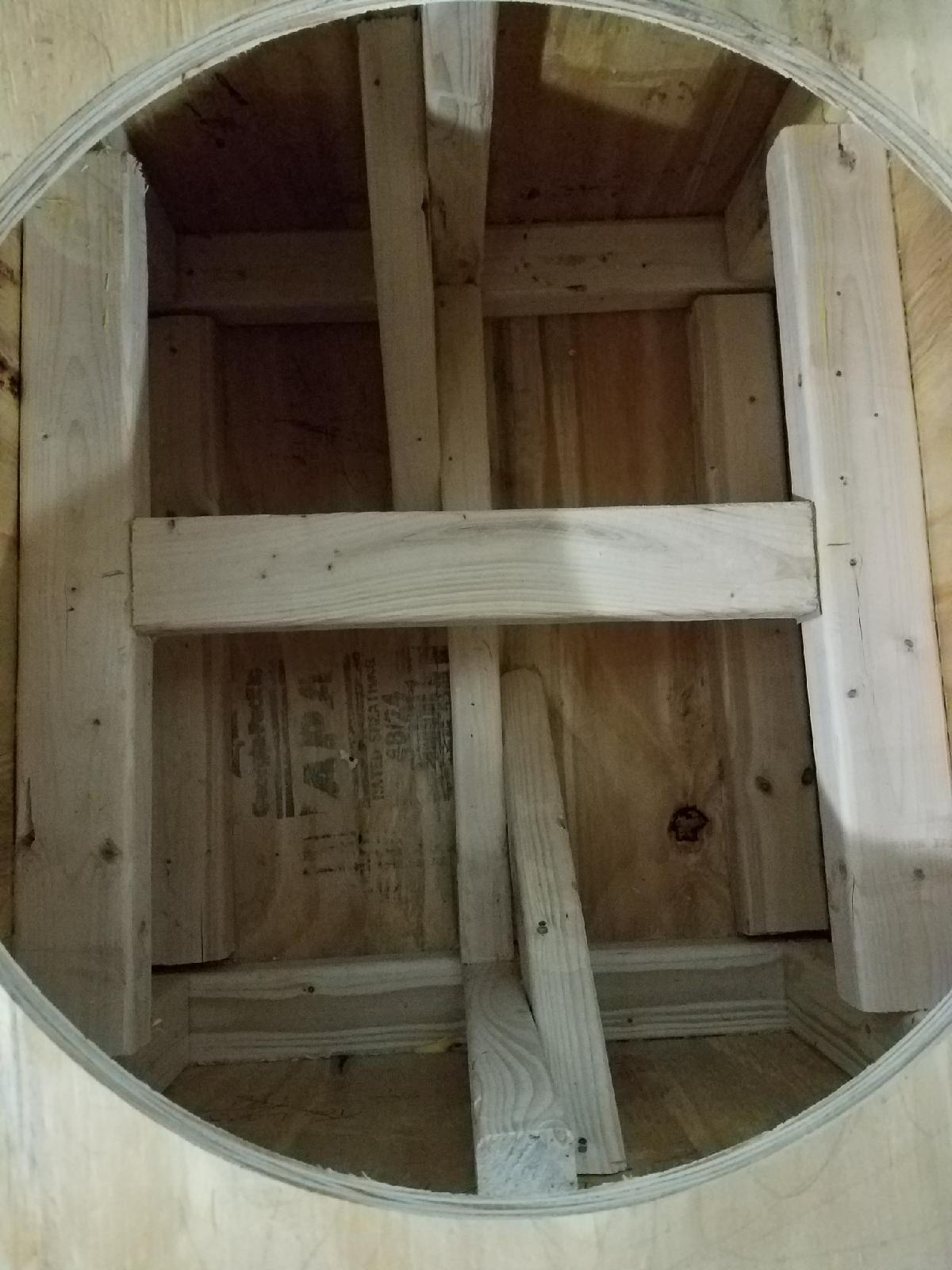

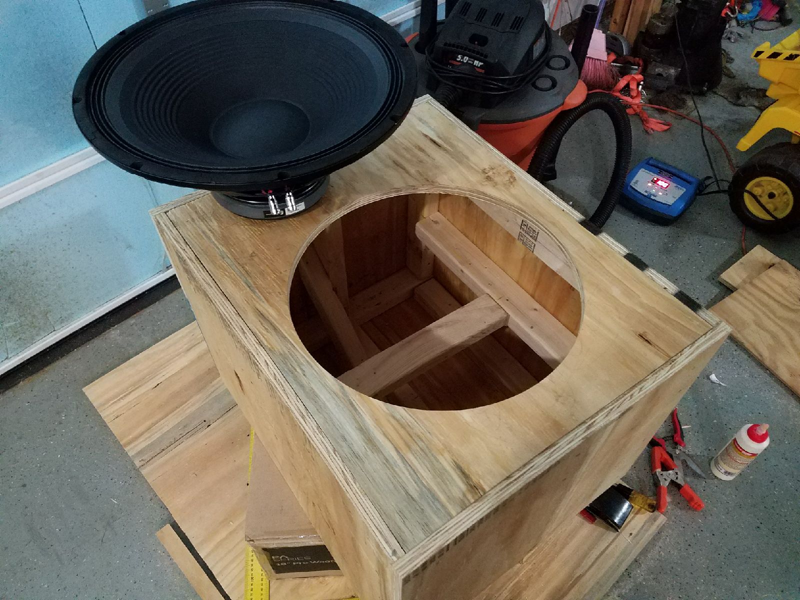

Some progress... but slow. This is the sealed box for the PA460 18" driver, 5cf ideal, closer to 4 cf in actuality with bracing.
I'm continuing to listen to and enjoy the other PA460 driver in it's monstrous 9.8 cf ported box, and it does seem to do well with most genres of music - classical, rock, pop, electronic, jazz. It does have good punch when the music is punchy, and the volume is up. If the music is boomy, then things can get exceptionally boomy. And it reaches low enough that the newer electronic stuff sounds great - I was just listening to the new Tron soundtrack by Daft Punk the other day and it's got some lowww stuff in it. >For reference, I've been mostly leaving the bass/treble knobs and EQ flat.
I'm very curious to see how the same driver behaves in a sealed box - obviously the f3 will be much higher (66 vs 34 hz, ~38 hz w/ subsonic filter), but perhaps with a more gradual rolloff at the low end it will be more impressive than one might assume looking at just a graph. I guess I'll see soon enough, just need to get the driver mounted and debating any additional bracing inside.
Jesse

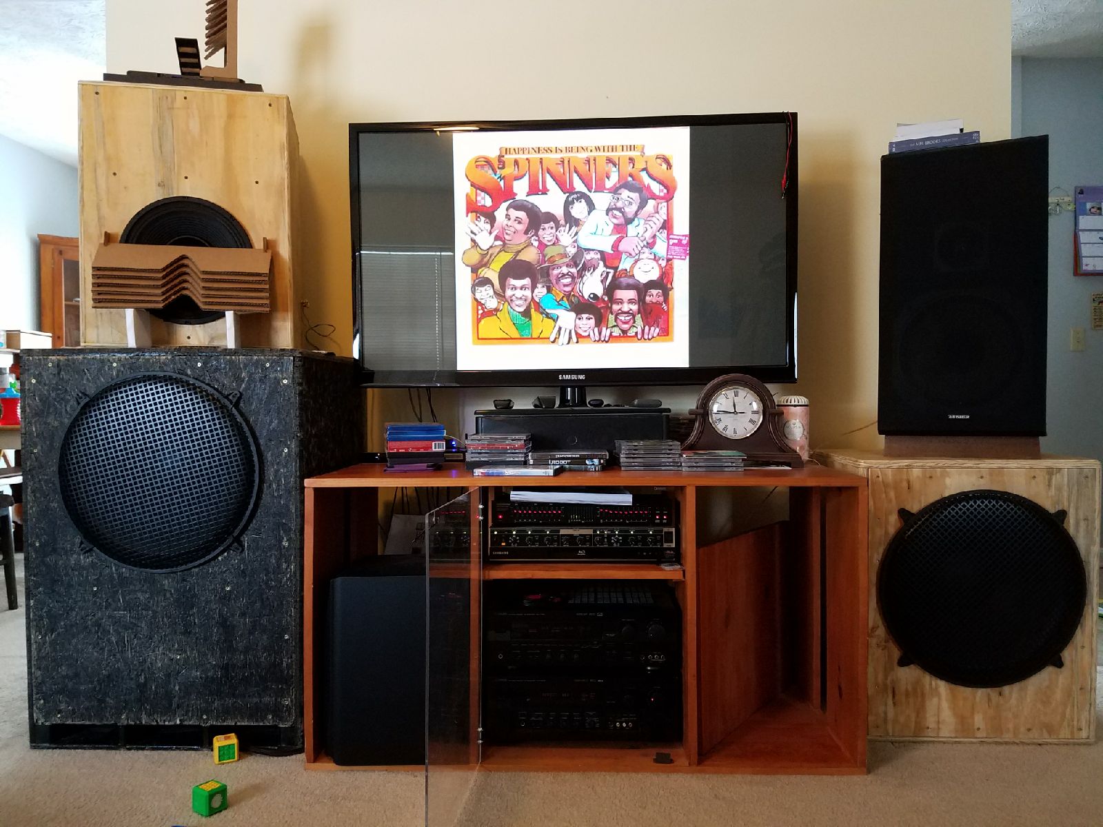

Ah - it's also worth mentioning that with both the ported (left channel) and sealed (right channel) cabinets running at full tilt, I finally do have the "punch" that I was after... So they don't disappoint! :)
Jesse

Good for you !!!! I like the looks of the stain on the sealed box - what is it ?

Thanks Freddy - That box is just bare plywood at the moment... it does have a nice weathered look to it. Original plan was to get nice birch ply and stain it something like a warm brown, and these prototype boxes were just going to be black. Time allowing, of course...
