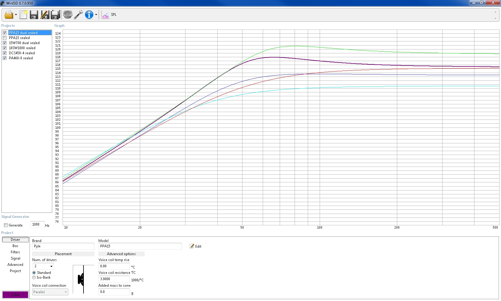

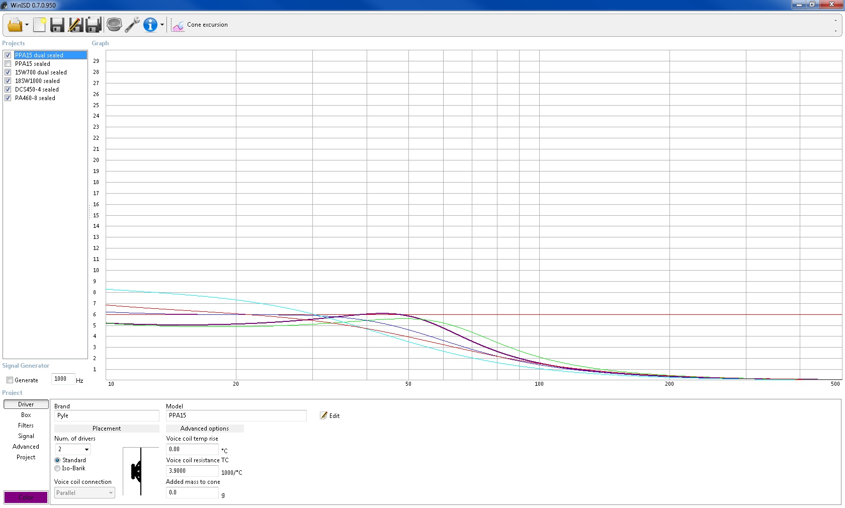

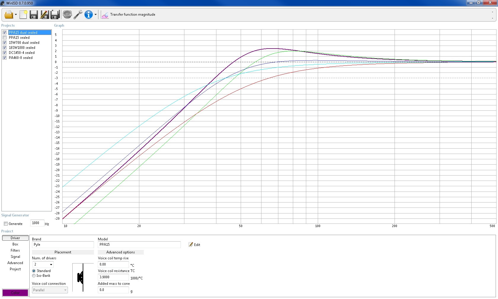

Some plots from winISD. Transfer function, SPL, and Cone Excursion. Boxes were sized for flattest curve/best LF extension, but sometimes undersized to keep excursion in check.
purple = PPA15 dual sealed
green = 15W700 dual sealed
blue = 18SW1000 single sealed
aqua = DCS450 single sealed
red = PA460 single sealed
I tried simming a bunch of cheap drivers from MCM, but they all seem to be meant for OB, none simmed well.

Hi Freddi - thanks, the dayton pa460 specs look good but only simmed 'ok'. I looked at the pa380 as well and it was very similar, i'll see if i still have the sim of that to compare.
I actually saw and tried those p audio neodymiums in winisd, and they rolled off wayyyy early, like 70 hz or higher... ? I will try to dig that sim up too.
I was just surprised that the cheap Pyles simmed pretty good, with a slight bump around 55-60 hz that won't hurt anything. And i can get 4 of the buggers for 200 bucks.
Is there a downside to them, other than they say 'PYLE'?

This makes sense and I will agree with. OB is off the table at this point, looks like sealed is the way to go.impulse response (OB or sealed) and high-impact midbass/mid are the keys
Any other woofers stand out of the crowd for a sealed application that are also inexpensive?
I'd like to try simming a few more - both dual 15"s per side, and single 18"s per side. I mentioned 4x 12" woofers to my wife but that was not well received... ha!
