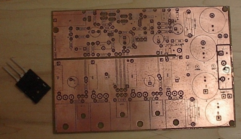

Here's the component side. It's not much bigger than the prototype.

Hi Nico,
The silkscreen is just the same toner transfer as the trace pattern. I just print it on the glossy magazine paper, line it up and iron it on.
I think it would work for aluminum face plate, but it might not be "clean" enough. There is god definition, but it can look a bit "fuzzy"
I will try it later, as it would be a very good way of labeling things, especially on the back plate. It's very durable on the circuit board.

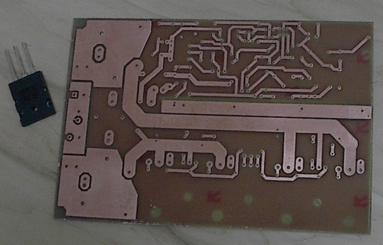

Here's a shot of the solder side of the board.

Hi John, your boards are looking very professional. I would however recommend that once built up, clean off all the flux using a good solvent that will not leave a residue and then spray it with coat of clear polyurethane and the amp will be good for 20 years or more.

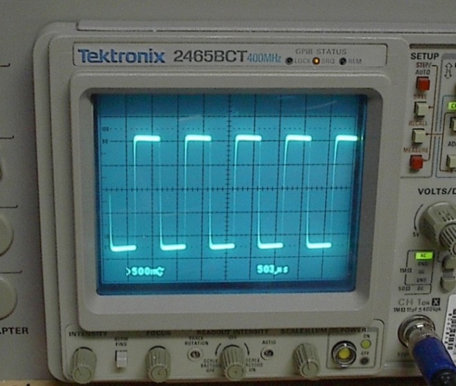

Another pic. This is the amp handling a 1KHz squarewave (from the calibrator output on the o-scope).

Thanks Nico,
I have already coated the component side with lacquer (lacquer melts easily, so soldering is easy). Once the board is built to my satisfaction, I'll do the solder side.

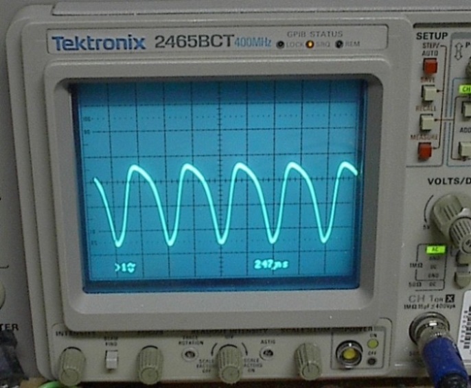

I have a slight problem with this new build: oscillation at ~1MHz. I have tried a few things to eliminate it, but have had no luck so far. It's not load dependent.
Here's what it looks like on the scope:

Hi John, you have hit a snag that very often occurs in PCB layout, few people even realize that they have oscillation after building up the board. This is not so serious as you think and the cure is pretty straight forward and it is a case of placing a few 10 -100 nF caps along the power rails on the board. The oscillation is very often in the VAS since this is where the gain is. Try looking for feedback into the input in the form of tracks in parallel with each other near the input stage of the VAS.
There is one other area that I was never so sure of and that is the high pass T-section that you use in the top of the circuit. Many swear by miller caps but just their lead length can cause high order spurious signals. Also maybe increase the value of the feedback cap, one in parallel with your NFB resistor, it often occurs that the miller cap and the feed back cap causes enough phase shift to create a 360 degree shift and there you have a perfect oscillator.
Finally you may want to play with the value of the input capacitor as well as it can cause some phase shift. But I suspect that it is two tracks forming a single winding transformer and coupling energy back, this would normally only require the addition of a small cap to change the impedance.

John Firstly change c13 to 100 pF and see if the oscillation stops, the 10 pF you have there is not going to do much in this case, it is a little bit on the lean side, it will not affect what you hear.
The other thing that you can try is the center TO-220 power transistor, I not sure which one it is, I don't like the parallel wires with the emitter resistors, I would slip a ferrite bead over the wire leading to the base close to the transistor, alternatively place a few pF between base and emitter or maybe even twisting the wires together to increase their capacitance.

I spoke too soon. Amp runs fine without load. As soon as the speaker is connected, oscillation starts.
Things I have tried:
I thought the front end was running a bit too "hot" for the LM394, so I reduced current through that device (Ic) to less than 1mA. No change.
I removed local VAS feedback (500K resistor). No change.
Increased current to the differential cascode by changing 20K resistor to 10K. No change.
Disconnected the feedback path to the cascode. No change.
Replaced the bypass caps on the rails at the output stage. No change.
Nico Ras said:John Firstly change c13 to 100 pF and see if the oscillation stops, the 10 pF you have there is not going to do much in this case, it is a little bit on the lean side, it will not affect what you hear.
The centre device on the board layout is the Vbe transistor.
I'm trying to see what the difference is between this version and the second prototype, which is identical to this, except the board layout.
I will try to introduce some capacitance to these wires you refer to.

A final thought, this may sound silly but I have had this once before. I have not used LM394, but used MAT02 the Analog Device matched pair and they did not like degeneration resistors in their emitters, you may either try removing them or place a 100 nF cap between the emitters so that they are at a common a.c. point.
33pf across the B,C and the C,E of the Vbe transistor did nothing. Extra bypass caps to the collectors of the drivers - no change.
Nico, I will try the cap across the diff pair and change the feedback bypass(10pf) to 100pf.

I tried the 100nf cap on the degeneration resistors - no change. No change when I replaced C14 with 100pf.
I went to the extreme of removing the LM394 and replacing it with 2- BC550, like in the prototype. This pushed the oscillation more negative on the scope, but it's still there.
I'm running out of ideas.
