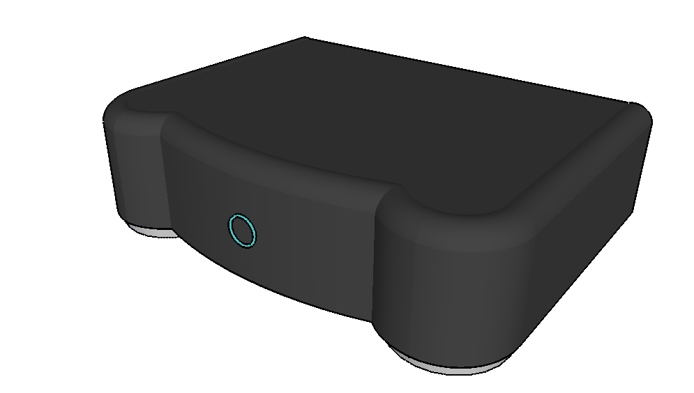

I have been thinking about the case for this amp, trying to come up with a design that matches my taste and the things I already have. I've decided to make these mono blocks with the transformer in a separate case, supplying both (or three is what I really need).
I've built cases from aluminum before, but I'm really tired of this look. I want something sleek, distinctive. The baffles of my new speakers are piano black and I want to do the same with these amp cases.
I came up with this. The general shape and proportions are there but picture it gloss black. The entire body will be made from MDF, except for the back panel. I will line it with foil tape. Feet will be 3" diameter x 1/2" high stainless steel - polished.

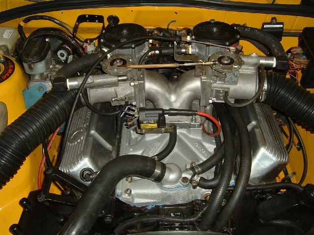

Incidentally, here is the worked high compression 384 cu. in. engine I recently finished bolting togeather for my 2900 pound daily driver.
