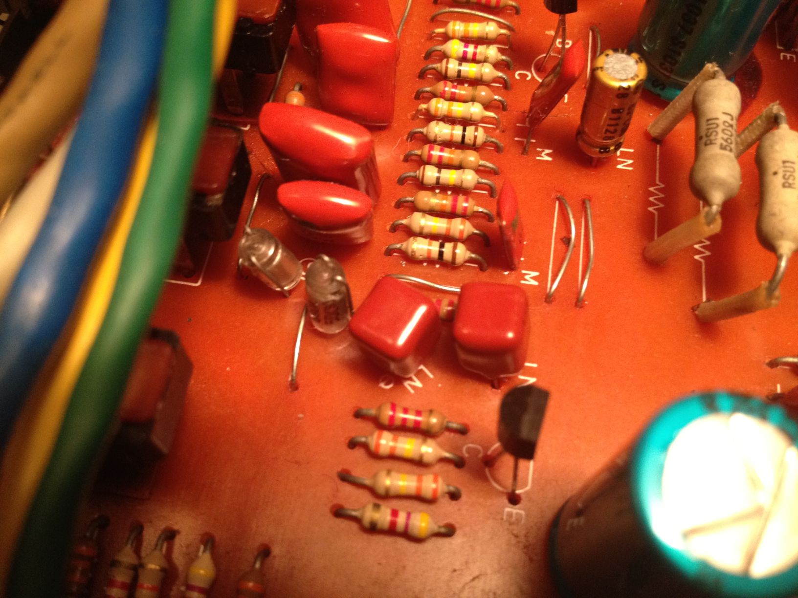

Hi hitachi_nut,
yes you were the first who suggested capacitor leakage issue and for that you deserve all credit and my gratitude.
My only fear is that not only caps are the culprits here. Only reason for me thinking that way is because the amp was silent for more then six months after recapping, if the caps were leaking wouldn't they leak from beginning, such was the case with C517, it leaked the most when freshly installed.

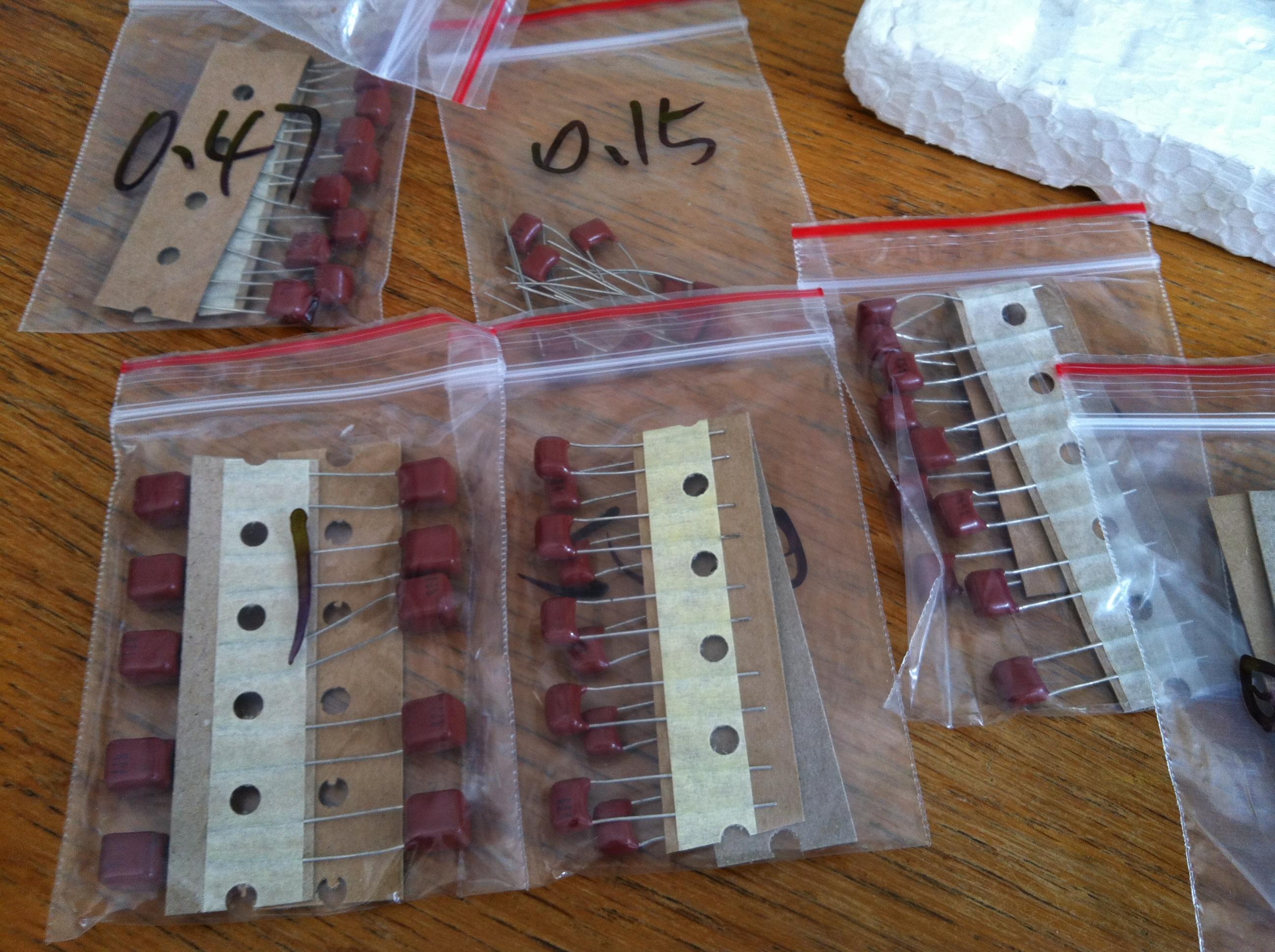

Anyways, per your recommendation I ordered Panasonic caps ECQV1 in 1uF/63V value so we can exchange C505/C506 and C527/C528, I recall you mentioned they are small in size, do you perhaps know exactly how small, those MKT were a tight fit so just to know what to expect when Panasonics arrive.
My wife informed me that the Panasonic caps finally arrived, contrary to my expectations they arrived last although the were ordered first. That is life

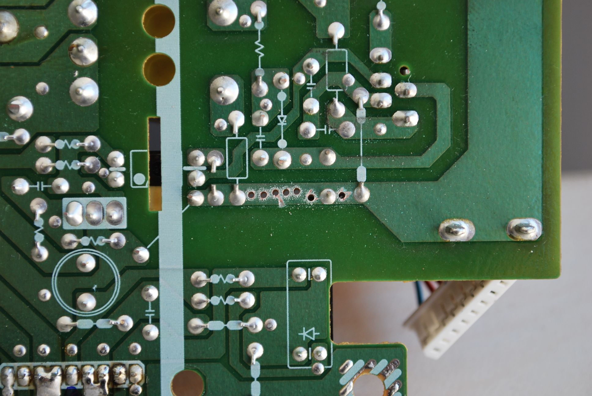

My wife was also kind enough to send me this picture, I am at work, so in preparation to install them I have a few questions. From the picture it looks like lead space is pretty wide, Mooly you suggested drilling the pcb instead of bending the leads. Since I have never done such a thing I practiced a little on some pcb pictured below. I understand I should expose bare copper but how do I improvise the "eyelet", soldering post that is. Track in the picture is pretty wide so "eyelet" in this case is probably unnecessary, but I presume that the tracks in my amplifier are probably thinner. Inputs very welcomed here.
Gently scrape off the coating over the copper strip.
Apply a hot iron and cored solder to the freshly cleaned copper surface to thinly tin the strip with the holes.
Insert the legged components from the other side.
Solder each components leg to it's respective strip (pad).

Hi AndrewT,
and thanks for quick reply. So I should carefully tin around the hole before inserting the cap? One more, I presume I can but just to be sure, can I use one original existing hole and add another, new one which is drilled further apart then the second original hole? It is a complicated sentence but I think you will understand what I mean.
your newly drilled holes are quite close together. Just tin the whole strip. Don't try to create a tinned pad around each hole.
If you had a single isolated hole, then it is worth exposing a small clean copper area to create a single pad.
Soldering the pad areas (strip) before you attempt to attach the components will make the attachment much easier and less likely to damage the components and less likely to damage the glue joint from copper to substrate.
The green solder resist just scrapes off. Try a sharp craft knife.
If the tracks in the amp are very thin then to avoid damage drill the hole next to the track without actually drilling into the copper. Then scrape the resist from the track alongside and insert the component lead and bend it to the newly cleaned track and solder.

Just in case with those wimas I also ordered some tantalums 3,3uf for C545,C546 position, if the need arise they are at hand.
The caps were a lot smaller in person then the picture suggested and the color of them is such that they blended perfectly in the Rotel interior, thanks for recommendation hitachi_nut, unfortunately same can not be said for those light green MKT caps, see pictures.
I drilled new holes the for leads and that went smoothly, although I would like to add one more advice to those already made by AndrewT and Mooly, and that is to check for any resistor crossing the track to be drilled on the top side, I was lucky
To summarize C505/506 and C527/C528 have been changed to Panasonic ECQV 1uF, C517/C518 to ERO VISHAY MKT1826 4.7uF. Everything that was unsoldered before for testing purposes is soldered back, except of course volume pot and C505 and C506 are still tied to ground via point E7.

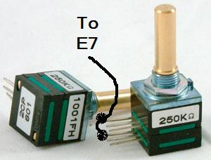

Couple of questions:
-which volume pot do you want to be installed, the old original one or new TKD (my personal preference is TKD as I can not imagine going back to poor left/right tracking of the old pot after hearing TKD)

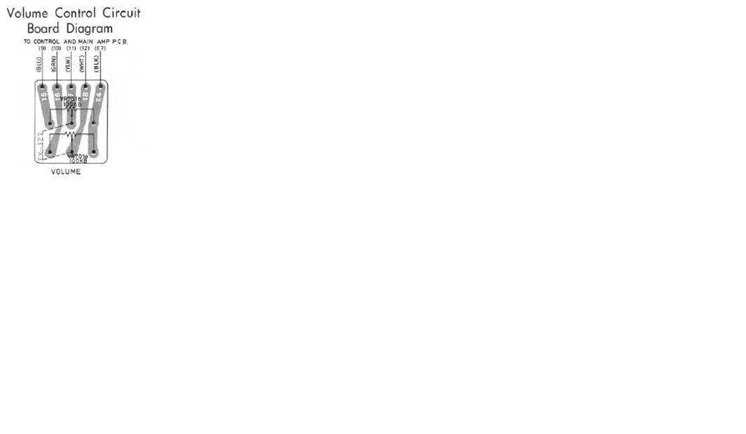

-the original volume pot had only ONE ground connection, that is to E7, look at the picture. I wired new pot which has TWO ground connections like in the second picture

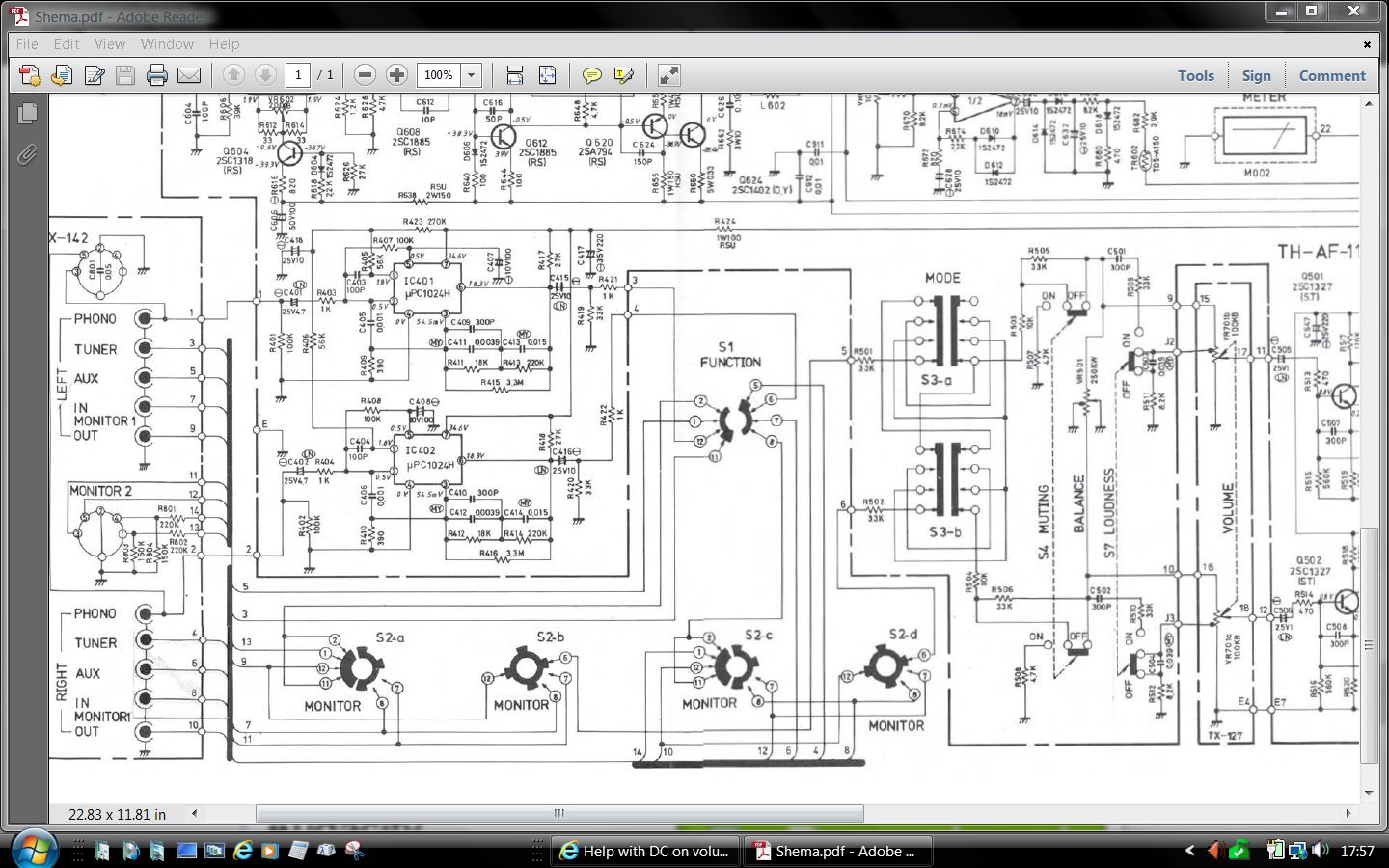

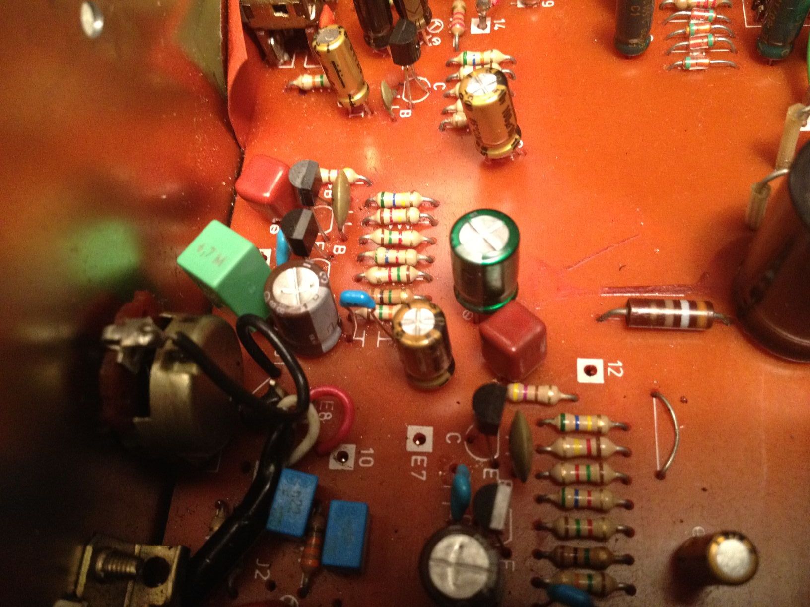

I am also enclosing a picture of original wiring, you can see from the picture that all wires going to and from the pot were loosely twisted around each other.

Your original pot is here,
http://www.diyaudio.com/forums/solid-state/202909-help-dc-volume-pot-3.html#post2832789

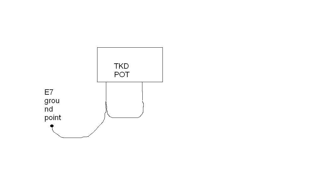

I would fit the new one and wire the two ground pins together at the pot and run a single wire back to the PCB preserving the original scheme.
Like this
Like this

Hi Andrew,
My reasoning is that without first hand knowledge of the amp i.e. in front of me on the bench, then using the original manufacturer scheme seems the safest option.
If you meant a separate ground wire per gang on the pot, and that twisted with the wiper connection for that gang then that is an alternative way even though both grounds end up at point E7
I didn't quite follow this part as it's an integrated amp.
Quote "The input signal is two wires. Run them between RCA input socket and vol pot."
That would add another ground run in "parallel" to what is already there.
Maybe draw out what you mean... but I think sticking to the original layout is best here.

-both pot ground terminals connected to E7 via one wire
-C505 shorted to ground via E7
-C506 (point 12 on PCB) connected to the wiper of the pot
-no pot inputs connected
I get the same sparkling type of noise as before in BOTH channels while rotating the pot, perhaps the noise is stronger in the right channel but the difference if any is subtle. When there is no movement of the pot there is no noise, there is also no noise while rotating if I use any non-conductive material between my hand and the pot shaft, the noise is also lower in intensity if I touch the amp chassis with the other hand.
I was tempted to short C506 back to the ground and try with C505 instead, but I choose rather to report here and wait for further instructions.
To hear a noise in both channels is really strange as we have C505 (input to one channel) shorted.
Can you try this...
unsolder all wires from the pot and then measure on ohms (use a high ohms range as well, one that will show meg ohms) from the chassis to all the leads on the pot.
Do you get any reading ?
Can you try this...
