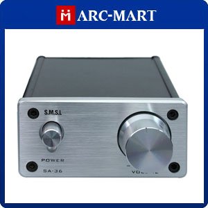

I have Class T Amp TA2024 at home, picture below, maybe its pot can be a suitable donor, however its type and resistance is unknown to me. 100k is what Rotel asks for.

For a permanent replacement I would stick to 100k because it works in conjunction with the other passive parts in front of it such as balance control and resistors feeding it.
For testing though, anything from 47 to 250 K should be OK but unless it is a pot you are going to keep in the amp there is no point... as we know the original pot works OK... and so we want a permanent replacement.
I wouldn't go pulling the T amp apart just for the pot.
