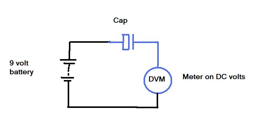

You can try this just for fun. Look at the diagram. The DVM is set to DC voltage and placed in series with the cap as shown. The tiny current drawn by the meter on "volts" is enough to slowly charge the cap. If the cap has zero leakage then the meter should eventually show zero volts.
I used a 12 volt battery. I also read the battery voltage via a 10Megohm resistor to see what load (resistance) the meter was and got around 6.18volts. I think most DVM's should be similar. That means the meter is approximately like a 10M resistor on DC volts and so that is what is "charging" the cap.

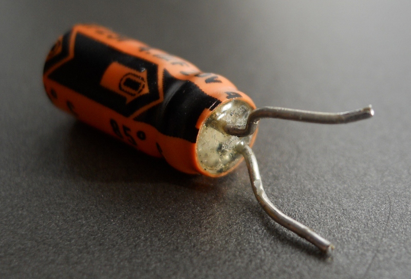

Yes, I had that same thought, unfortunately I junked the old caps. I am sorry now I did, however the difference between caps that made left channel silent and these new ones on which it pops would be interesting as well.
I haven't been able to find much out about the original LN marked caps

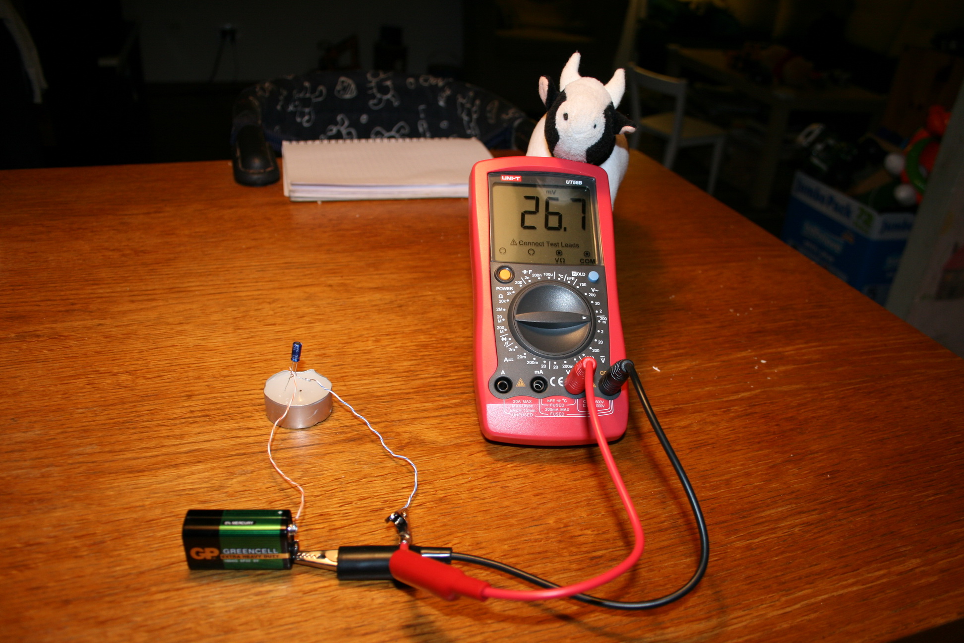

I tried it with the 47uF Panasonic cap and got this.
3.35 volts, 15 minutes
2.57 volts, 20 minutes
1.70 volts, 35 minutes
1.49 volts, 40 minutes
1.29 volts, 50 minutes
1.20 volts, 60 minutes
0.80 volts, 2 hours
0.77 volts, 2 hours 15 minutes

I am a lot more optimistic about cap leaking theory, because when I came home from work amp was still on and the noise has diminished substantially. If soldering back Q504 further diminishes noise I can even imagine that channel being silent with current cap in place.

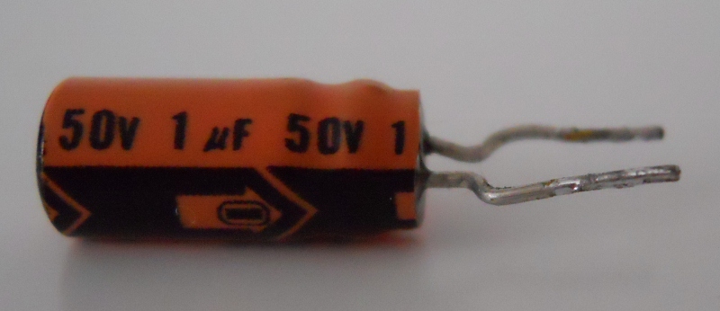

Since I skipped on soldering, I performed battery test on ELNA RLB low leakage type, 1uF 50V. I got way lower reading then you Mooly so I am enclosing a picture for inspection
ELNA RLB 1uF 50V on 9V (8.36 actually) battery
15 min. 72mV
30 min. 55mV
45 min. 38.4mV
60 min. 27.8mV
75 min. 24.9mV
90 min. 18.8mV

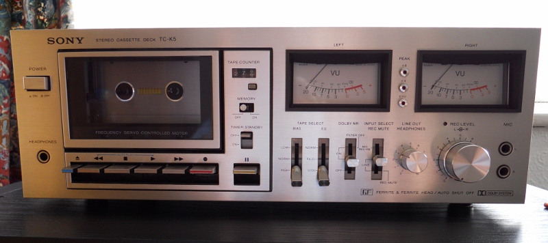

I have an old (1978 vintage) Sony TCK5 cassette deck. Looked at the circuit and sure enough some caps around the tape head preamp and the record level control are marked with an "N". So I had a look and pulled two out. A 4.7uF 25v and a 1uF 50v.

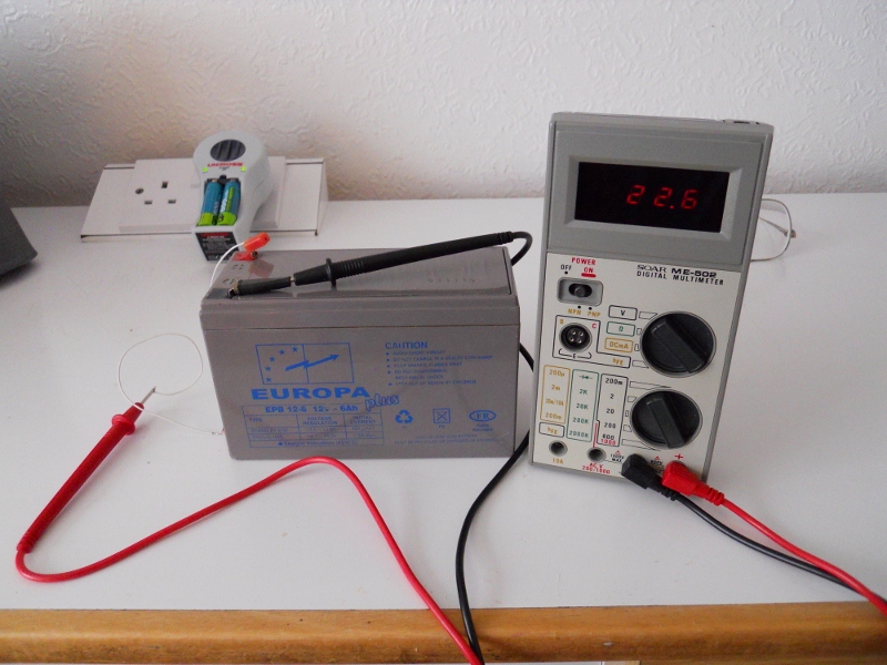

The 4.7uF got down to around 22mv in the same test set up (12 volt battery) in only an hour and this cap has been powered up for months and months. Leakage seems very low to me.
Look also at the construction of the cap. The end where the "rubber bung" is appears to be some kind of hard epoxy.
The 1uF is currently on test...

The 1uF (N) cap is now down to 18mv.
