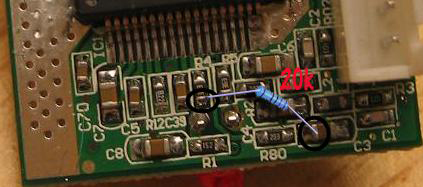

I've been reading this post for a few days, went and order one (with new board) from Buy . com started dissassemnling and oh surprise, somebody forgot to mention magnification factor, at least for some of us with poor vision, to do this you need to have an adjustable steady maginifiying glass or loupe :magnify: . Now, I am fortunate to have one, but in the hurry, I pushed to hard :smash: and brought with me R80, which is in the new board R1, as I understand, now I should have no problem putting it back. But just by its side is a R1. Am I confused now???
You will need to replace R 80 ( previously R 1) otherwise you will only get sound from one channel..
New R 1 ( previously R 15 ) is the LED resistor..
Those boards can be a shock when you see them in the flesh after seeing the enlarged photos on your PC..

Re: Re: Magnifiying glass
OK, so I thought I had R 80 back on the board, but was not. Is there any other way to connect this R down the line, I mean a bigger R that I can solder? I bench tested the amp and I got sound (1 channel) with a CD and a 12V 2.5A PS.
Any help on how to re-connect R 80 somewhere down the line?

Re: Re: Re: Magnifiying glass
Maybe I should go back to tubes...
You will need to connect a 20k resistor between one side of R4 and the C3 bridge..Please try not to lift R4 off the board..:rolleyes:
