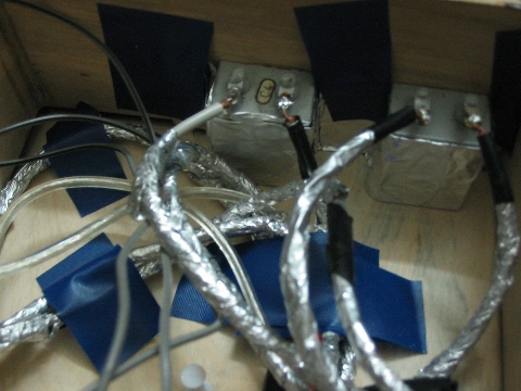

The last post for my T amp. i have tried to shield the caps and wires, noise reduced a bit (not much) and I actually couldn't get rid of the background noise. So will be please to use the water pipe for grounding.

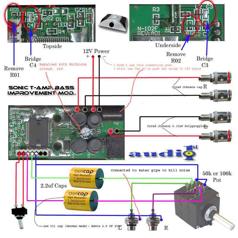

I posted my mod detail, drawing on Audo1st dia. Will try to find a digital camera to post pics when possible.

Lostcause said:
I suppose you just need to use the resistors you jumped in with?
Un-solder from the caps and solder that end to the board to complete the circuit as it was? The traces/leads will increase the chance of RF pick-up but it may be OK?
I have the same problem, but I do not really understand the answer you gave. I still have R1 and R2 and I "may" be able to re-solder them, if it is neccessary to put them back. Your help would be appreciated. By the way do you know what vlaues R1 and R2 are ?
Better if you put the originals back, and a lot tidier!Puffin said:I have the same problem, but I do not really understand the answer you gave. I still have R1 and R2 and I "may" be able to re-solder them, if it is neccessary to put them back. Your help would be appreciated. By the way do you know what vlaues R1 and R2 are ?
To be honest, I've done both now and can't really tell much difference because I shield everything when using the classic approach. changing over to the stealth method is only really needed if you have noisy inputs.
R1 & R2 are 20K but the feedback resistors (R4&5) are 35K, that's why I frefer to use the classic with 35K resistors to jump in with.
If I was pushed for an opinion then my first board with R4&5 replaced with 20K's (R1&2) and 20K resisors to jump in with, is my board of choice....not much in it though.

May be I'll wait until some of you have better solution to the problem (sorry but I'm not an EE to have any good idea to this). i have thrown away the original R01 and R02. I use a wooden case (not a metal case), do you think it is the problem? Any way, if I connect the outter tags ( the interconnected tags, according to the dia) of the input jacks to water pipe, then it is silent. Do you think it can cause any damage or problem to the system (eg, the life expectancy) in the long run?

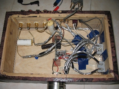

I attached here some pics of my amp
here is the inside, quite chaostic, but i am bad at this

Hi genki, is all that silver foil grounded? if not it will make your problem worse. Are the outer tags of the input jacks connected to the boards ground?

no, not at all. So the idea now is try to connect the outter tags of the input jacks to the board ground, right? If so I will try it. What I do now is connect it to the water pipe.

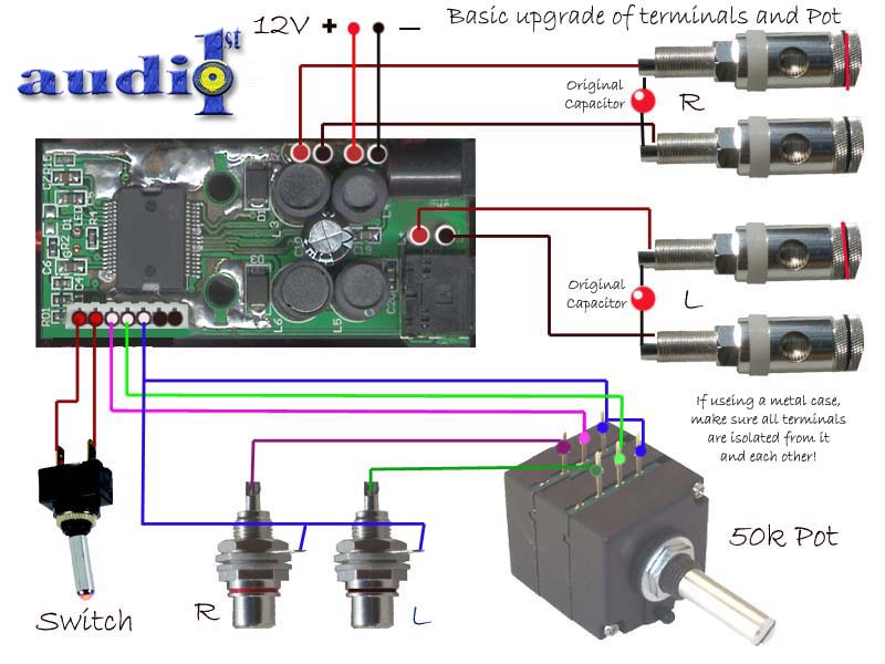

audio1st said:Here is a Sonic T Amp, Bass Mod' dia' if anybody is still in need of it ?.. Done to death I know..

Hello gychang, if you are going to try and use a coldheat solder gun, you will fail. There is no way you can do the on-board mods with that item. You would need a conventional small tip soldering iron at the very least.
I would suggest you leave the board mods alone and perhaps just try a re-box for now.
To insulate the speaker terminals you must make sure that no metal part of the speaker terminals touch the case (only applies if you use a metal case).
You should also leave all wires connected to the board and just connect to the end of them.
Sorry to be so negative but it is better to have a working basic amp than no amp...Barry
