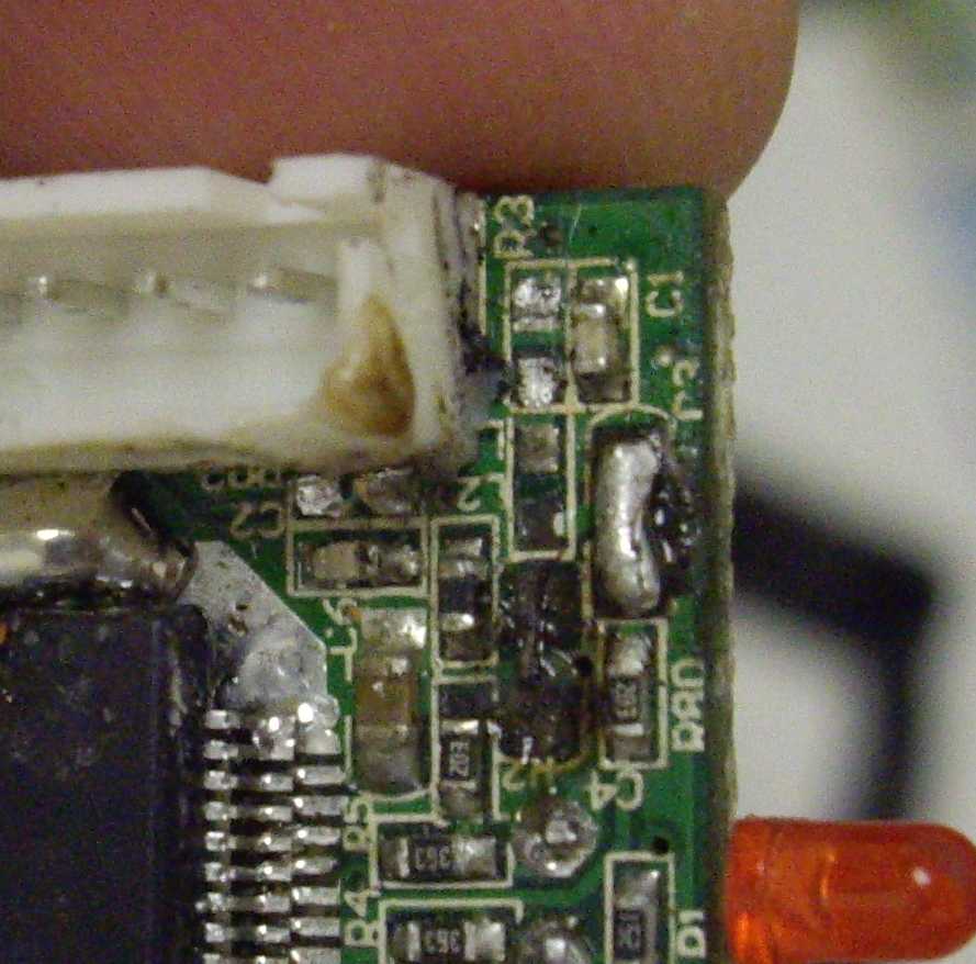

Wow, that's ugly.
Start by cleaning off all that flux and burned junk with rubbing alcohol.
Most of the time when you burn a pad you can scrape back the mask very carefully with an X-Acto knife to reveal shiny copper on the trace(s) leading to it. Using a single strand of some multi-strand wire, you can theoretically bridge any burnt places. Tape the wire in place, hit with flux, and with a TINY dab of solder on the tip of the iron, hit it for no more than a second. This should do it. Repeat on other end.
You say you knocked off a component. Do you think it's in good enough shape to work if you can get is reconnected? What is it? I don't have that model or a photo handy.
OK, I have to say this: next time, try a soldering iron instead of a blowtorch. Seriously, those things are tiny and need very little heat if you have a sharp iron tip. Getting good magnification and bright light is half the battle. I have found a flux pen helpful as it makes the solder flow quicker. And don't do what I did and try to use silver solder, as it melts at a high temperature and doesn't flow and stick as well as the lead/tin eutectic.

Thanks for the reply and advice!
Yes it is ugly, my 15 W iron stopped working in the middle of the project and so I switched to my 30 W iron with the results here and I was using silver solder... So out to get a flux pen and lead solder. Hopefully my third RS 15 W iron will keep working for a while longer.
Actually, I snapped the component in half so it is no longer usable but I have looked at another one of these boards and it appears neither to be a resistor nor a capacitor. On the board it was marked L1 and it looks identical to the piece to the left of C4 in the photo, that is marked L2. These are boards from Sonic Impact amps, the last version of the first generation I suppose you could call them.
Can one actually attach SMCs???? Wow these things are so tiny, I can't imagine that is done with a conventional soldering iron....

L2 would be an inductor, and should be no problem taking it off another board if you can manage.
What you really need is a temperature-controlled soldering station with interchangeable tips. for the surface mount stuff, you need a point that's fine enough to kind of lay right down in the angle between the end of the part and the board. If your RS iron has a pencil-pointy tip, you should be able to work with it for now.
Look around the web; there are several good tutorials if you search "surface mount soldering tutorial."
You too can solder small parts. Using the stuff from my previous post plus a sharp pair of tweezers, here's how I do it--and I'm far from being an expert. Dab some fluxon the board where'e you're soldering. Get the iron hot, and add a teensy dab of solder to the tip, and place a tiny spot of solder on the pad(s) where your part will go. Now, hold the part in the middle and place it in position, then just touch the iron to that corner formed by the end of the part and the pad and the solder should flow and make contact with the part. Don't hold it for more than a second or possibly two, and don't worry if it's not a very good joint or if the other end is sticking up a bit as long as it's sticking. Then take the tweezers and while pressing gently on the top of the part, repeat at the other end, perhaps with a tiny bit of solder on the iron tip, which should make for a nice joint. Then, go back and add a bit of solder if needed and reflow the first end for a good joint.
The most important thing is not to spend too much time on any one joint. If you're doing things right, you won't have to. Once the plastic and resins start to cook, the board becomes hard to deal with, as you found out.

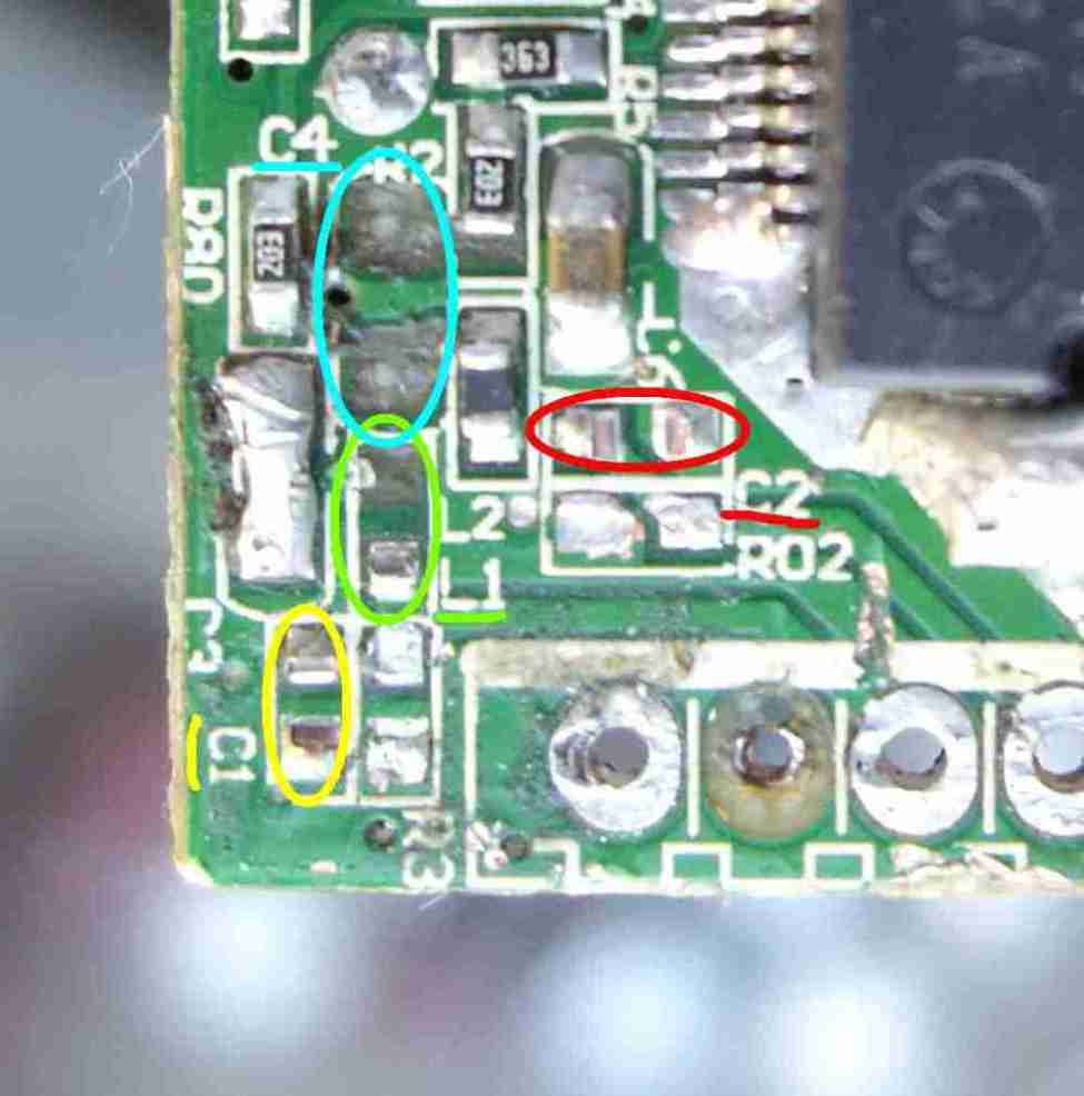

help with burned t amp board - the demolition derby continues!!!
Well - I think I just blew the chip on the better of my two t amps when I caused a spark while testing the DC Jack of my new project - so:
I will need to transfer the following SM parts from the destroyed board to the semi-destroyed board:
MIA:
L1
And the new MIA pieces due to dropping of the board, an aggressive 3rd hand tool which kept on slipping and the attack on the white plastic plug :
C1
C2

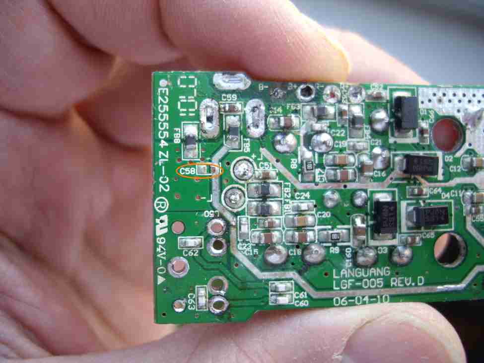

And on the bottom of the PCB:
C58
Questions:
- Will the spark that presumably knocked out my chip have effected the SM parts that I would like to transfer to the other board?
- Do the parts that need to be transferred: L1, C1, C2 and C58 need to be mounted with attention to polarity? If so, how?
- Is there a way of testing my chip to see if it has been destroyed? I did plug in and power up the project:
- The On/Off switch worked
- The new power supply Cap did receive power
- The Pot went from 0 - 50K on both channels
- The Speaker wires were fine from the Binding Posts to the PCB.
- The RCA inputs and connections were fine too.
- No sound
- No lit LED
- The original mini-jack input and DC jack were removed from the board but I wouldn't think that was causing the problem...
Ideas?
- Also fragments of MIA pieces on the still on the pads (visible in the photos) shouldn't cause problems with the pieces to be mounted over if I blob them first, right?
- I am using an diode on the DC input to stop problems with battery polarity knocking out the chip while playing the amp outside, (it didn't help on my work area though ) - that shouldn't have caused any problems, right?
Thanks in advance!!!!
Steve

Questions:

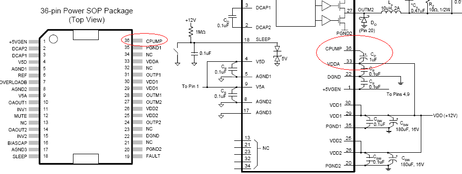

Hi Steve, it's been a while since I played with one of these and I haven't had one of the MKII Sonic boards but...
If you have continuity from your power to the on-board cap and the LED is not lighting up then it does sound that a reversed polarity has knocked out the chip I'm afraid. Audio 1st's post shows the fuses that could have gone on the speakers... worth checking.
However.... there is one posibility which has happened to me in the past.
Check the cap that supplies pin 36 (CPUMP). If that has blown (continuity across it) then it just needs replacing.
Good luck

Hi Steve, yeah, Pano may be right, I've never had one of these boards so I can't check.....
Anyway, the picture is from the black resin side and you can see the dot in the top left corner.
Trace pin 36 until it meets a small cap and then test that for continuity.
EDIT:
OK just looked closer.. it's C9 right next to the pin.
Other than that it's not looking too good I'm afraid
