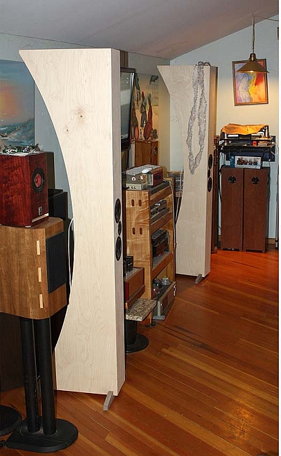

Re the Abby - if you're referring to the late Terry Cain and Lovecraft Designs product, I've heard those with both FE166E and FF165s - great sounding rig. IINM, at one point Scott had penned similar looking designs that might still be calculable for the 10Ps, but I'll note that they also had a tilted front baffle, and indeed are much taller and imposing than either of the Frugelhorns.
Funny you should comment on the tilt - an earlier version of the FH was built without that, and the new, simpler design folding along with the curved mouth rear serendipitously allowed for the aesthetic achieved with the 5dg angled front - but as they say, beauty is in the eye ...
The stacked twin FH shown here outfitted as an MTM certainly shows that a vertical front is possible, but to my thinking it's not as elegant.
Indeed there were -- the Festival series. Only one set, AFAIK, were ever built. An A10p version is doable (if i can speak for Scott). Driver can be put on vertical or sloped side -- or (maybe) on the side.

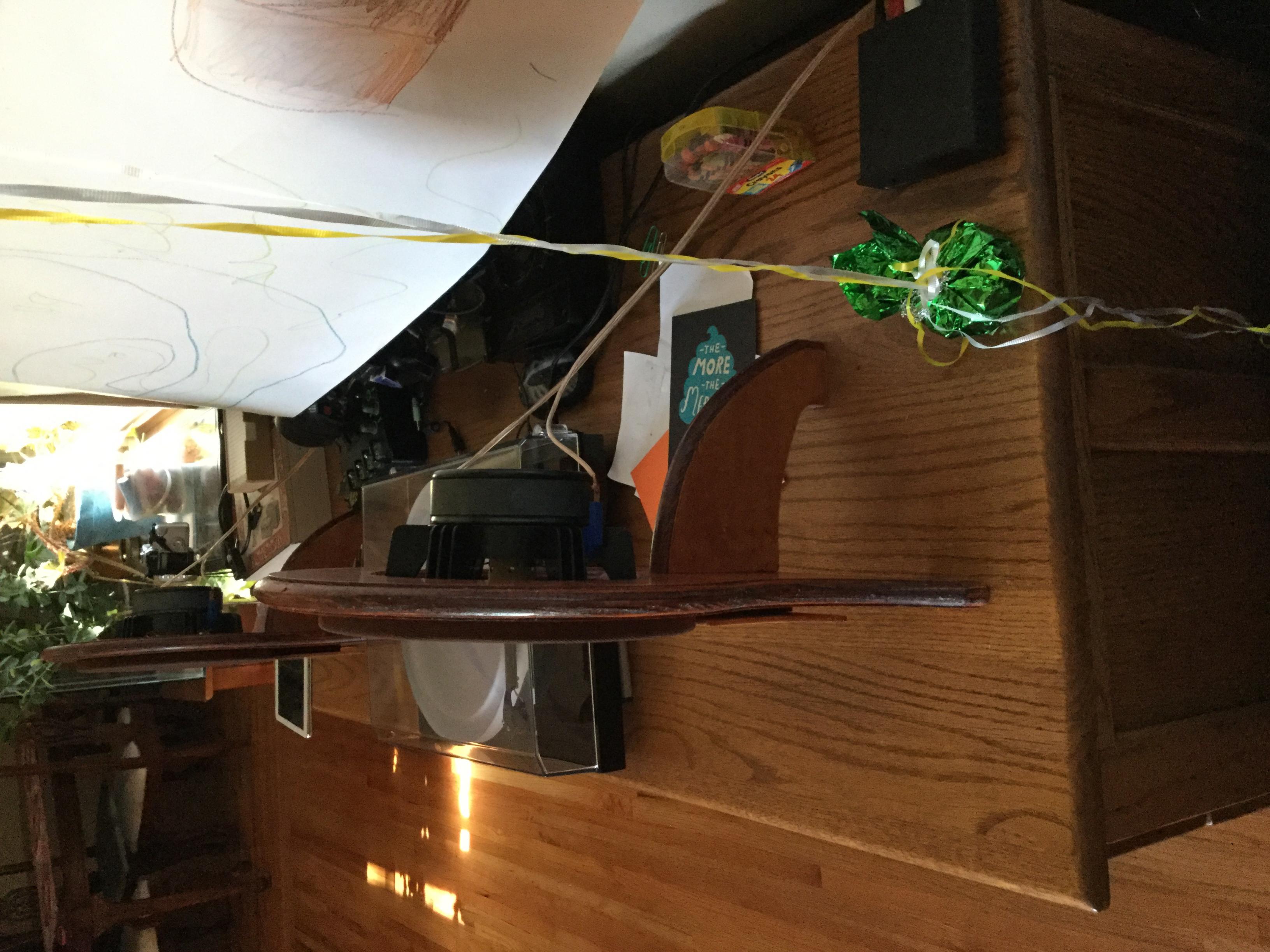

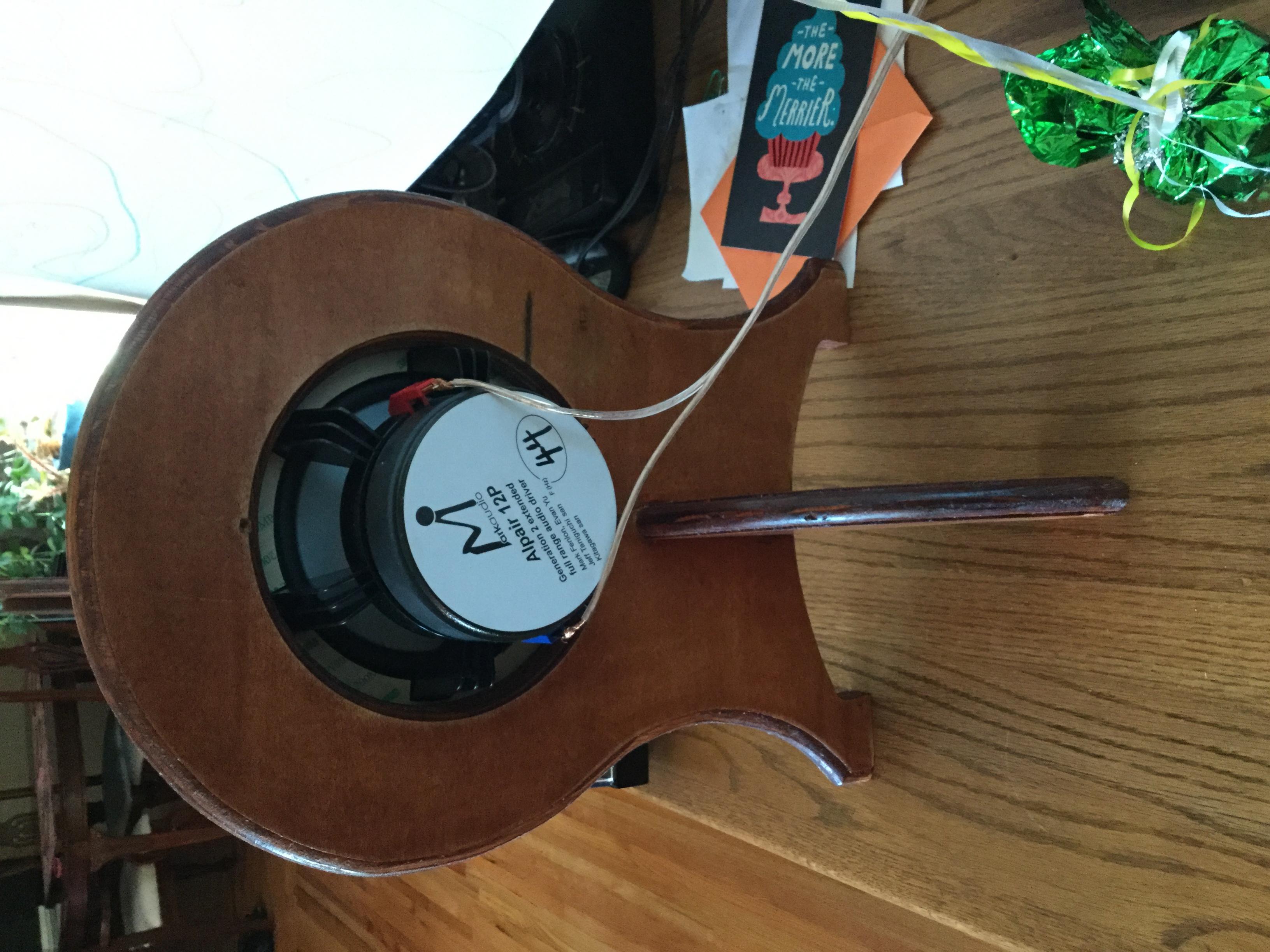

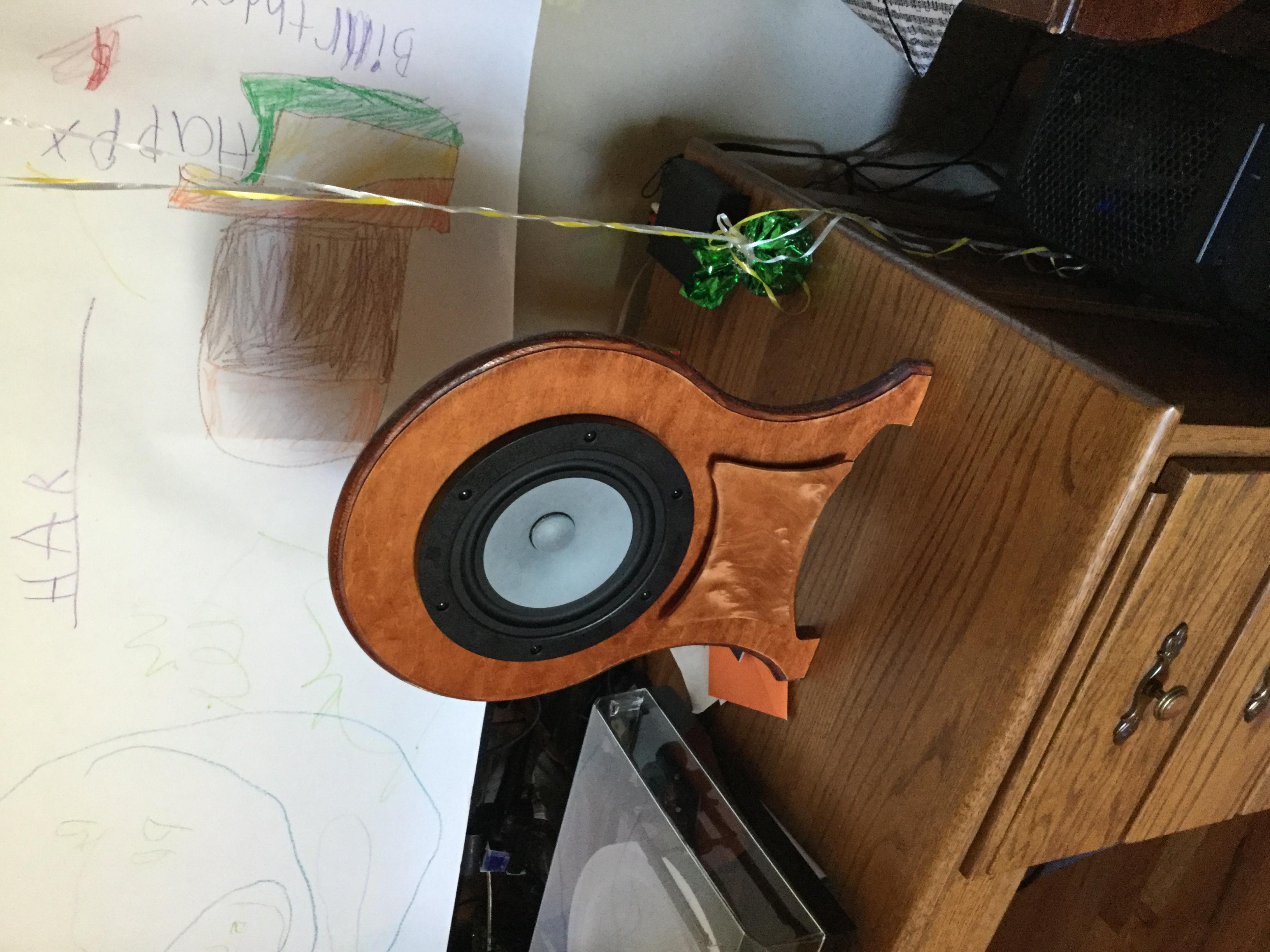

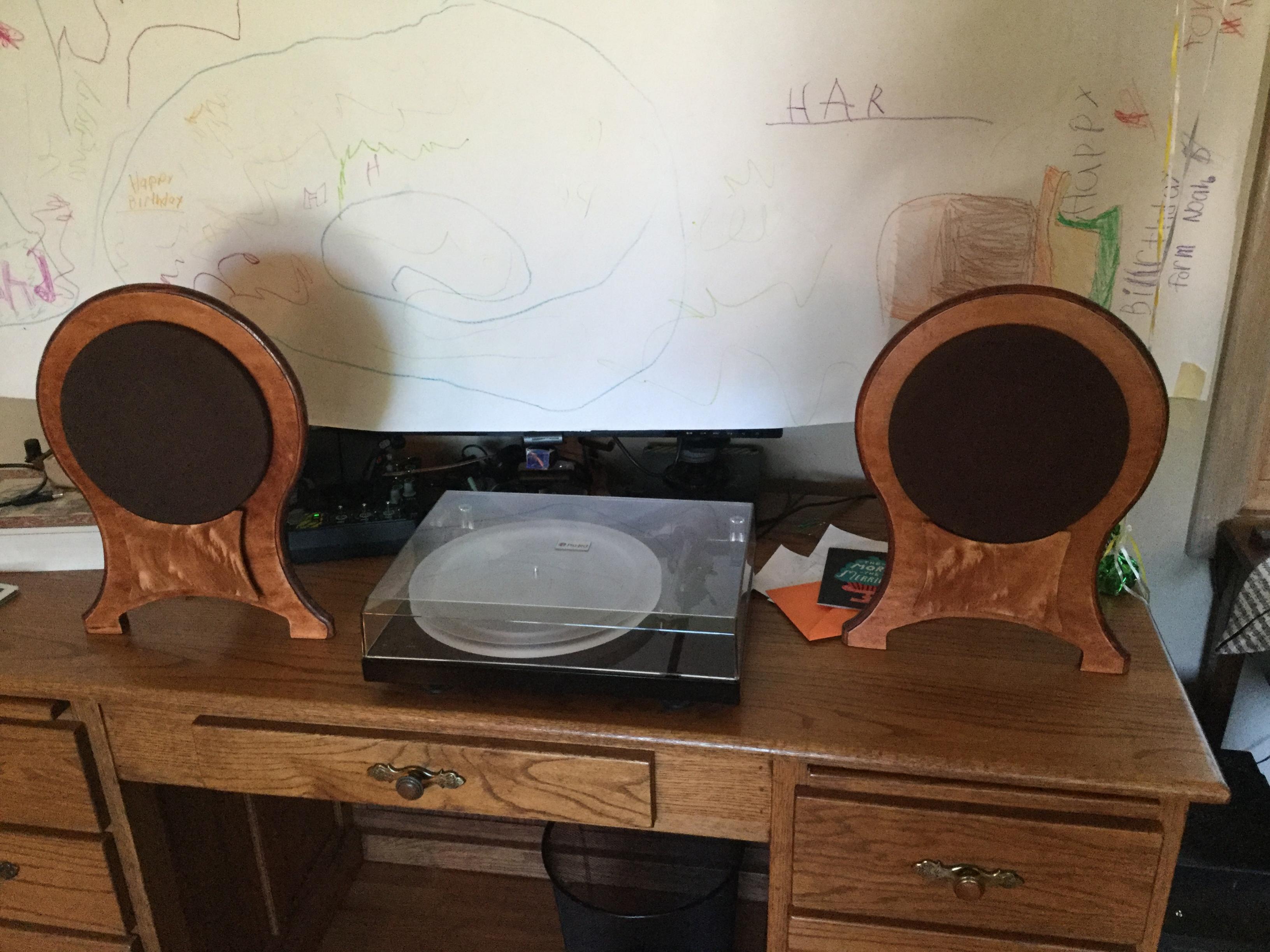

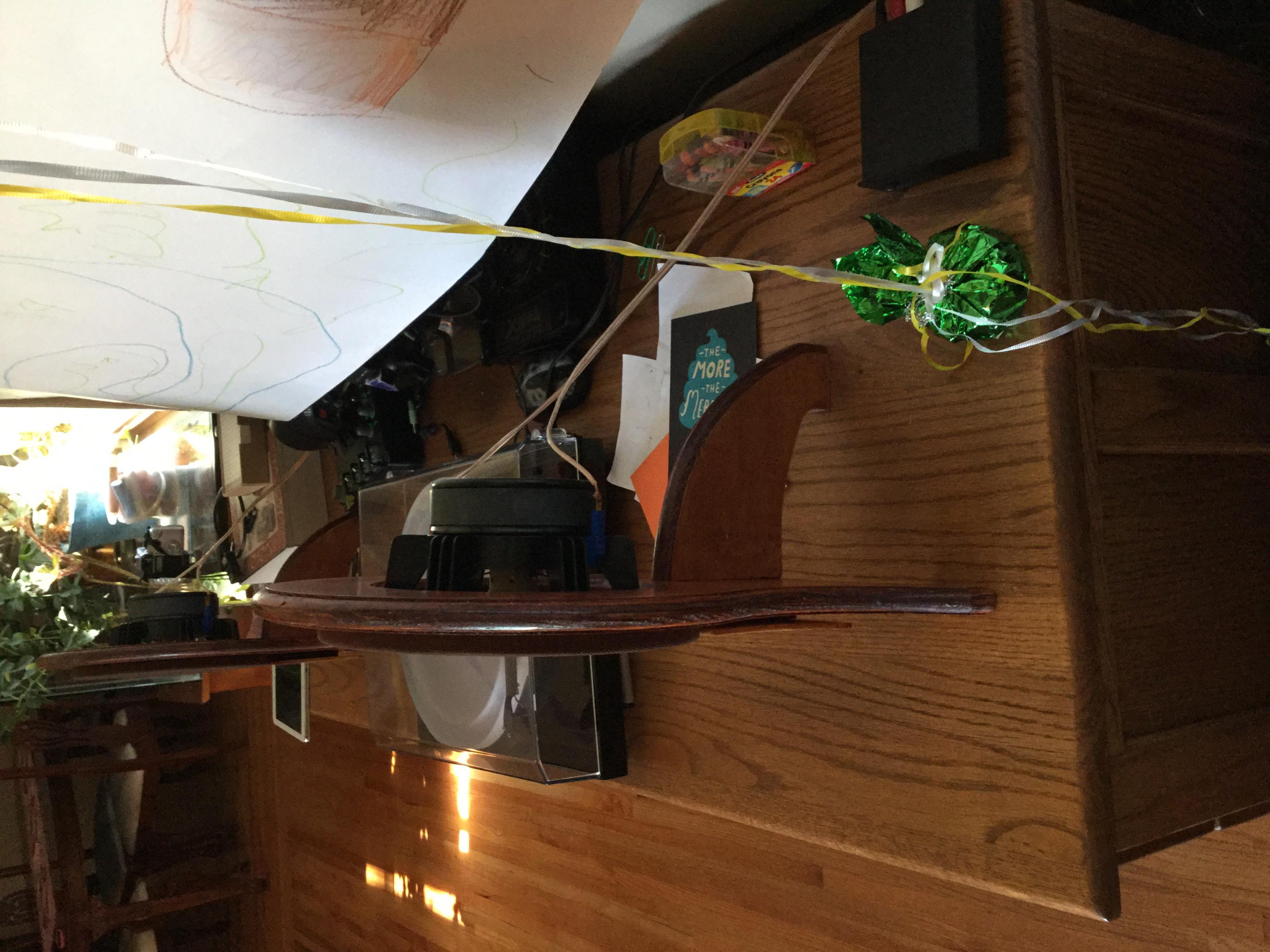

Update: 2 years later and I finally pulled the trigger on drivers. I ended up getting a pair of Alpair 12p's. What started out as a birthday present for the wife (turntable) went a little overboard, but she loves it! I got her a Pro-Ject Debut Esprit SB, Pro-Ject phono box s pre-amp. Then realized we didn't have speakers that could go where she wants to listen. So..... I grabbed the Alpairs. It was fun trying to find a place to break them in without her seeing/hearing them
I decided on a simple open baffle design (which turned into a fairly elaborate decorative piece) because I knew I would stew far to long on which cabinet to build and couldn't find current plans on Madisound for the 12p (they had plenty for the 10s). So, this build is experimental and a semi-long term temporary solution. Eventually I'd like to build an old style phonograph cabinet with everything built in: speakers, amp, record player, etc. I had just over 1 week from start to finish for this project.
For now I'm using an old circa mid-late 90s Pioneer 5.1 a/v receiver, but will probably upgrade to a better stereo set that includes blu-tooth (for convenience and WAF). Initial sound impressions of the setup are: fantastic sound stage. They sound great regardless of where you are in the room (they even sound great when in the next room). Bass is extremely weak--which is saying a lot from me since I hate the typical audio set up of overpowered bass subs etc. Once I added an old jamo sub I had, it fills things out nicely. I get good sound from everything I throw at it, symphonic classical, jazz, classic rock, alternative rock, acoustic--even sources: various vinyl eras, phone/tablet playing mp3s, FLAC, or WAV. (My reference speakers are Altec Lansing 605b and sennheiser momentum 2 over ear headphones, + I'm a full time professional classical musician).
I'd appreciate recomendations on sub drivers or woofers that would be a good match for these speakers since I stole the jamo sub from my theater room.
Finally, thanks for all the help you guys gave 2 years ago.

Cute. Glad you like them.
Some comments.
1/ no bass because of the vestigial baffle. All the bass is cancelling out
2/ no rebate for the driver
3/ the backside is not flared out causing colourations from the reflections (rebating the driver may be sufficient to have the back clear enuff that it may no longer be an issue -- using 18mm baffles the rebate is sufficient for the A10)

They look nice... But the sound can be immensely improved if you had not mounted them in a round baffle which is the worst possible shape to mount a speaker in if you don't want peaks and dips to color your music. The equidistant nature of a round baffle causes 6dB to 10dB ripples in the response (if you were to measure it). Change the shape to a rectangle or a trapezoid and it will sound much smoother and more balanced.
Diffraction from baffle edges
You don't have any bass because the baffle is so small, anything below maybe 600Hz will cancel itself so what you effectively have is a mid tweeter. Open baffle looks easy but takes study to get it to sound good.

OK on the champhered backside -- didn't look like it when i viewed the picture.
On an OB how low you can go depends on how big the baffle is. Yours is not much more than enuff to mount the driver on, hence vestigial. XRK's estimate of 600 Hz is probably close, then yo have to add the natural roll-off an octave or so lower.

What you are getting is completely expected.

How low do you want to go? Can you add EQ?
A baffle with no EQ would probably need to be measured in meters, with EQ you limit the loudness available because you start eating up excursion.
We got amazing bass with a high Q specially made open baffle driver of similar size in a 17 x 4' baffle. The A12 is not high Q, so the best you can get without EQ is the infinite baffle response. Data sheet suggest F10>75 Hz.
