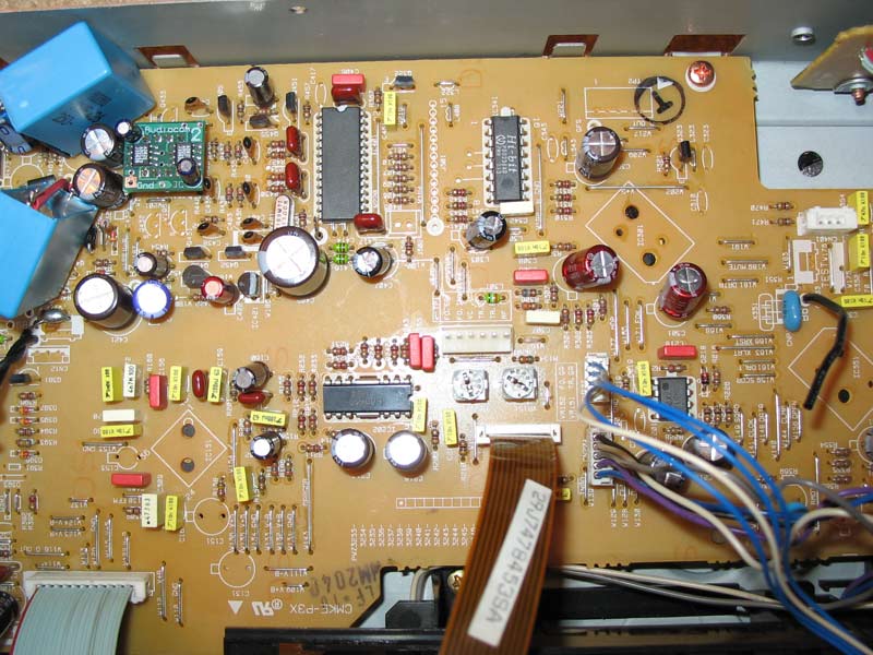

Capacitor change list
Here is my planned cap change list:

I have currently changed all the ceramics on board, except the ones that are to be changed with micas. I relay did not expect some great improvement, but it turned as audible as much as the OpAmp change! I'm still waiting for diodes, elcos, clock parts... Here is the pic:

Hi everybody,
Here is the short report on the current status of my moding effort.
I have changed the diodes with 11DQ10 (thanks Zanash!), installed all the caps (finally) as listed in my cap change list, and I am currently busy finishing and implementing the Kwak-Clock. In one of the pics you can see I have also filled some gaps but not so tidily as Ryssen.
I am so pleased with the sound improvement (even without the clock yet) that I think I’m going to change the course of my initial plan of making it mostly a good transport for external DAC. I’m seriously considering of introducing the extra supply with the super regulator for the analog out, as the further improvement.
