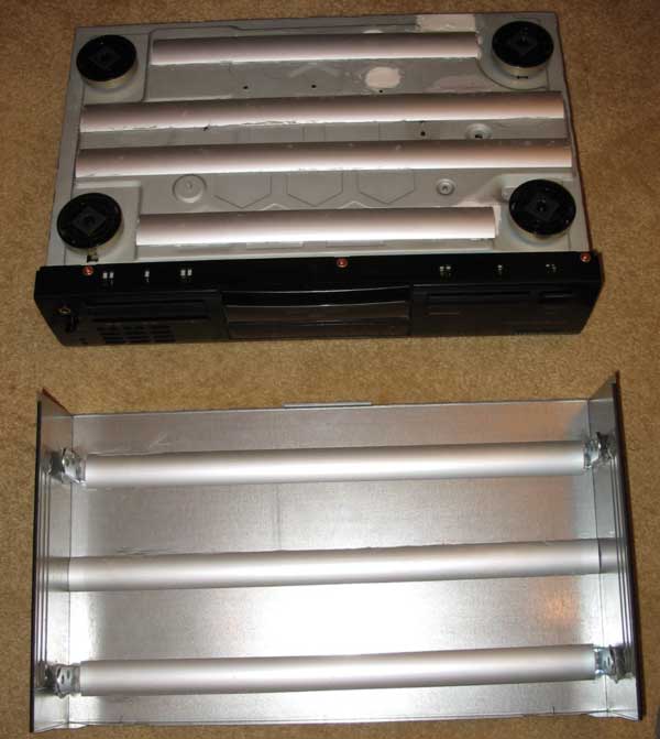

I finished the case for now. I glued aluminum profiles with some special bitumen glue/sealant. When I tap it now it is just thump instead of previous ringing.

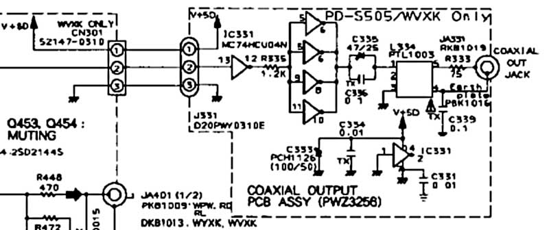

Also I wonder if I could easily build the digital coax out considering that some models on the scheme seem to have it? I know there are a lot of threads on this theme but I couldn't find the answer. See the part of scheme on attachment:

Hi Guido,
There are no tests that were done to compare the EAM clocks with your Tentlab clocks.
The EAM clocks use super regulators and in terms of noise performance, they will be quieter than a shunt-based regulator clock.
Furthermore, the super regulators are built using SMTs with shorter traces - less prone to pick up noises.
Although James Soh of EAM and I don't see eye-to-eye on some issues, I believe that the EAM Clock 2 has a very good implementation and it is proudly made in Singapore (except for the XO module). I have to be objective in my comments.
