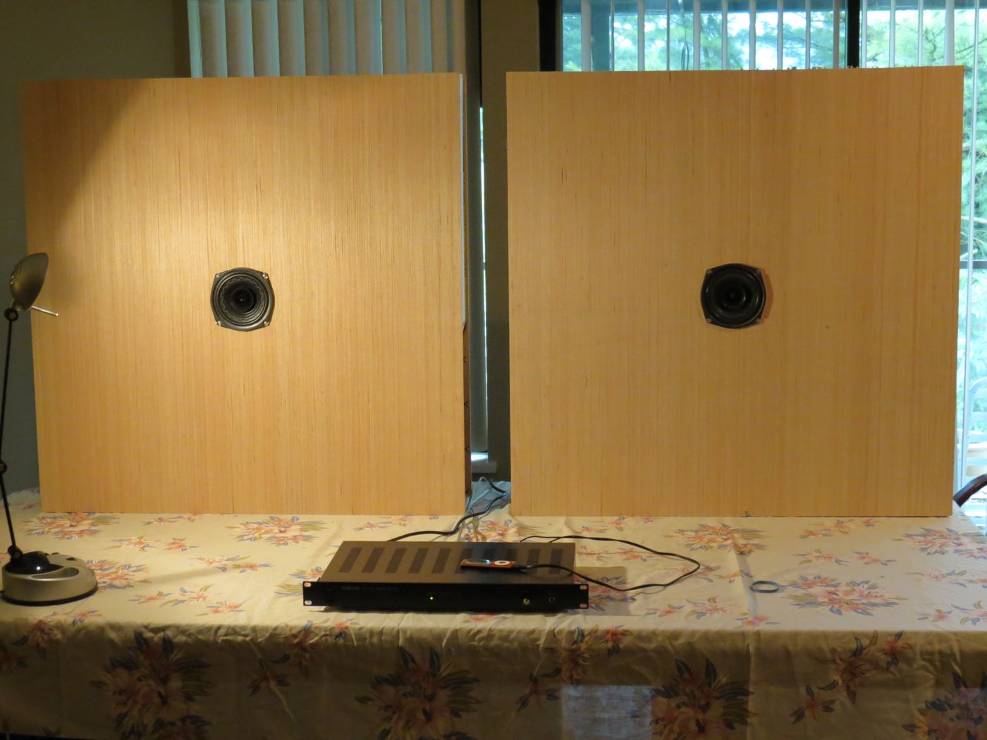

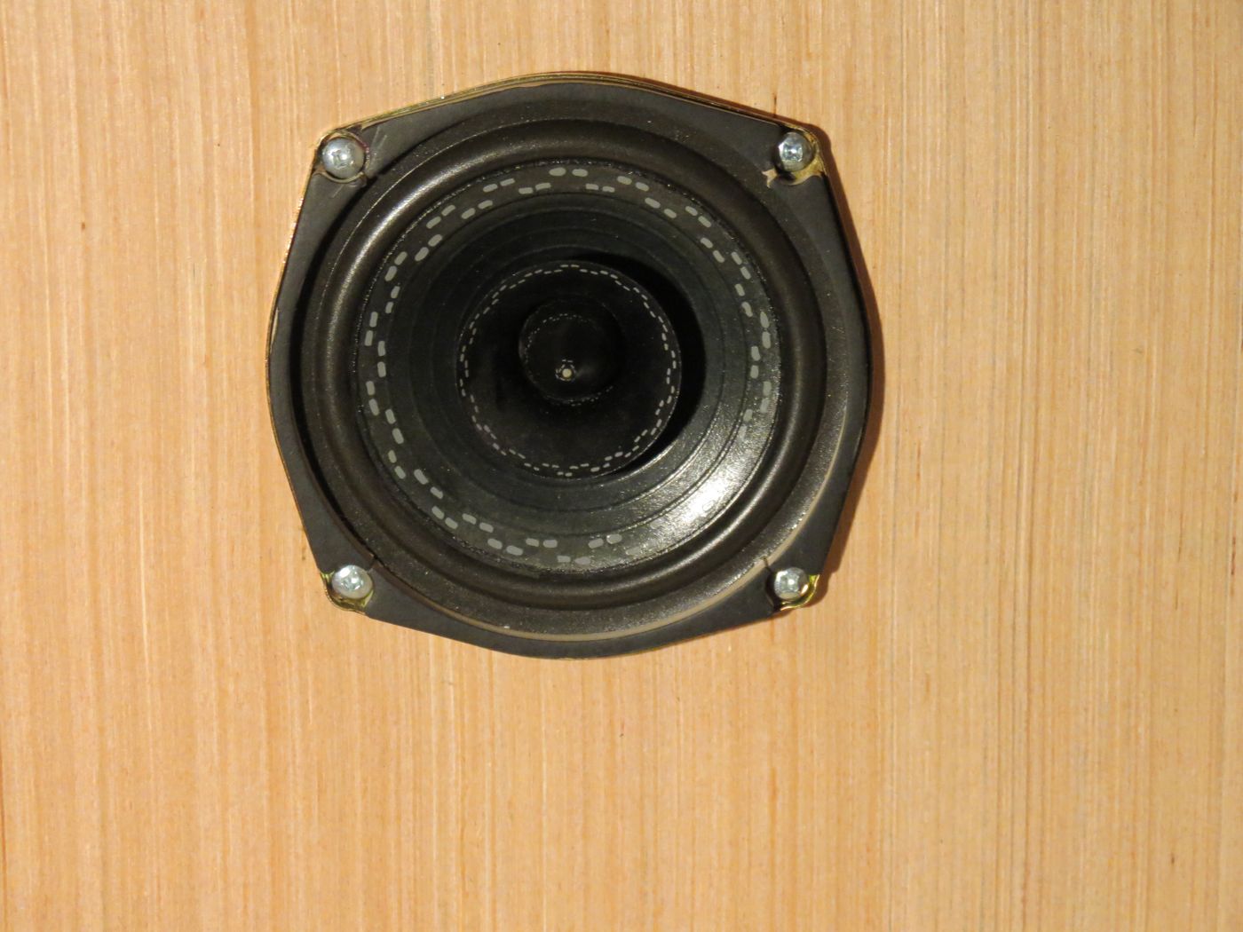

Hey Anton, I got bored waiting for you to come to your senses so I made you a pair. RS 40-1354A drivers, 36" Cornu. I still have to put the finish on them but you can pick them up the end of the week.
Awesome Too bad it would cost me 10 the component cost to come to get them...Hey Anton, I got bored waiting for you to come to your senses so I made you a pair. RS 40-1354A drivers, 36" Cornu. I still have to put the finish on them but you can pick them up the end of the week.

I'll send my private jet to pick you up.Awesome Too bad it would cost me 10 the component cost to come to get them...
I'm not the expert but I would imagine 70-80cm and a channel depth of around 10-15cmWhat dimensions are recommended for the CHR-70? I have a pair of them.
Get in line Navin.Cal how about the rest of us?
Actually, you will want to make them yourself. Because of the speed of the build, the reward is quicker.
