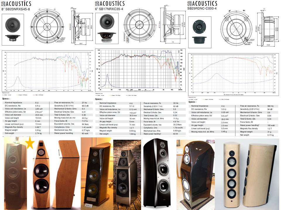

The best contender so far is the Faital Pro 6FE100:
Cheap, linear to 3 kHz (except dip around 350 Hz), easy to rear mount, 91 dB. And it is used in the Fusion-6 at diysoundgroup.com and they seem to know what they are doing. The rendering above actually uses the dimensions of the 6FE100.
Other possible candidates: SB acoustics SB17MFC (oddly beefy surround) and Dayton Audio RS180 and RS180P (more expensive than 6FE100, less discrete).

3. I like the SEAS Prestige L15RLY/P. It looks nice enough for my wife to tolerate it without grills on. If you could stretch your budget to $150 the Satori MW13P could be an option. If you can use a 18cm woofer then The SEAS ER18, U16/U18, LR18 all become viable. I have used the ER18 and LR18 in 2 ways.
