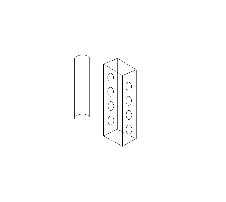

it can be difficult to cut PVC accurately, and get good fit, etc...I would consider constructing a inner plywood section
and attach the rounded sides to that

Specifically difficult with PVC? There seems to be PP pipes as well if that's better.wise to let your wife decide
An inner plywood section seems difficult. A colleague suggested I should use a smaller pipe for the black part. That could work, if I find one that is the correct size.

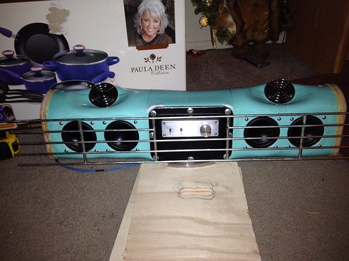

I would think PVC would work out great for a design like this. I've found PVC quite easy to work with. Just have a good pattern, ( with your cad skills that should not be a problem ) and I would think your design would be fairly simple to do. Cuts easy, sands good and can be extremely rigid.
Here's something I've been working on using PVC...
That looks very industrial!
