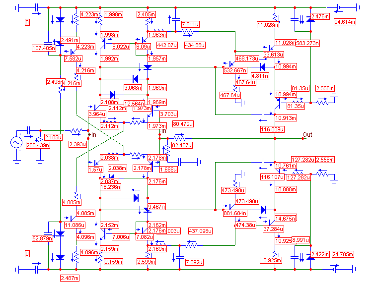

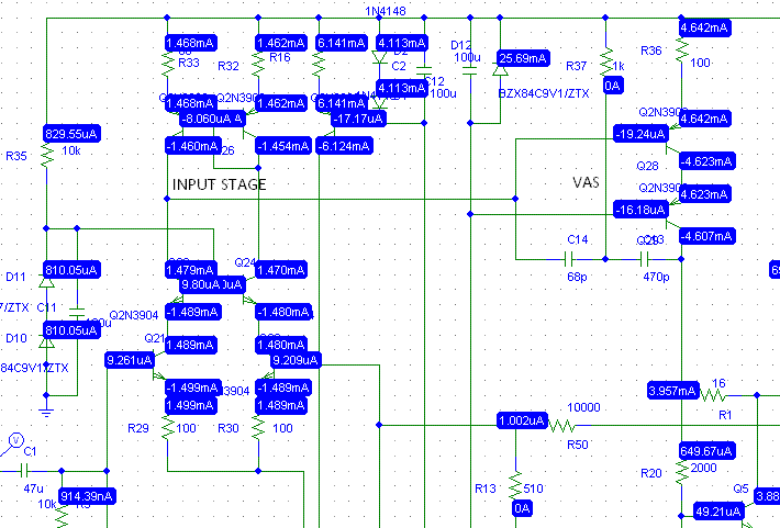

I have done a lot of Spice work on an input stage with the same topology (unfortunately building it has been on hold for a while.) As already discussed the VAS current is undefined, I did the same experiments as you did in simulation with 1% changes in values showing huge changes in VAS current.
The options are 1) ditch the current mirrors or 2) figure out a way to get the VAS current defined. Since the current mirrors have a huge benefit in reducing distortion I tried various approaches to 2). The other threads already mentioned were a huge help in understanding the issue and developing a solution. Two possibilities that I explored in detail:
a) loading each side of the VAS with a current source - I rejected this because of added complexity (the current sources) and because I wanted a differential VAS, somehow separating it and adding the current sources offended my sense of aesthetics.
b) defining the voltage at the base of one side of the VAS. There are various ways to do this, what I settled on was using a resistor divider off the voltage at the base of one of the current sources that loads one side of the input diff pair (in your schematic, Q9) to generate the desired voltage, then connecting it via a 1K resistor to the base of one side of the VAS (Q11.)
Of course this is all in simulation, but with this solution I found that the sensitivity to slight changes in component values was for all practical purposes eliminated, and there was only a slight penalty in added distortion. Another thing to look at in simulation is the power-on behavior as the voltage supplies ramp up.

I looked at BV's solution, still thinking about it.
My solution is really simple - with the input grounded, determine the voltage on the base of Q11. Create a voltage source to match and attach it to the base of Q11 via the largest resistor you can use but still keep the VAS current stable with variations in components. You can see the details here: http://www.diyaudio.com/forums/solid-state/153639-update-aragon-4004-a.html

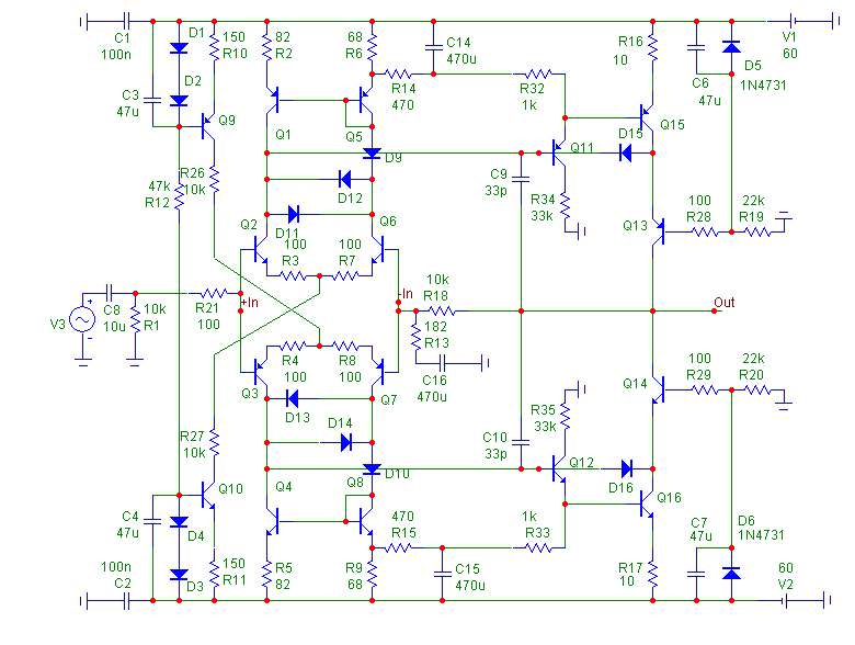

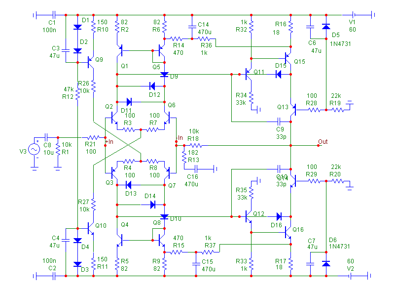

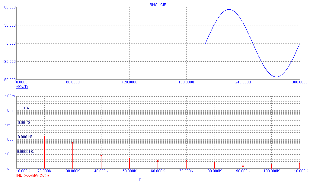

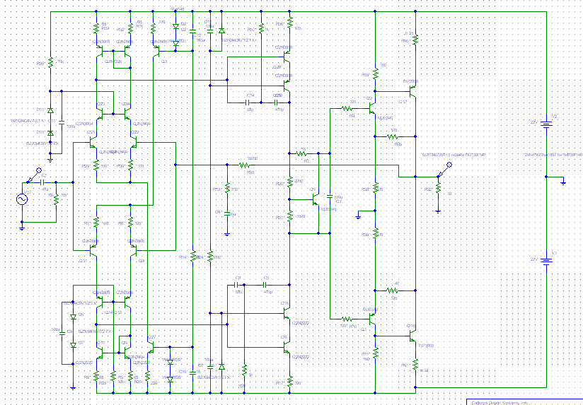

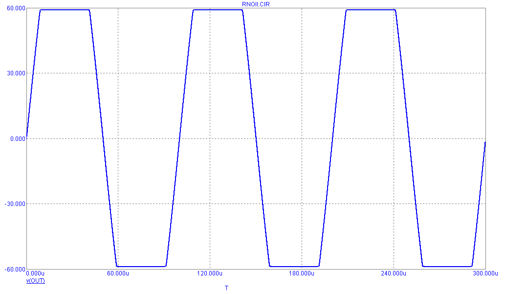

Gentlemen, take this debate as mental exercise, that it is possible to make this schematic(with current mirrors) reliable working with very good results, with some modifications without sticking problem and with fast recovery. It is not cookbook..Schematic and simulation are attached. All diodes 1N4148, NPN-BC546B, PNP-BC556B, VAS output (Q13, Q14) MJE340,
MJE350. Models by NXP and ONsemi. SR is about 100V/us, clean without overshots.
Or convergence issues. I'll try other models.
Thanks anyway.
Edit1: It's working now (I overlooked some stupid error: a short ).
But the VAS standing current is quite sensitive to temperature and component values.
Your previous circuit performs much better!
Edit2: Hey, one more version. You're keeping me quite busy, don't you?
Thanks anyway.

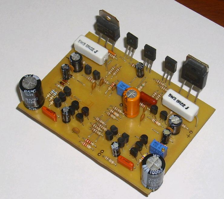

Hi Havenwood,
You didn't tell us if your Slone Amp worked? If yours worked I have big ears to how you managed to stay away from VAS Iq problems. The difference in your circuit is the Cascode in the IS stage. Does that solve the VAS stability problems? I wouldn't see how but I can't find any other difference in the schematic.
Did you tweak a lot with components?
Anyhow tell us something more about it please ...
Hi Bonsai, I take the idea from Randy. Cascode input stage with current mirror (Glen use this en K12A amp too).Why do you need a current mirror load on the front end LTP's in a fully blanced design? Its fairly easy, if you use a resistive load, to adjust this value in simulation so that the current in the two LTP transistors is balanced and distortion is nulled.
Ic is not balance in inputstage without Current Mirror (Douglas page 82), they are partially balance.
Why cascode? I read a little about this in PassLab and in this forum.
Add this cost a few cents...
Sound better? I can´t say nothing, my first amplifier was P3A and then SiliconChip 20W. I compare the amplifiers, symmetrical and SC, sound different, but better? I don´t know. I don´t have a reference.
Just when I read (pass) goods feature about casode, I use this. I can´t measure anything.

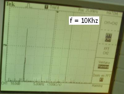

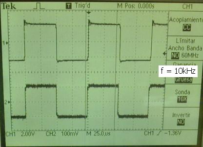

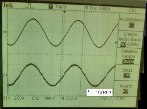

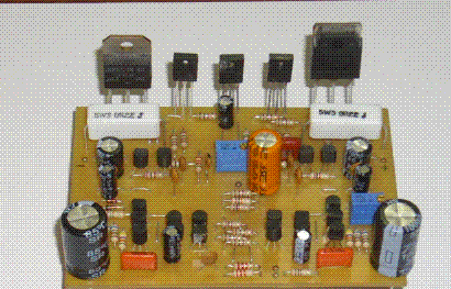

The Amp works fine, very good sound.
Working in Class AB, offset <10mV
=> Some pictures.
Channel 2 (input) from oscilloscope have noise, becouse the ground cable is break, only probe1 have ground (look channel 2, sine + noise or square + noise)
Sorry for my English
Hi!Hi Havenwood,
I have no problems with Iq, use Re = 100ohm, and cascode VAS set the transistroe operation point.
Need 2 adjust, Iq and Voffset (no DC servo)
I attach a zip file, with amplifier simulation (PSPice)
