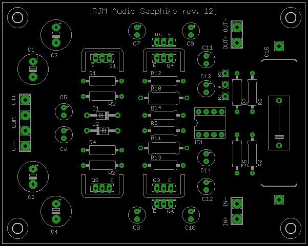

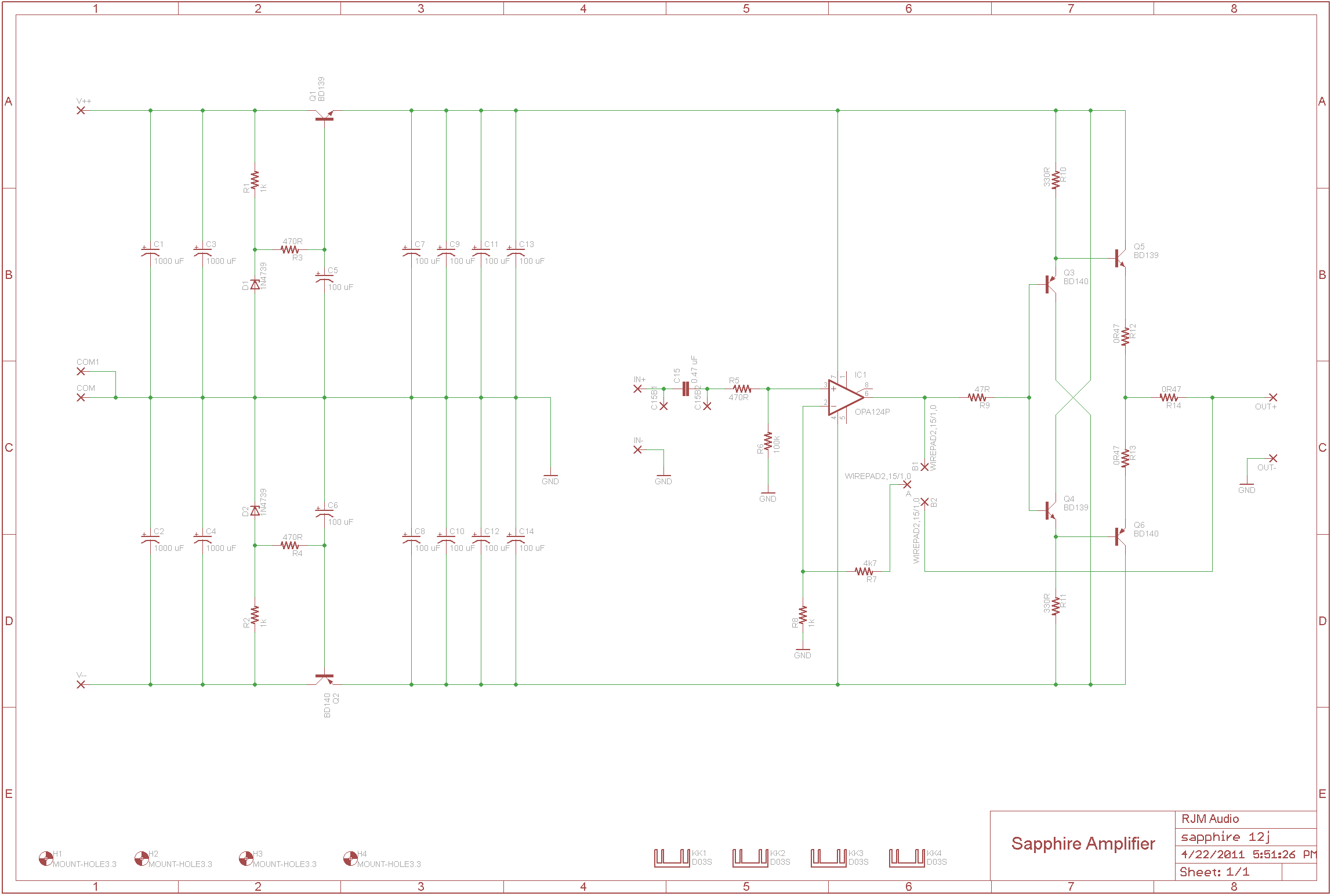

Sapphire board version 12j, eagle files.
I'me wondering what to do about the jumper. Does anyone know a standard part no. for a 3 pin jumper like the ones typically found on computer motherboards?

you mean a molex connector? They have the part numbers listed in eagle...

Try a switch. It might work fine, it might have minor stability issues due to lead inductance inside the feedback loop - give it a shot because it would be fun to have the ability to switch on the fly. Maybe later once you know which you want you can remove the switch and solder a permanent jumper.

Not a molex, the smaller square pin header used for, eg, the USB headers on motherboards. By the way the circuit is current rather than voltage limited, so increasing the power supply voltage wont do much...

I've been messing around with my soundcard hooked up to the Sapphire, generating some benchmarks with Rightmark.
I'm afraid it'd not going to tell you anything we didn't know already: there's basically nothing to measure. No significant noise, distortion, or deviation in frequency response compared to the soundcard by itself.
I'm a proponent of using measurements to find and diagnose problems. I'm not much for using measurements to evaluate sound quality. That's what ears are for. The measurements are clean, the Sapphire amp works as designed. The rest is in the realm of subjective opinion.

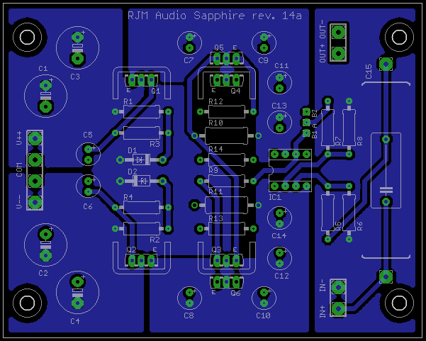

Latest board revision 14a
- feedback loop adjust pads made in-line, with 0.1 pitch, should fit standard part pin strip headers 3M 2300, 929 series.
- all other wirepads are made standard 0.2" spacing to fit standard screw terminals if desired.
- hole spacing for board standoffs changed to match 3.5"x2.5" of current Phonoclone 3 and VSPS300 boards.
- use "restrict" layer to prevent unwanted polygon flow, rather than making strange polygon shapes to avoid the area. (same result, but better design practice)
Relevant files updated at the web page.

Finally finished my sapphire. I had planned to fit a LDR volume control but there wasnt enough space in the box. Ended up using a cheap 25k pot from Jaycar for now. I need to get 4 new matched LDR's to work on a smaller board.
I did try a switch for buffer in/out. I used wire from a USB mouse and a small switch. On B1 I had hum and B2 loud oscillation. Removed the switch and found a problem with one channel. Turned out that one of the legs of Q2 wasn't soldered properly.
Still running it in with earbud phones and it does sound promising.
Hope to get a better pot or LDR volume sometime soon. I'm using my phonoclone3 power supply - 80 va tx +2 rectifiers. I plan to run a second cable out of the box instead of building another. Would that be OK Richard?
I never did try that. From a power point of view there's no problem, but check by running the wires out the open case before drilling any new holes, just to be sure there isn't any increased hum as a result of a group loop introduced by the shared power supply.

If you measure the voltage across R12, R13 , the current V/R is the current though the output devices Q5 Q6. I'd appreciate it if you could report that number to me.
Your listening experience is basically the same as mine: the Sapphire's dominant trait is resolution. Everything is clearly presented. A lousy recording, or any fault in the upstream components is made evident, just at it reveals the intricacies and beauty of well recorded music.
It also has tremendous reserves of clean power. You can really crank it (with 200 ohm headphones at least) and there is no confusion or weakening of the soundstage.
Anyhow, I'm not 100% satisfied: the circuit should work with the buffer inside the feedback loop, and the fact that it doesn't seem to implies something isn't working the way I think it works. Then there is the lower-then-designed-for output current, due to thermal issues.
